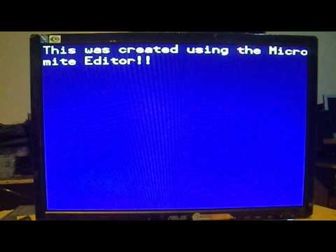

    Here's a couple videos... I'm using a Propeller and Micromite with Sphinx as the compiler. (Most of the Propeller developement stuff is in video 2)
    edited 2014-08-04 12:32
    I think the problem is that "self hosted" in this context means the development environment running directly on the Propeller not on another chip even if it is only $4.
    edited 2014-08-04 12:39
    Yeah, I know.. It's a cheat, albiet, an inexpensive cheat..

    Sphinx supports many features of Spin and PASM, but it does have some limitations. Michael Park integrated the Sphinx compiler with keyboard, display and SD file drivers that executed directly within several cogs. This freed up hub RAM for the compiler. However, the 32K hub RAM does limit the number of symbols that can be defined. There are also some features of the Spin language that the sphinx compiler doesn't support to save memory.
    I've recently ported the Sphinx compiler to spinix, where I substituted the keyboard, display and SD drivers with modified FullDuplexSerial and FSRW objects. This uses up some of the hub RAM, but it still allows for compiling medium size objects.
    The Sphinx compiler is broken up into three components -- lex, codegen and link. The three component parse the source code, generate object files and then link multiple object files into an executable binary file.
    I've also written a Spin compiler called spinit. It compiles Spin code to Spasm code, which is a Spin assembly language. This is assemble with a utility called spasm, that generates object files. I then link the objects with a utility called splink.
    The sphinx compiler runs much faster than spinit/spasm because it uses a dedicated cog engine to do list searches. I may incorporate that into spinit and spasm at some point to speed them up.
