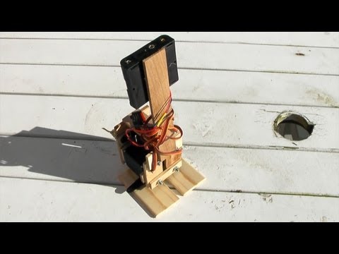

I have one of the old Stambugs made by Milford Instruments in the early 1990s. I still have everything, including software and programming cable and the robot still works though it is walking backwards instead of forwards. I tried to use the old software but it will not work on my Window 7 64 bit machine even in Windows 98 compatibility mode. I tried the current IDE but it says it no longer communicates with the Basic Stamp ver 0. Does anybody have an idea how I might talk to this board. The Basic Stamp circuitry is built into the board so I can't just replace it and I would like to keep it as is if I could.

    Looking at your photos, it is most likely a BS1 because there is a 3-pin programming header (next to the <<<) and the 18-pin DIP chip is the OEM BS1. If you have the source code, you might be able to replace the chip with a current BS1 OEM chip and then the editor should work. You'll also need a BS1 serial programming adapter.

    I have tried that. I have the adapter and the BS1 adapter. The IDE gives me the message that it no longer supports the "BS0". The old DOS setup I am using right now works fine. I want to adjust the walk a little and then I will post a video of it.

    Please use the DOS software to get the firmware version. If it is not V1.4 this could be why this is happening. If that is the case a simple solution would be the replace the DIP interpreter chip with a new one.

    Carol, that's the second revision of the StampBug (BS1 chipset). The first version was made with brass tubes and was very difficult to build. Tubes had to be cut, filed round, and soldered together. Here's a picture of the first generation:
