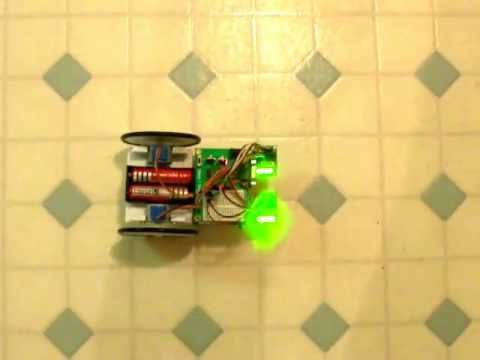

These things are just crying out to be used in a small differential drive robot platform. I'll get to it eventually, but surely someone without beautiful twin baby girls will beat me to it! Don't let me be first here...
Erco, you finally wore me down. I just bought two stepper motors for $5.02. I shall see how much torque they have and if they can be used for anything.
I can die happy now, Martin_H! Didja get a cheapie ultrasonic sensor too?
I've always stayed clear of steppers, cuz they're a pain and need so many I/O lines to control them. But it's a challenge and it should go straight without encoders. Plus, I have this BS2 from a Mystery Bag that yearns to control a robot... 8 lines for two motors leaves 8 free lines for sensors. Not too bad. I'll probably make it processor-swappable.
You previously convinced me to buy four of those and haven't used them all up yet!
I have a plan for a cheap robot that involves hobby plywood, one ultrasonic sensor, two stepper motors, and a microcontroller. I've got plenty of the later to chose from as I have one unused Prop proto board, a BS2 from the mystery bad, and one that shall not be named.

Step_Jump....... i could not resist either and just bought two for $6.44 inc p&p... these motors kick a far punch and are able to drive my "Etch-A-Sketch" board project (still in progress) without battering an eyelid.
Just experimenting with the different modes of driving...... the LEDs are 'brill' for debugging .....YAY
XLNT call on the Etch a Sketch, I must appropriate the twins' unit for evaluation! These steppers def have plenty of torque at low RPM, as my quickie BS1 robot shows:
This $1.50 encoder (a rotary knob) would be da bomb for manually driving a stepper. The stepper would rotate proportionally to the knob, and you could change the ratio in software, sort of a virtual gearbox. I'll do it unless Duane beats me to it!
Lovin' it! Great job with the gear drive, I was thinking direct drive with no encoders, but you're way ahead of me. You're almost done, I want to see yours in action, Boss!

BTW :- i bought another 4 steppers :-) i could not resist ..... i have found out that the pin headers will plug straight into my RBBB propeller board ie the board forms a chassis and with wheels attached makes for a quick robot.

Or maybe a new mod to your rover...... Here is something i tested this evening.......
I cooked up a chassis with 2 steppers back to back - a pingpong ball and a UV Led strapped under the axle.
Software simple drives and draws a box with 89.9(ish) degree corners onto a sheet of UV sensitive vinyl.
I am gobsmacked how well they are tracking :-)
