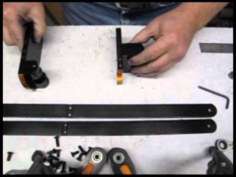

  • DiverBobDiverBob Posts: 1,124
    edited 2013-04-28 23:34
    Finally have all the parts for one leg completed and anodized! I put together a video showing how the parts come together and what the leg looks like.
    I have almost all the parts anodized for building two more legs and then I need to finish up anodizing the rest of the already made parts. There are still some additional items to complete such as the gear trains for the other legs, the leg down switch assembly and a limit switch setup for side to side movement. The plan is still to have all the mechanical parts done in time to take this to the Unofficial Parallax get together in Norwalk, Ohio this fall.
    The attached photos are of the 8 spacers for 2 legs and the leg pivot assemblies completed and attached to the robot base.
    Hope you enjoy the video, let me know if you have any questions
    Bob
