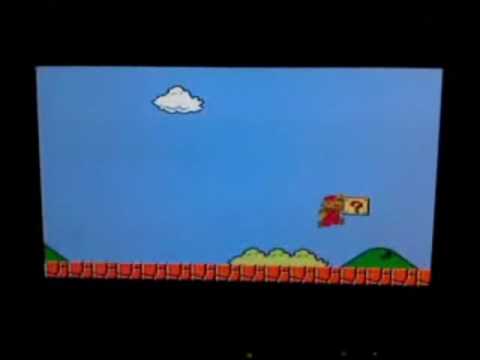

    I already have a design for this (HybridX3) and will happily provide all of the resources in eagle format if you want them.
    I have also been badgering Baggers for the last couple of months to release PropGFX Lite as open source.
    The problem is motivation, we both honestly feel that there is no market for this bar a few hardened users on this forum so maybe all we need is a bit of encouragement.
    I am visiting Baggers next week so maybe all he needs is a gentle shove from you guys and he can get it released :smile:
    @Bean, you need to check out what Baggers did with PropGFX and FemtoBASIC :tongue:
