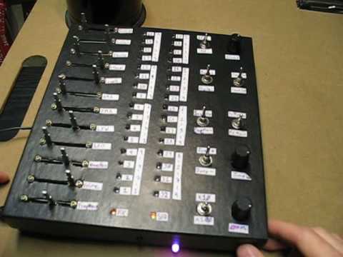

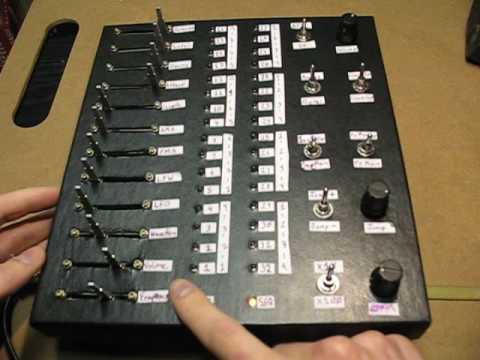

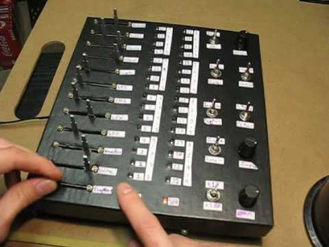

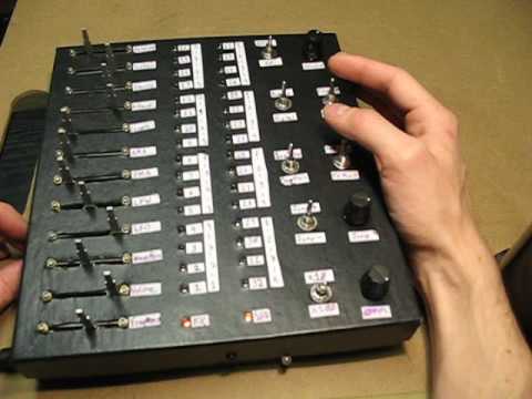

Description: Propeller BlackBox Audio Sequencer V2.0
This device is an audio waveform creation and 32 step sequencer.
(for musicians, mostly electronica dj's) (aka... bassline sequencer, drum machine, 303, 909, etc.)
This device creates audio, it does NOT accept audio INPUT. (yet)
Features:
-Live fx mode to allow direct output of the current waveform set by 12 different potentiometers.
-The sequencer allows the fx to be loaded into any one of 32 steps in the sequencer.
- SPDIF audio output or analog output via a switch (not both at the same time)
- analog output to a monitor(at the same time as spdif/analog output above (headphones or studio speakers) to allow auditioning before outputting live.
- 3 encoders that allow - BPM, main volume, and BPM jumps(1/3, 1/2, 1/4, 3/4, 2/3) and a switch for jump direction. (main volume and bpm jump programming not complete yet)
- BlackBox to BlackBox CLOCK sync, input rca, output rca.(serial @ 150Kbps, works over 1 foot rca cable) (this is so many of these devices can be connected to one main BEAT CLOCK MASTER.)
- 32 LEDS are used as sequencer step indication, ALONG with using the 32 LEDS as buttons to load waveform
- 2 leds that start/stop the sequencer and live fx waveform.
- fully open source that uses the HSS code to generate the audio.
Schematic: See attachment BlackBoxV2.pdf
Block Diagram See attachment BBv2Block.pdf
- AudioSequencer(U1) prop uses all 8 cogs and has 18 I/O free.
- PotReader(U2) prop uses all 8 cogs and has 6 I/O free.
- LedReader16(U3) prop uses 5 cogs and has 8 I/O free.
- LeadReader32(U4) prop uses 5 cogs and has 4 I/O free.
Source Code:See attachment BlackBoxV2.zip fully commented.

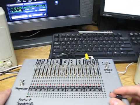

This project uses:
4 props, (4 - .075uf bypass caps 4 power pins)
4 - eeproms
4 - crystals
12 - 80k Potentiometers (you can substitute)
1 - quadrature encoder, (bpm)
34 - LEDS
4 - 56ohm resistors,
12 - 0.015uf caps, (104 ceramic)
12 - 330ohm resistors.
handfull of 1k ohm resistors,
hand full of - 10k ohm resistors
3 - 560ohm resistors
1 - tricolor led
2 - switches,
3 - 1/8in audio jack.
1 - RCA jack
1- 3.3v regulator
An enclosure case, and a power supply. (300ma 6vdc)
PROP 1: 8 cogs used.
-runs 1 analog HSS engine. - 2 cogs
-runs 1 analog or digital HSS engine. - 3 cogs (if digital 3, analog 2)
-runs sequencer, reads switches, runs fx. - 1 cog (heartbeat led runs in sequencer loop.)
-talks to prop 2 (full duplex serial 115200) (potientiometer prop) - 2 cogs. Sends beat. Gets Fx/leds/encoder
- 4 I/O for audio
- 6 I/o for switches
-2 i/o for serial
-1 i/o for heartbeat
PROP2 - 8 cogs used.
- talks to prop 1 (full duplex serial 115200) audio prop. Sends fx potentiometers, sends led states, sends encoders. - 2 cogs. Gets beat.
- talks to prop 3 (Gets 1-16 leds)(fx start, seq start) Sends beat - 2 cogs.
- talks to prop 4 (Gets 17-32 leds, encoders) Sends beat. - 2 cogs.
- reads frequency, LFO pots. - 1 cog. (for a more fluid response, only 2 are read)
- reads all other pots - 1 cog.
12 - i/o for potientiometers
6 - i/o for communications
PROP3 - 6 cogs used
- heartbeat led - 1 cog
- reads and lights FxStart - 1 cog
- reads and lights SeqStart - 1 cog
- reads and lights 1-16 leds when beat changes. - 1 cog
- communicate with PROP2 (full duplex serial 115200) sends 1-16leds, fxstart, seqstart. Gets beat. - 2 cogs
21 - i/o for leds
2 - i/o for comms
1 - i/o for heartbeat
PROP4 -6 cogs used.
- reads encoders - 1 cog
- reads and lights 17-32 leds when beat changes. - 1 cog
- communicate with PROP2 (full duplex serial 115200) sends 17-32leds, encoders. Gets beat. - 2 cogs
***- reads and sends midi beat sync - 1 cog. ***FUTURE***
17 - i/o for leds
2 - i/o for comms
2 i/o for midi
2 i/o for bpm encoder (i have 6 i/o for 3 encoders)

The image attached is the second box that was also made by freehand wiring.
This would have been done with a pcb if funds were not limited.
Post Edited (Clock Loop) : 2/27/2010 5:51:18 AM GMT
