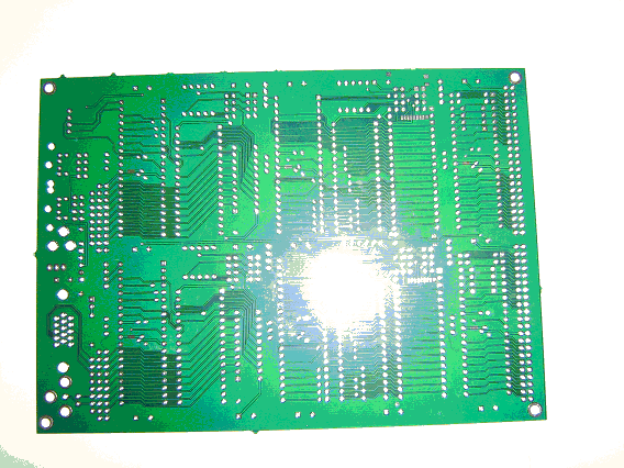

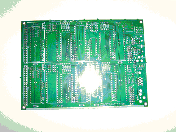

Here is the block diagram of my new SixBladeProp (TM) board. I hope to have it available in the next few weeks.cool.gif
It·can have up to six (6) Propeller circuits which I am calling "Blades".
Blade #1:
A typical Prop Proto Board circuit - PropPlug connector, VGA or TV (shared pins) connectors, PS2 Keyboard connector, PS2 Mouse connector, I2C EEPROM (24C256 or 24C512 or 24C1024). This prop also boots all other Blades (propellers).
Blade #2 and Blade #5:
These are identical. They each can have 1 or 2 128Kx8 or 512Kx8 Static Rams connected. The second static ram may be replaced with an SD or microSD connector or SPI Flash of 8Mbits-64Mbits.
Blade #2 serial may be directly connected with Blade #3 (in parallel with Blade #1).
Blade #5 serial may be directly connected with Blade #4 (in parallel with Blade #1).
These Blades are designed to run large programs, such as microcomputer emulations (see the PropAltair thread),·large LMM programs, large C programs, etc.
Blade #3 and Blade #6:
These are identical and are designed for I/O peripheral use. Each has a 40 pin (30 bit) I/O connector.
Blade #4:
This has·VGA or TV (shared pins) connectors. Also, a 128Kx8 or 512Kx8 Static Ram may be connected. A latch is used to hold the upper 6 or 8 address lines. The lower 11 address lines are connected directly to the propeller. This ram is designed to aid program or video memory, or both.
General:
A comon clock (oscillator) is used so that all the propellers (cogs) may remain "in syc" for high speed serial transfers over·2 wire interfaces.
Almost all·components will be thru' hole, making it easy for·hobbyists to assemble. An SMT version may be made later if sufficient demand exists.
Postedit: Answers to questions below:
  • All 6 props are on the one pcb - load only as many as you need. I anticipate the size to be 5x6". At one stage I thought about stacking a small generalised pcb.
  • The 20MHz is easily obtained, so a PLLx4 would be used. I am looking for a cheap 5MHz because it makes existing software easier - and less emi.
  • There is no ability to add an SD/microSD to Blade #1. There is however 1 LED (not shown).
  • Blade #1 boots all other Blades (#2...#6) after it boots (from its' eeprom or download). Remember, it can have a 128KB eeprom (24C1024). I am writing pasm code to access the eeprom above 32KB (which has been done by others anyway). There is no way to program the Propeller chips ROM.
  • Since there seems to be a lot of interest I will sell the bare pcb, plus some parts if required.
  • I am hoping to be able to place the SD socket over the·microSD socket - then you fit either one.
One question:
Is the pair of 2x20 Pins for the I/O the best connector or do you want a single 2x32 Pins (60 I/Os) or something else like Spin Studio sockets or Diligents connectors or a mix or something again ???
Postedit 4 Feb 2009:
The actual specifications and size have changed since this original proposal. See the full descriptions, schematics and pictures of the pcb which are·contained in·the following posts.·cool.gif
