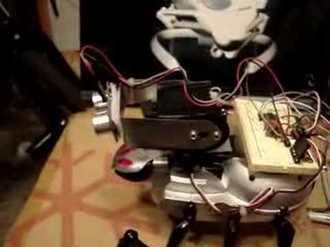

    I love the Ping! Nothing is better in terms of ease of use vs. usefulness for hobby robots.
    Here are my Ping questions
    - How far does a ping sensor have to be from a parallel surface, and at what distance? How wide is the cone of sensitivity and at what angle does it open up at?
    - Some have said that it helps to have a sound dampening surface behind the ping sensor? Is that true?
    - How much motion can a Ping sensor handle while it is working? How fast could a servo with a ping pivot and be expected to work? What about a less smooth motion like a motor vibrating or the gait of a walking robot?
    - What about other forms of electrical interference. I know you should put a capacitor across motor lines, but should you take other precautions?
    I would love to just spend a few days running tests, and perhaps I will, but in the meantime I would like to see what I can get out of this great knowledge base.
    www.youtube.com/watch?v=lI6ACgbyUj8
  • SRLMSRLM Posts: 5,045
    edited 2009-01-09 00:15
    1) Look at the data sheet. It's your main resource for this sort of data.
    2) Supposedly, yes.
    3) I've had the ping take about two 180 degree sweeps with a servo per second, and 18 points each time.
    4) Separate the motor power supply from the electronics.
  • GWJaxGWJax Posts: 267
    edited 2009-01-10 03:58
    This is a small demo on how fast the ping sensors can detect its location and when you see my video you see that the servos are running full speed and it has enough time to grab all information from the ping))) One thing I did not show which I wish I did was a shot of the screen taking the measurements of each swing of the servo.
    Jax
    If a robot has a screw then it must be romoved and hacked into..
  • GeorgeCollinsGeorgeCollins Posts: 132
    edited 2009-01-10 05:49
    If you can sample that fast and have every reading be reliable, that is encouraging for me.
