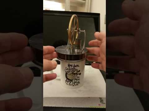

    Different model, but here's a video of one working atop a coffee cup.

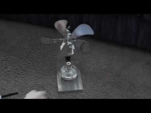

    Here is a video (stolen) of my Stirling cycle engine that I built/machined about 10 years ago.

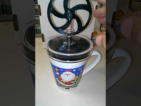

    Mine arrived today and works great. Rich was right about the magnet linking the power & displacer pistons.

    The one I have, with a separate crank to drive the displacer, will only run in the one direction when you stand it over a cup of hot water. To get it to run the opposite way you have to make the top plate hotter than the bottom one - and one way to do that is to stand it on some ice cubes.
    I suspect your engine won't run in either direction when stood on ice - the magnet displacer coupling only works for the hot end being the bottom plate.
