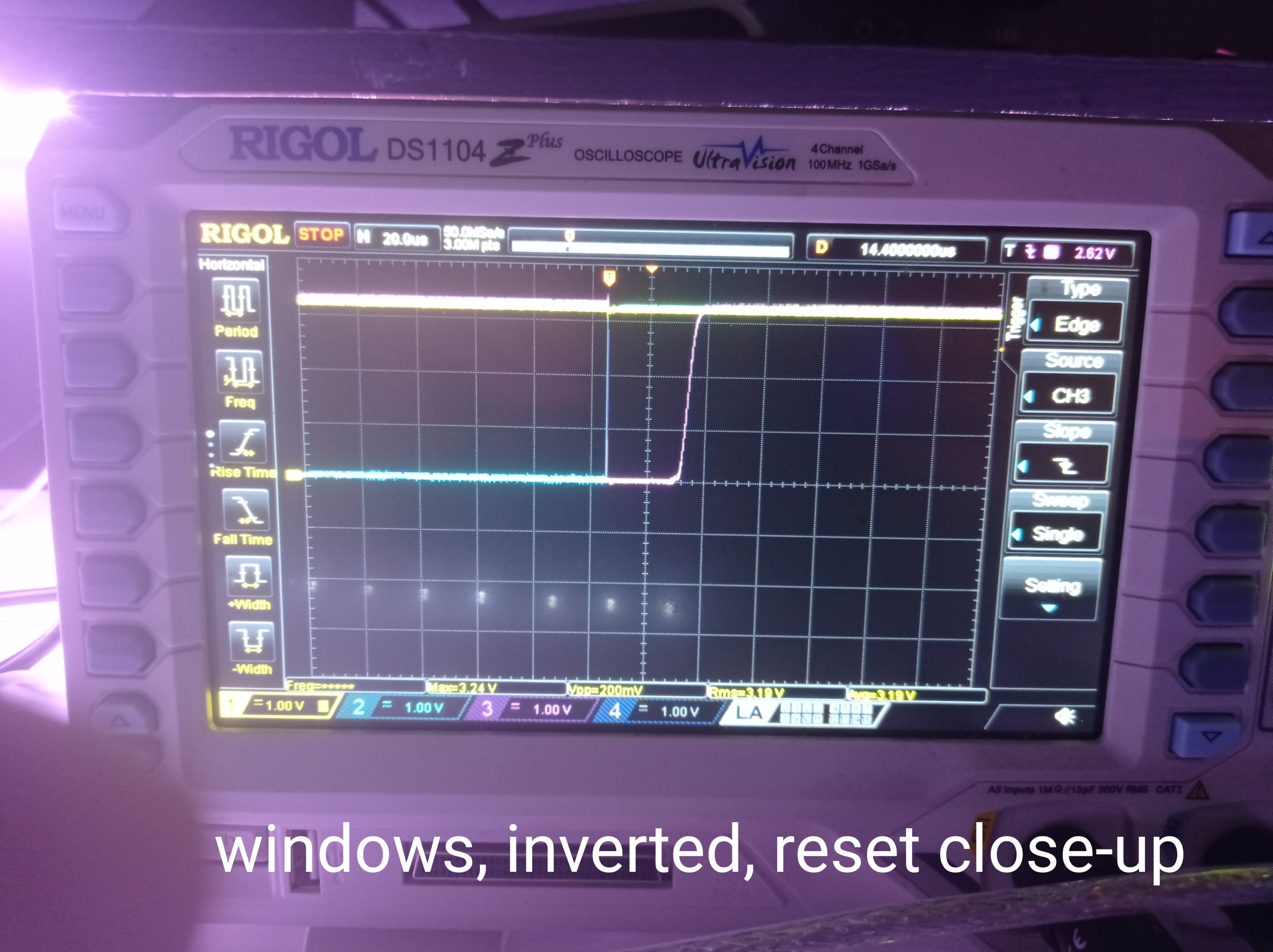

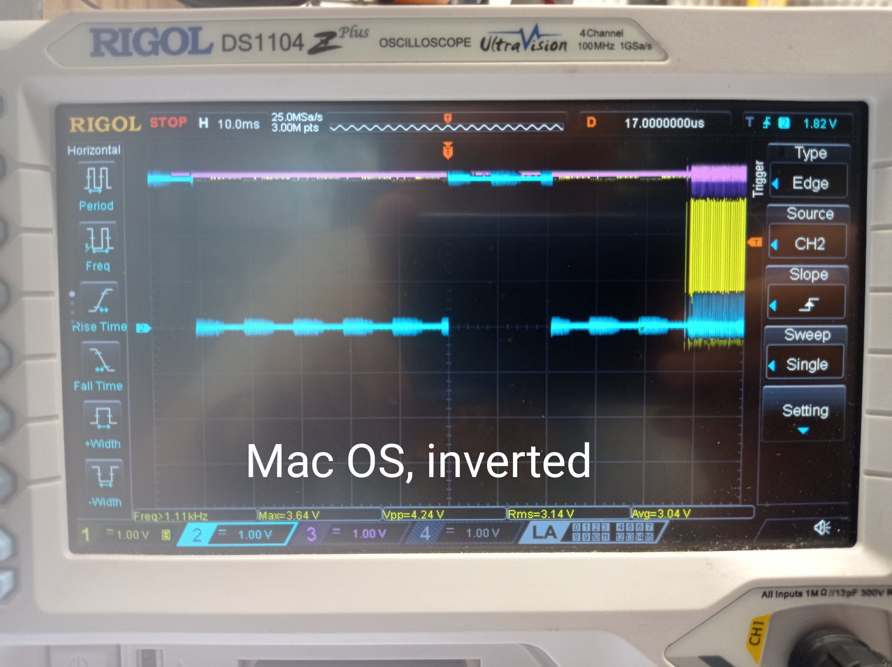

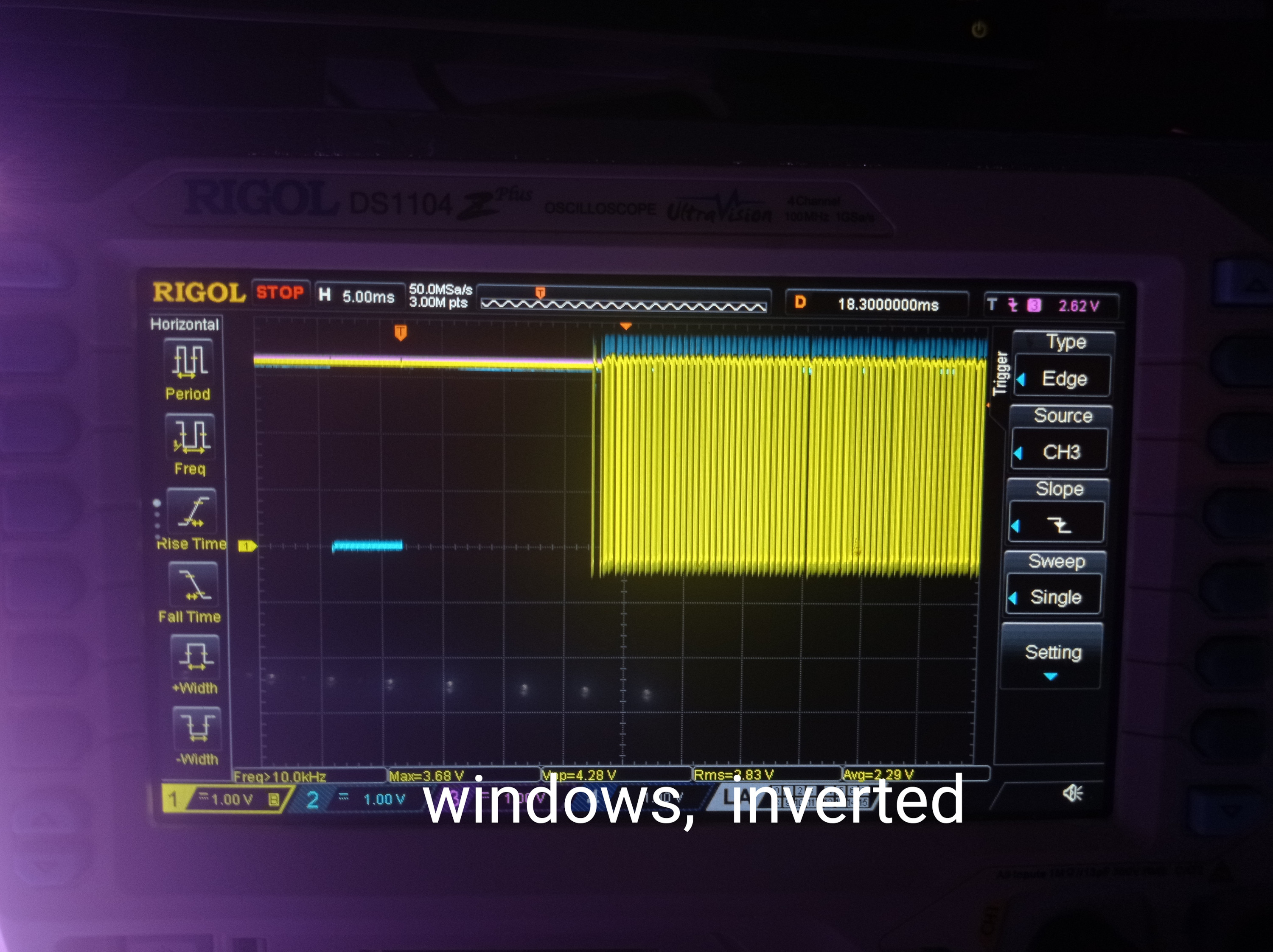

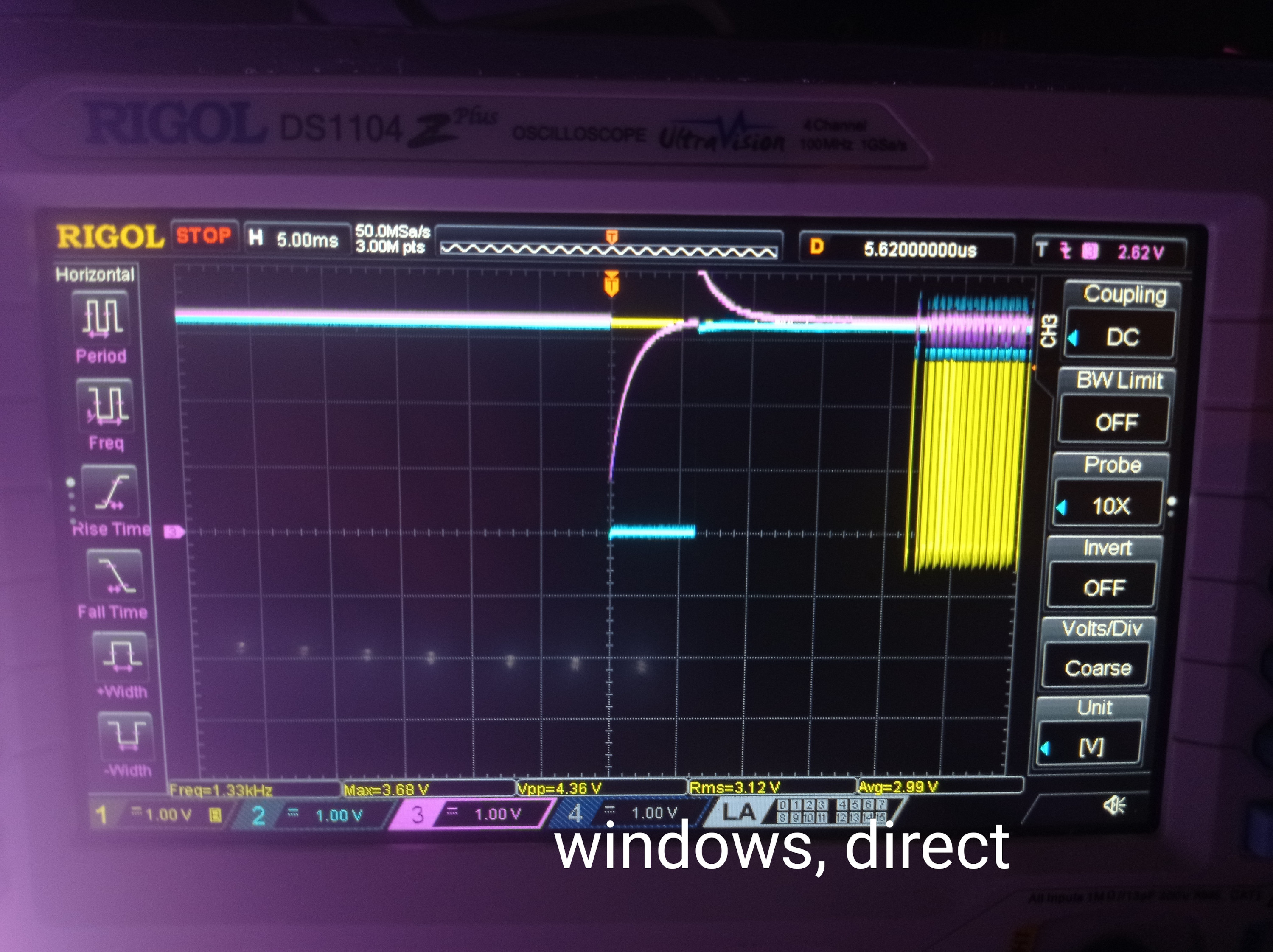

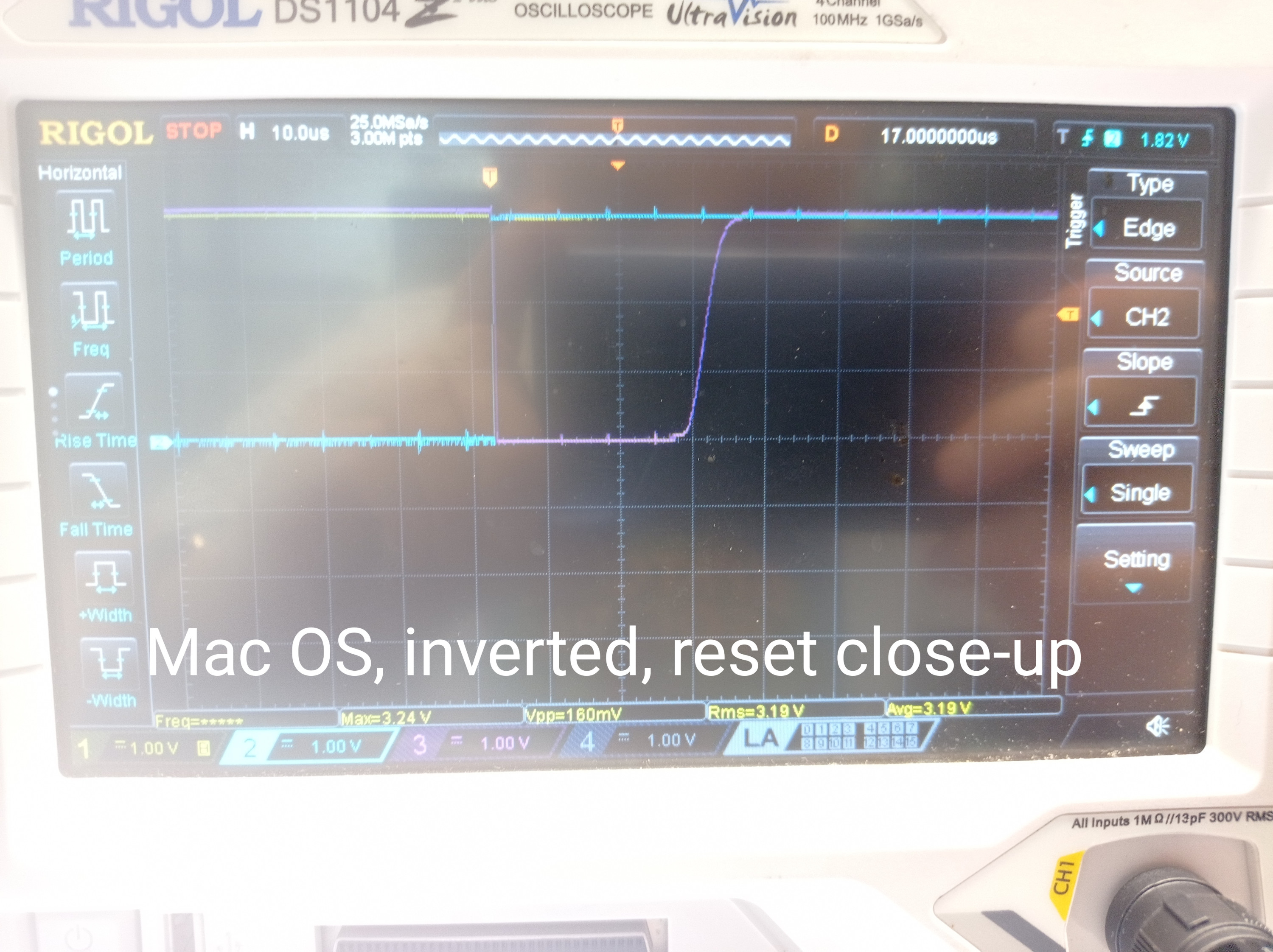

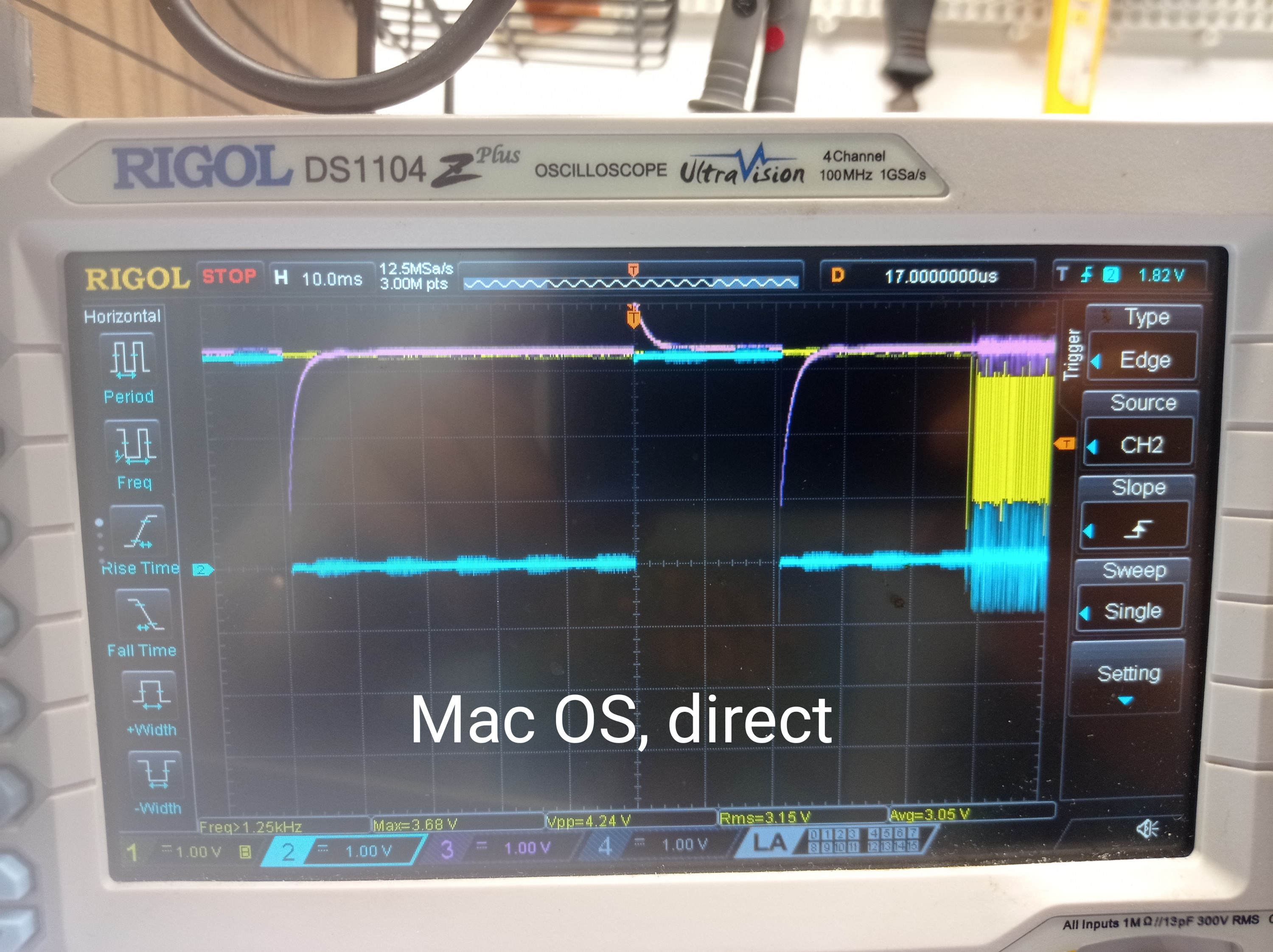

I tried Spin Tolls on Windows and Mac OS (and Linux). Linux and Mac OS behave exactly the same, direct dtr connection to reset (via a cap) gets program uploaded in all modes. Inverted DTR only works when terminal is open, or with debug.
Windows is more interesting. It works with both adapters, direct and inverted, in all modes. Attached are some oscillograms. Quality is not the best, but I think it is clear what is going on there. Under windows, DTR is "normally" high and under linux it is low. That's the only difference, and it makes all the difference. I think that special check in Spin Tools source should be removed, and control signals must be used as in current Windows version
On Linux I forgot to have a udev rule that prevents the dtr toggle on port close, try to run this command before uploading:
/bin/stty -F /dev/ttyUSB0 -hupcl
On MacOS, if the AI answers are correct, you have stty, try to the same command with the appropriate device name.
Windows is another beast, the trick works but is not correct.
Yes, that's correct, but that command works only when the port is open, as soon as there no processes that have that file open, the options are reset to default

I will have a chance to use an oscilloscope in a couple of days, I'll see what's going on there
Yes, always have a pull-up on RESn at the Prop2 end. That needs to stay with the Prop2 when the Propplug is removed.
@"Andrey Demenev" In the other Thread, you said you figured it out and got some code running. Congratulations...
But could you please tell us what was the cause of the problem? It may help somebody else to know the solution.
@ManAtWork I do not have a solution. I am still using the simple adapter with just a capacitor from DTR to reset, without a transistor, and it works for me somehow
Tomorrow I will go to a local hackerspace where we have an oscilloscope and computers with different OSes. I will compare my 2 adapters and examine the difference in reset signal, and also see if the issue I was observing is OS specific

Few posts above I suggested to upload with the terminal window open, have you tried that ?
It may give an hint if the reset occurs because the serial port is closed after the upload.
BTW, I only have prop-plugs, never had an Eval board, however they are one of the first modules (not the latest rev. E with a slightly different reset circuit) so I don't know if there are issues with the latest rev. E prop-plug.
Yes, I tried that. When terminal is open, upload to both RAM and flash works fine.

Good, this means that the reset is triggered by closing the port, almost certainly because dtr is in the opposite state.
Wondering if the fix is the same as Windows, unfortunately I don't have a Mac to test (if I'm not wrong, from the screenshots, you are using a Mac).
I have a number of boards that (under Linux with loadp2) reset when the port is closed. IIRC there's a Linux kernel issue where the flow control signals change when the port is closed that doesn't exist on WinNT (this has been discussed before!). I'd have to dig them all out again to test, but IIRC the EVAL is one of the few that works correctly.
That made me think that I did something in my Linux setup to prevent the reset on port close, and indeed I found this udev rule (added 5-6 years ago and forgot...):
-hupcl disable the "hangup" signal when the last program closes the tty, without that rule the Propeller resets on port close.
Wondering if can be used on MacOS with the proper port names.
