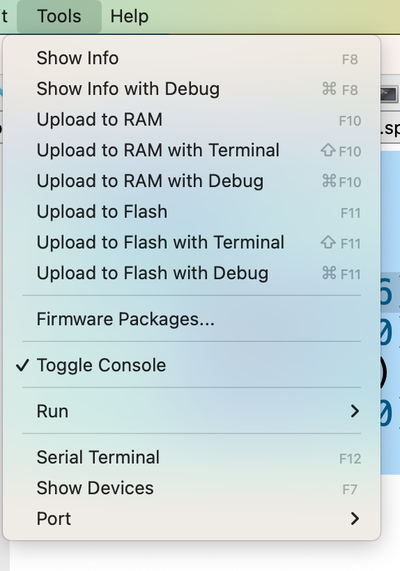

I am trying to run some sample programs on P2, and I am having a strange issue. After I upload the program, it looks like it is not starting. I tried simple blinker, and some VGA demos, and the behaviour is the same: upload goes fine, but the program is not working. The only way I can make it start is using the "upload to ram with debug" button in spin tools IDE.

    I can use "upload to ram with debug" or "upload to flash with debug" - both work as expected
    "upload to flash" – looks dead, reset does not help
    "upload to ram" – restarts whatever was in the flash, but only if it was flashed with debug. If flashed withou debug, it's dead
  • It does not matter if I use debug statements or not. It is the upload mode in the spin tools that triggers that

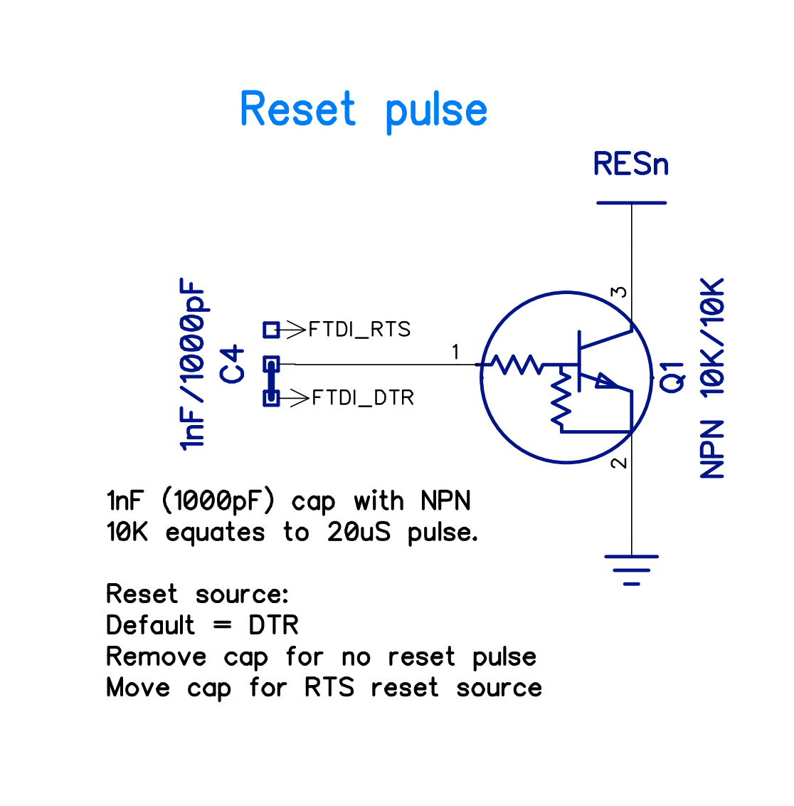

  • Can it have something to do with reset circuitry? I used this board before without issues. Now I made another programming adapter, and i am using DTR for reset. I do not remember which signal was used for reset before. The only thing that changed since last time is the adapter. I do not have access to the old one
    That does sound like a reset after download is happening. Please post the schematic for the adapter you've built.

    It's just a usb/uart converter and some reset circuitry copied from propplug, except I have external resistors, not embedded into transistor

    The only variable is the USB-UART converter. It was FT232, now it's CP2102. Probably there's some difference in control signals timings. I am going to grab an FT232 and try it

    The upload is the same for both modes, however with the debug mode, the serial port is left open to allow the console to display messages from the propeller. In normal mode the serial port is closed after the upload, unless it is used by the serial terminal, my suspect is that closing the port toggles the dtr/rts signals and triggers a reset.
    You can try to upload in normal mode with the serial terminal open (or select upload to RAM with terminal), this should keep the port open after the upload.
    Also, upload to FLASH without debug should work because the flash programming is done by the propeller itself before completing the upload, not sure why this doesn't work.

  • Hi
    I think you need to post the ACTUAL circuit you are using- I see the signage for the cap but NOT its position.
    You do know it has to go BETWEEN the DTR/RTS and the transistor base?
    Dave
  • @tritonium said:
    Hi
    Dave
    Yes, I know that, and I can read a schematic diagram . The circuit I am using is exactly as prop plug.
  • Finally I got it working using this
    Essentially I am using the control line directly to reset the chip, instead of inverting it. Now it works in Spin Tools in all modes, and in FlexProp

  • @macca I looked over the Spin Tools source, and I see that RTS and DTR have initial state depending on whether the OS is Windows or not. What is the reason for that?
  • maccamacca Posts: 1,079
    It is to prevent the reset when the serial terminal is opened under Windows.

    Hmm, I see both solutions, inverted and straight DTR, used in different boards. There is something messy about reset management on the Prop2. And you're not the first person to be frustrated by it.
