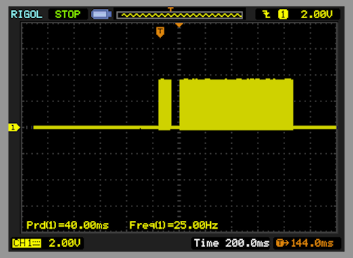

Hi,
First time I've tried it on this board but am having problems booting an old REV-A P2-Edge board from flash. I can see the flash from my app when loaded and running from a RAM download and I can also write to it with loadp2 but it refuses to boot from flash for some reason.
I've got the pull up and down icon dip switches both set off, and flash enabled (serial + flash boot). Won't boot my app from flash. Also tried with the up dip switch disabled and down enabled (flash only boot), with the same result.
I measured P59 resistance to ground (out of circuit) being 10k when the down dip switch is enabled and 14Meg when disabled so I think the DIP switch is working. Measured P61 (flash CS) to be 300k to ground and 10k to the V56 IO pad.
I'm now wondering if there was some known issue in the early boards? Or perhaps there is a problem with my app - but it seems fine when loaded to RAM. I'll pare it down to just toggling a LED and try that too but I suspect it'll be the same. My current binary app image size is about 330kB so I know it fits.
I'm using loadp2 rev 0.77 to flash the P2-Edge with these settings.
loadp2 -t -flash xxx.binary
I know loadp can write to the flash as I also share the upper flash with data and I can see that data in flash if the app is run from RAM.
My RAM load works when I flashed the upper filesystem data at 1MB offset, but the boot from flash seems to fail. Also tried this out...
loadp2 -t -HIMEM=flash @0=z80.binary,@80000000=z80.binary,@80100000=/Users/roger/z80fs.bin
For testing I wrote a simple flash sector dump app which I loaded to RAM and can see my app in FLASH sitting at sector 2 onwards - sector 0 and 1 seem to have a small initial 1kB bootloader written to it which reads in the remaining app code starting from the 1kB offset in flash:

What am I missing? It has been a while since I tried flashing something on a P2 so perhaps I have forgotten something simple and I'm just doing something dumb, or maybe REV A flash booting is problematic...?
Could it be some initial clock setting that is normally patched by loadp2 or something like that? My flexspin based app does have _clkfreq set to 270000000, but no explicit CLKMODE setup otherwise. Although I didn't think it really patched the settings unless -PATCH option was applied anyway.
  • roglohrogloh Posts: 6,402
    edited 2026-06-01 08:59
    Ok, so it turns out that this LED test did boot from flash when I flashed it using this command:
    loadp2 -FLASH ledflash.binary
    so perhaps my 330kB is too big for reliable serial downloading, or perhaps there is a bad sector somewhere in the flash...hope not. I guess I'll try to add a CRC check or read back all the sectors and manually compare the source binary.

    I should also mention: I tried the app boot test after first removing the PropPlug (in case that was holding down reset) and then re-powering the P2-Edge, but always get the same problem with my main app not starting up.
  • evanhevanh Posts: 17,279
    edited 2026-06-01 10:24
    I've never used the multipart bundling let alone also burning it to flash. EDIT: Oh, oops, that was an alternate.
    edited 2026-06-01 11:37
    Ah-ha! The -FLASH option has to be all caps! I guess all of Loadp2's options are case sensitive then.

    Still having this issue. Decided to scope the flash clock pin to see what it is doing. Seeing some strange behavior.
    Firstly I do see an initial burst of 8 bit transfers which would look like what the P2 is doing in its initial 1kB boot.
    Then theres a short gap.
    Then it transfers faster and continuously without byte gaps which appears to be the streamer clocking in the rest of the data according to the code in the loop in this snippet below from flash_stub.spin2. However the duration doesn't seem to make sense. When I zoom in on the individual clocks I see it doing one period in about 80ns (12.5MHz). The application is around 337kB or $54568 longs which was observed above in the 3rd long of the boot loader in sector 0.
    EDIT: Ok, that's the issue then. $54568 is the long count being used, but this is a byte count of the application size, the long count should be 4x smaller! Bug in the flash loader/loadp2!
    edited 2026-06-03 07:11
    Huh, what a bug. No one else has had large binaries I guess. Ada may have at some stage but she ended up putting most of the binary onto the SD card and just had the FAT filesystem in EEPROM. EDIT: Err, no, the emulators are serial booted I believe.
