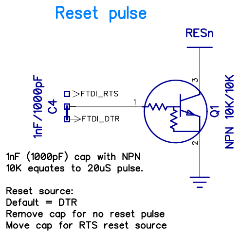

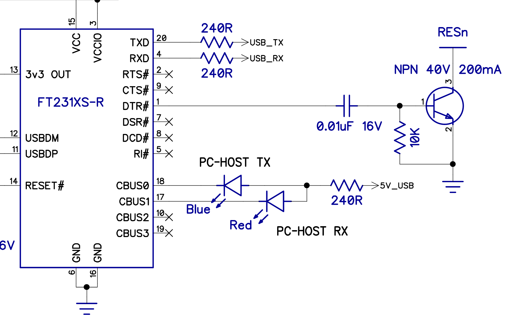

@"Andrey Demenev" Just a couple of observations. The prop plug uses the FT231 with a open collector NPN transistor that connects to the RST line.
The FT232 should be capable of 2Mbaud, but your reset configuration might be problematic, as there is an existing 10K pullup on the edge. With the additional 3.3K above ground, it may not drop the voltage low enough, fast enough, to properly reset.
Rev D Prop Plug
Rev E Prop Plug
Rev E uses an OnSemi MUN5211T1G as the transistor.
Rev D Prop Plug
Rev E Prop Plug
I will have a chance to use an oscilloscope in a couple of days, I'll see what's going on there
Yes, always have a pull-up on RESn at the Prop2 end. That needs to stay with the Prop2 when the Propplug is removed.
