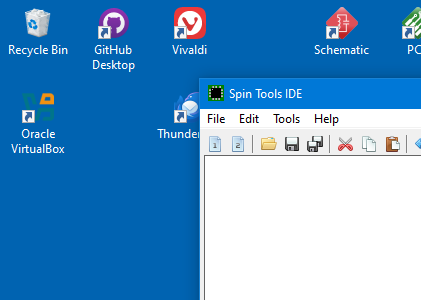

Thank you, Marco. Just to show you what I'm seeing, this is the upper-left offset from my screen to the Spin Tools. I think I used the Maximize button yesterday -- could that be affecting what Spin Tools is seeing for size and position?

Ahhh.... yes, the maximized window... there is a subtle difference between Windows and Linux, for some reasons Windows sets negative x and y for a maximized window, this makes the check believe the title bar is offscreen and resets the position.
Sorry, I need to do that better, maybe I shuld also keep track of the maximized state since it isn't restored exactly as it should.
