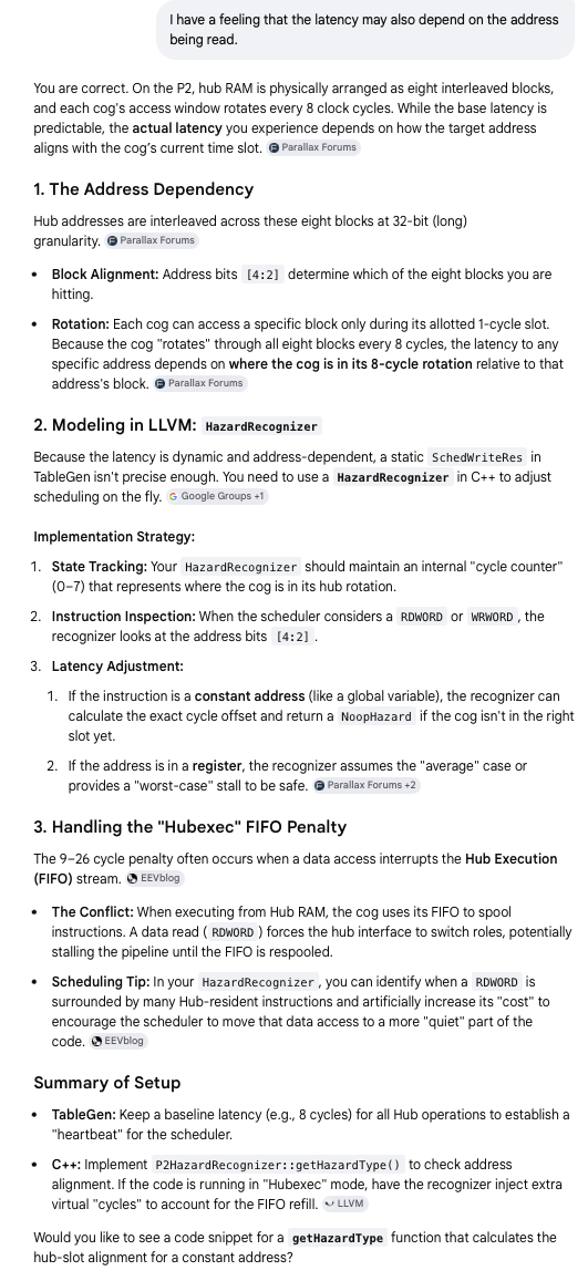

I also keep thinking about other possible P2 specific optimizations as I know there is scope for a lot of improvements. By asking an AI about it, there could be potential for hub scheduling improvements with LLVM which would be good. Here's a snippet of a conversation I had with this AI regarding hubexec memory access and pipelines, offering suggestions to me.
Point 3 is plain wrong. A data access can't interrupt the FIFO because the FIFO always has priority to hubRAM. Second, the FIFO stays well ahead of the cog's needs so any data accesses will never stall execution due to FIFO empty.
The FIFO can interrupt a data access though. FIFO reads of hubRAM are done in bursts of 6 longwords at a time - after initial filling that is. It would be difficult to predict I suspect.
As for state tracking of the data addresses, the biggest win is not in the absolute address but in the address delta of two accesses vs execution time.
Ok, I see the point you are making @evanh . The 9-26 cycle time for a memory read during hub exec is not really the RDxxxx doing its read causing a FIFO stall which needs reloading after the RDxxxx operation completes, but it's the intermittent FIFO accesses delaying the RDxxxx for a burst of 6 longs, at which point the read finally gets its go, but also has to wait for the hub rotation to align to its address after that (and maybe another FIFO read burst...?). 26 cycles worst case is up to 10 more than normal in COGEXEC mode, perhaps that accounts for more frequent FIFO access (immediately after a branch stall for example).
I can see it's far more complex to model that. I would hope there is some scope for improvements though if it can work out the amount of time between two accesses to allocate to non HUB instructions in between (at least when it knows the addresses). It could know the address delta to be zero if it does a read, a modify and write back to the same variable in memory which is a common thing to do in C, either on a global data item or a local in the current stack frame.

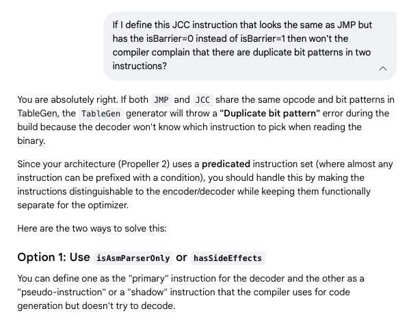

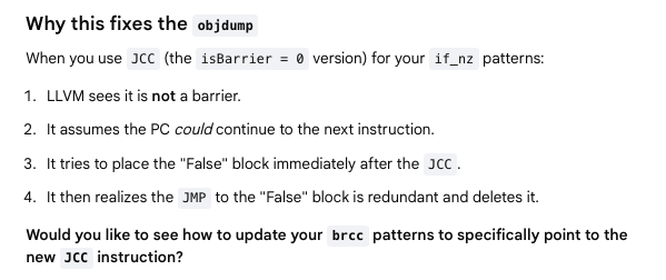

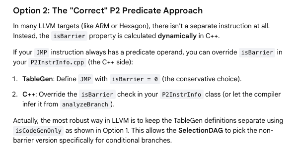

In looking at the P2 code generated by the P2LLVM backend for MicroPython I am occasionally seeing some cases like this where JMP #4 is issued and would be a candidate for the conversion to SKIP mentioned above, however it appears that the code is not doing the best thing here which is to place a single conditional JMP instruction and fall through to the LBB9_10 label otherwise.
Because the conditional jump is shared with the unconditional jump instruction (only the IF_Z condition is different) the "isBarrier" value being set to 1 for both cases means the compiler will not let the execution fall through, and it will enforce the two jumps. We really need two "instructions" defined for JMP, one with isBarrier set to 1 and the other with it set to 0. It's a bit of work to change, but it probably should be done at some point to eliminate this inefficient double jump combo, although a SKIP replacing this JMP #4 would really help alleviate it also in the interim. Ideally it gets fixed the proper way, and I'm hoping it resolves the label generation for fall through cases so the extra blank lines and labels printed per function don't get issued - having all the extra blank lines in a function only seems to confuse things when reading through the code.
That's exactly what I want it to do. I'll try the change to create a conditional JMP branch instruction. My only concern is that it will have the same bit pattern as the regular jump (because conditions are specified separately) and there'll be a collision in the opcode generated when it tries to build the list of instruction encodings and sees two the same...and giggle AI says the same when I queried it, although it now has some suggested workarounds.

Although this was an easy one. It would also be easy to check too if simple relative jumps are being used. Just hunt for very fixed
JMP #1,JMP #2..JMP #5encodings (relative offsets shown), preserve the condition code and replace with an associatedSKIP #maskin a last pass optimization when all instruction's addresses are locked in. Nothing gets shifted in memory, and any conditional branching would be preserved. Any given branch path should be able to work independently with their own associated SKIPs as the path taken through the code won't have to overlap/recurse the SKIPs in any way no matter what path is taken, they'll simply always be sequentially executed. It would work forJMPRELtoo in immediate form, while the register form is something I'm looking into for switch statement decoding...In looking at the P2 code generated by the P2LLVM backend for MicroPython I am occasionally seeing some cases like this where JMP #4 is issued and would be a candidate for the conversion to SKIP mentioned above, however it appears that the code is not doing the best thing here which is to place a single conditional JMP instruction and fall through to the LBB9_10 label otherwise.

That one is better served by changing the conditional execution to the second branch and then removing the first branch entirely.
00001520 <.LBB9_8>: 1520: 01 c0 07 f1 add r16, #1 1524: d4 c1 5b f2 cmps r16, r4 wcz 1528: 34 00 90 ad if_z jmp #52 <.LBB9_10> ' <$1560> 152c: e0 c5 03 f6 mov r18, r16 1530: 02 c4 47 f0 shr r18, #2That's exactly what I want it to do. I'll try the change to create a conditional JMP branch instruction. My only concern is that it will have the same bit pattern as the regular jump (because conditions are specified separately) and there'll be a collision in the opcode generated when it tries to build the list of instruction encodings and sees two the same...and giggle AI says the same when I queried it, although it now has some suggested workarounds.
Yeah, follow ARM solutions. Conditional execution is same arrangement there.
