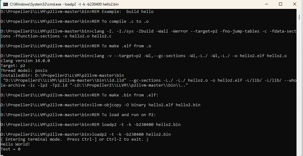

    @rogloh Just tried your patches on Windows build...
    Doesn't crash, but gives wrong answer. Or, maybe I'm doing it wrong?
    Maybe missed something, guess I'll try building LLVM on Windows again...

    Looks like it is working. 100 mod 50 is zero which is what is being printed.
    By the way, just noticed that in the disassembly of your code, the arguments in r0 and r1 are being saved on the stack and read back unnecessarily. Maybe you didn't have the optimizer on. I should retry with the -Os enabled. This sort of stuff is really annoying to see ending up in the code. We shouldn't be trashing the registers so early given we have 32 of them now.
    00000aa4 <test>:
         aa4: 28 02 64 fd                           setq    #1
         aa8: 61 a1 67 fc                           wrlong  r0, ptra++
         aac: 08 f0 07 f1                           add     ptra, #8
         ab0: 3e a1 67 fc                           wrlong  r0, ptra[-2]
         ab4: 3f a3 67 fc                           wrlong  r1, ptra[-1]
         ab8: 3e a1 07 fb                           rdlong  r0, ptra[-2]
         abc: 3f a3 07 fb                           rdlong  r1, ptra[-1]
         ac0: d1 a1 13 fd                           qdiv    r0, r1
         ac4: 19 a0 63 fd                           getqy   r0
         ac8: d0 df 03 f6                           mov     r31, r0
         acc: 08 f0 87 f1                           sub     ptra, #8
         ad0: 28 02 64 fd                           setq    #1
         ad4: 5f a1 07 fb                           rdlong  r0, --ptra
         ad8: 2e 00 64 fd                           reta
    In other news I've been adding a couple more instructions to P2LLVM. LOC and MODCZ. LOC was a PITA to get working and there is still a hard coded register value in there that I don't understand where it comes from but need to use to make it work. Currently working on MODCZ which doesn't have a class template yet and needs to be built up from scratch. LOC is assembling and disassembling now and only accepts PA, PB, PTRA, PTRB as destinations register and generates the correct machine codes. I also tidied up the disassembly output format with a tab between the mnemonic and operands (see above) which looks neater.
    UPDATE: nope, all optimizing settings from -Os through -O3 don't change the listing and they all preserve r0, r1 on the stack and read them back from there even though the arguments are being passed through registers in the call to the test function. Not sure why LLVM is doing this when it shouldn't need to. It's not like QDIV or GETQY have to make use of r0, and r1 (any registers can be used) and given it's a leaf function it doesn't need to preserve its locals on the stack either. It should be using r31 in the GETQY and ideally not even save the registers on a stack frame with the block save/restore setq bursts.
         a58: 64 a0 07 f6                       mov r0, #100
         a5c: 32 a2 07 f6                       mov r1, #50
         a60: a4 0a c0 fd                       calla   #\test

    So it is! This is the danger of posting something before coffee...

    BTW: working building llvm on a few Ubuntu installs. Probably the only way to build micropython. Previous attempts to build upy on windows were failures…
    Lachlan talked to his buddies at his MicroPython meetup and I think some seemed to use Windows PCs but they might have needed Cygwin or other GNU like environment configured (MSYS?) so that make and other utilities it needs worked etc. But a real Linux machine or Mac is probably more ideal in order to build it without so much messing about first.
