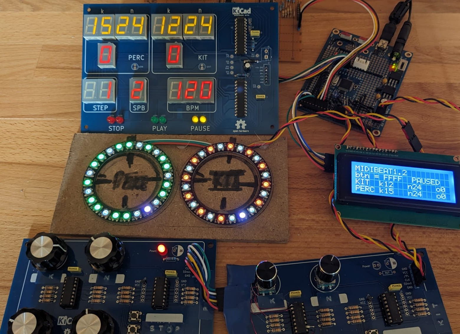

Hi, big shout-out to this forum!
I'm using various AI helpers to learn and develop P1 code for my hobby project MIDIBEAT v1.
I'll post about it here in this thread....
  • TonySpinerTonySpiner Posts: 63
    edited 2026-05-20 17:55
    MIDIBEAT1 is my Propeller 1 MIDI/drum/beat/step/sequencer/thingy project, I'm using it to learn P1 SPIN and to experement with Euclidean rhythm, as described by Godfried Toussaint.
    I'm using free AI agents to feedback on my code and help develop new P1 code for MIDIBEAT1. I have mixed feelings about AI at this moment but it seems to be working for me.
    The amazing user contributions in the Propeller1 OBEX make my tinkering possible, thank you all!
  • Attached is MIDIBEAT1's HMI input driver: 8_encoders_16_buttons_Claude_165.spin object.
    Could be revised further but seems to work fine. Mostly created by Claude, from JonnyMac's 74HC165 code and Mark Tillotson's encoder patterns.
    The input hardware is 8 rotary encoders and 16 push-buttons, spread across two PCBs each with 2x 74HC165 ICs, giving 32 raw digital inputs on 3 I/O pins.
  • Now working towards a HMI 16 digit 7-segment LED display +indicator LEDs
    edited 2026-04-06 15:02
    Thank you Pilot, I'm making some (slow) progress on MIDIBEAT1's MAX7219 PCB layout.
    Considering using dp segments as LED indicators.
    edited 2026-04-24 14:40
    edited 2026-04-24 14:27
    7-segment display PCB is working (for digit segments, dp LEDs still to be tested)
  • using the dp segments as indicator LEDs is working for transport, 2 more to be tested for use as encoder primary/alternate indicators.
    edited 2026-05-19 15:31
    The 2 "mode" indicator LEDs are working too :). Useful as I've decided not to use each rotary encoder's integrated push-buttons. I found that the primary values occasionally get accidentally nudged.
    Instead, I’m using only 2 (latching) buttons - one button selects the mode of the 4 KIT encoders, and the other button selects the mode of the 4 PERC encoders, (primary-mode is pattern, alternate-mode is MIDI).
    edited 2026-05-19 15:18
    Now testing MIDIBEAT with 2 MIDI ports!
    2 Propeller pins drive the active-low enable lines of the buffer IC to route the shared MIDI output to either Port 1, Port 2, or to both at the same time.
    Tested the outputs with 2 drum machines and the multiplexing seems to work. The port switching happens in the main loop whenever a "PERC" (i.e. channel 2) drum hit is required. I added a delay before switching to allow any current MIDI message to complete before it's buffer output goes high-Z.
