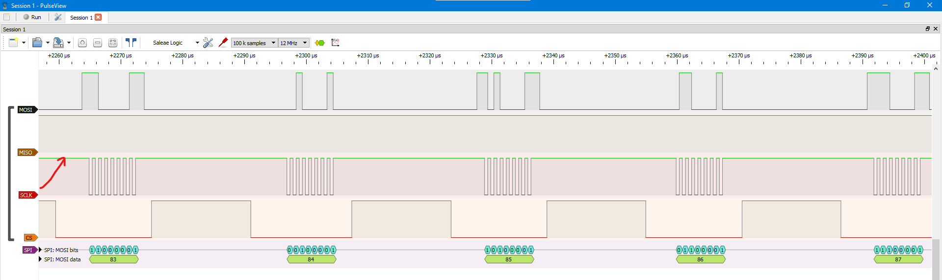

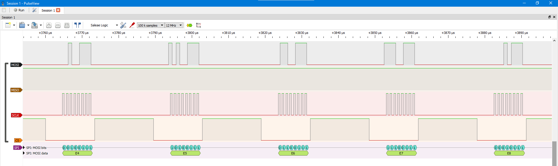

    While looking over some of my objects I remembered that some forum members asked me to make my P2 Flash object run in SPI mode 2 (inverted clock) given the cross-connections between the flash and the uSD on the Eval and Edge PCBs. On a hunch based on what I'd seen with the bit-bang code, I tried Mode 2 with the Smart Pin SPI using the low-cost logic analyzer (LCLA) and it displayed data properly! Here it is:

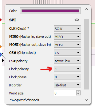

    Note that the SCLK line is inverted for Mode 2 SPI. You need to tell the protocol analyzer about this:

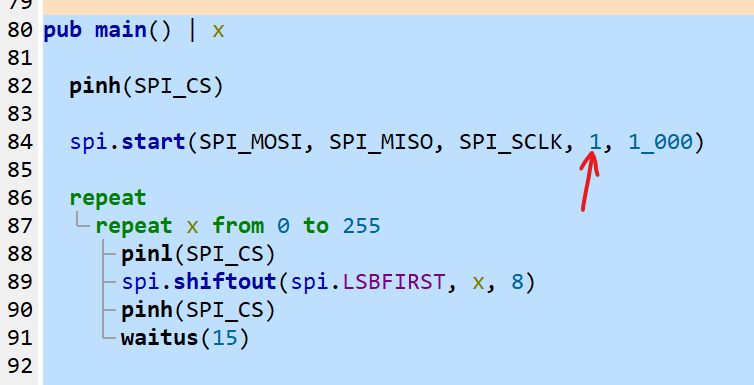

    The setup() method has a new parameter for CPOL (clock polarity):
    Now... if you really want to use Mode 0 (CPOL=0, SCLK is low when idle) then use the object called jm_ip-spi.spin2. This object uses inline PASM to bit-bang the SPI signals and sets the MOSI pin 1/2 cycle ahead of the first SCLK edge which seems to be okay with the LCLA.
    Remember to set CPOL back to 0 in the SPI protocol analyzer settings.
