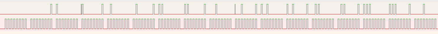

I'm trying to use the ez_spi driver in a program and getting some confusing results. Trying to get to ground level in troubleshooting, I'm testing the following:repeat i from 0 to 9
spi.shiftout(spi.LSBFIRST,i,8)
So the values I should get on my logic analyzer are 0,1,2,3,etc.
Instead, it appears the first bit is at the end, but everything else is in alignment.
So my values (bitwise) on the line look like:
00000000
00000001
10000000
10000001
01000000
01000001
11000000
11000001
etc
If I instead switch to MSBFIRST, it looks like I have a padded 0:
00000000
00000010
00000100
00000110
00001000
00001010
00001100
00001110
etc
The results are the same even if I put it to 32 bits (just more empty bits in between). I'm using flexprop for compilation so I'm not sure if there's a bug in that or I'm doing something wrong. I grabbed the ez_spi driver from the obex, but it also was last updated in 2020, so not sure if something changed between then and now as far as smart pins or hardware goes?
Any help would be appreciated.

Here's a pic of what it looks like on the analyzer for LSBFIRST (ignore the two noise bits from me breaking out the signals)

Is there any chance you're running an inexpensive logic analyzer (I got one from Amazon for $13) and using PulseView? Based on your screen cap, I gave my cheap LA a try and it acted like what you're seeing. Clock and CS signals are fine, but MOSI is garbled. As the cheap LA will look like an old Saleae device in their software, I tried that, too, and got the same garbled results. I can't explain it. I even tried moving the MOSI pin away from the others and still had a problem. Unfortunately, PulseView doesn't work with my Logic-8 Pro so i couldn't check that.
You can see that it's fine with the 1MHz clock signal, but MOSI is broken. I think it has something to do with the way the device samples the bus. I have an idea that I will try after lunch.
After experimenting this afternoon I am convinced that the problem is your logic analyzer. Given the way smart pins operate I thought I'd try an inline PASM approach; it seems to work, probably because the inline PASM code has more breathing room between the MOSI output and the rising edge SCLK signal -- this seems to make a difference with the low-cost LA using PulseView. In this capture I'm running SPI at 1MHz.

That should fix it. The code @kwagner was using didn’t seem to set mosi before the rising edge of sck….
Seems in spi mode 0 the data is sampled on the rising edge of sck. The data @kwagner showed seems to look bad….
But maybe the logic analyzer was doing something weird. A very slow spi clock maybe shows something different?
It seems to, even when compiled by FlexProp. I'm really confused about the logic analyzer: When running the smart pin SPI it sees the 1MHz SPI clock with no problem but the MOSI data is a mess. I though that the LA is doing 8-bit parallel samples at the specified rate and the protocol analyzer sorts things out after, but the MOSI capture is fouled. I even tried reversing the order of the pins but that made no difference.

While looking over some of my objects I remembered that some forum members asked me to make my P2 Flash object run in SPI mode 2 (inverted clock) given the cross-connections between the flash and the uSD on the Eval and Edge PCBs. On a hunch based on what I'd seen with the bit-bang code, I tried Mode 2 with the Smart Pin SPI using the low-cost logic analyzer (LCLA) and it displayed data properly! Here it is:
Note that the SCLK line is inverted for Mode 2 SPI. You need to tell the protocol analyzer about this:
The setup() method has a new parameter for CPOL (clock polarity):
Now... if you really want to use Mode 0 (CPOL=0, SCLK is low when idle) then use the object called jm_ip-spi.spin2. This object uses inline PASM to bit-bang the SPI signals and sets the MOSI pin 1/2 cycle ahead of the first SCLK edge which seems to be okay with the LCLA.
Remember to set CPOL back to 0 in the SPI protocol analyzer settings.

Thanks for all the discussion and checking on this. I was out of town so unable to look at it. I'll parse through this and give it a go, thanks!
And yes, I'm using the cheapo logic analyzer off amazon with pulseview. Guess I need to upgrade
jm_ip-spi.spin2 works beautifully! Thank you again!
