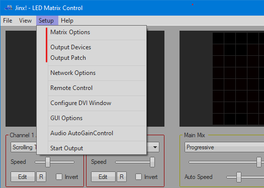

As Ray was kind enough to send me a board, I did! -- throw Jinx at it. Thanks for mentioning it, Terry. The only lighting controller I'd ever used before was version 2 of Vixen.
I kind of muddled my way through Jinx, but did get it working. Now that it works I should probably read the Jinx docs!
The first three elements of the Setup menu will get you there.

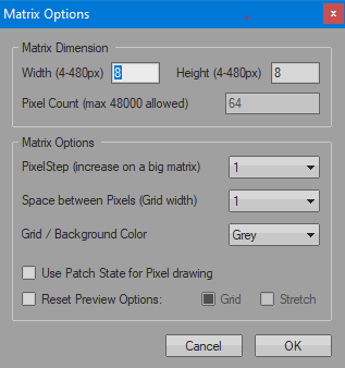

Step 1: Define the matrix size. The only thing I did was change the dimensions.

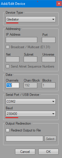

Step 2: Add an output device -- in this case we use serial via the Gledinator protocol.

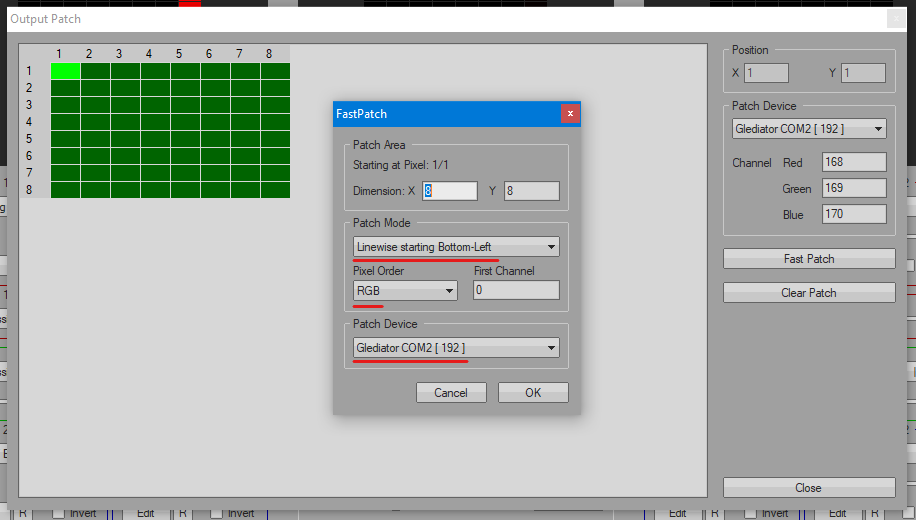

Step 3: Patch the matrix to the serial device.
Click on Fast Patch and then select Linewise starting Bottom Left if your board is oriented connector left, pixels right like mine is (see video). Funny, I modified my driver this morning because I expected lighting control software would want to start in the upper left. There are other reasons to use the latest driver (in the archive), but we don't need to use the vertical flip feature I added when using Jinx.
Since the code using the programming port, download the project first, then you can run data to it.
IMPORTANT: Set the master level very low before clicking on Start Output to prevent drawing too much current from the USB port.

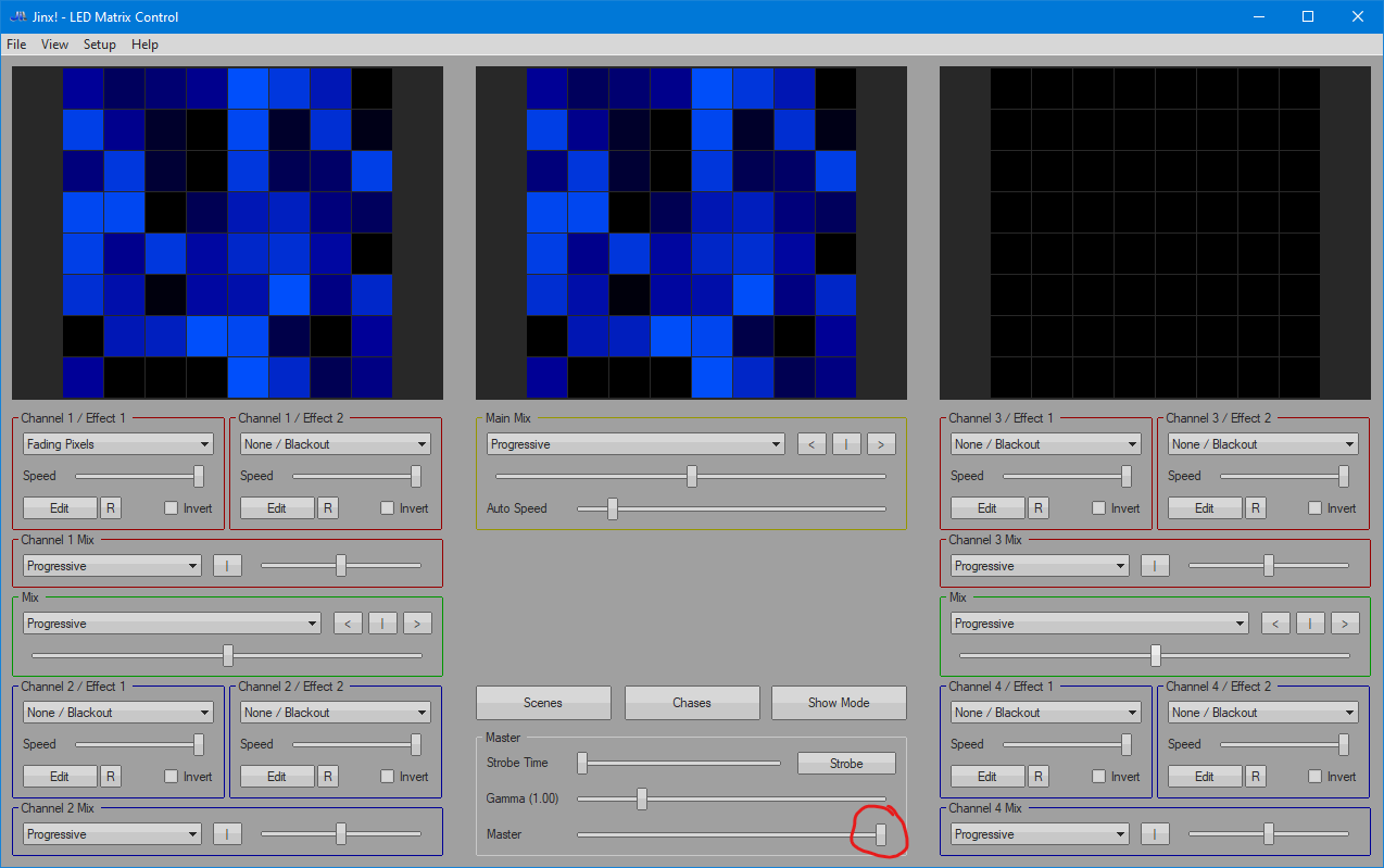

The need to turn down the master (brightness) is a bit not so nice as it makes the preview window too dark to see.
Maybe need to do this in the driver instead...
Start Output needs to be turned off and then back on for changes to take effect, seemed like.
That isn't my experience -- I can select something different from the Channel 1 drop-down menu an it will immediately take effect.
Easy-peasy lemon squeezy. There is a scaling method in the driver -- change your main code to this. I just tried it with the master level on Jinx set to 100% (fully right).
