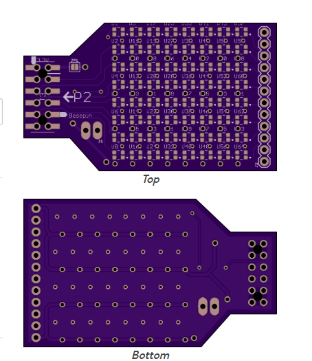

Found these lower current version of WS2812 RGB LEDs in 2020 size:
https://www.smart-prototyping.com/WS2812-2020-Addressable-Fullcolor-RGB-LED?search=WS2812-2020
Seems some places are calling the low current version WS2812C.
WS2812C is 5 mA per led whereas WS2812B is 12 mA per led.
This is still a ton of current for an 8x8 array if all turned on.
It would likely exceed the 500 mA limit from the regular single USB to FT231X 5V power.
However, seems most board have a second USB source for power or one main high current supply. This should probably be enough.
Or, could dial down max brightness to 33% on all LEDs and that should be good.
Still, added a couple places to provide extra 5V power on the board...
Just ordered via OSHPARK. Can't do China right now due to lunar new year...
OSHPARK was actually very reasonable cost and time to get some prototypes...

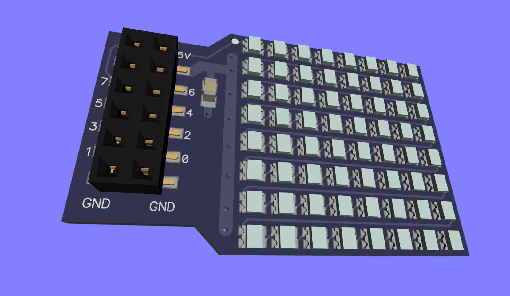

    Cool. I did one of those, too. I have the boards and the parts, I've just been too busy to populate and pop into the toaster over. Josh and I use a couple of 8x8 WS2812b arrays in one of our products and I thought this would give us something to use for experimenting with animation "cells." Again, not finished yet because it's a "nice to have" not a "must have" at the moment.
    Your board has more features than mine; I stuck to one pin and the pixels are powered from the 5v pin on the accessory header so I know I have to manage current. I wouldn't have considered trying the 2020 pixels in the past, but my friend Rick used them in the robot called "4" in the last Superman movie, so I decided to give it a try.

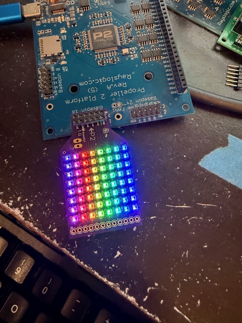

  • RaymanRayman Posts: 16,445
    @ke4pjw OSHPARK worked out well. Picked the fast service and boards came in 8 days. Wish they were blue and wish Qty. was 4, but speed and price is perfect.
    Also found today that they will accept a board that is several boards in one with breakaway tabs. Nice that they allow that...
    Also, LEDs came in tape. This is excellent. Means can use pick and place one day when get stencil...
    @JonnyMac Looking at your driver (OB2857)... Thinking ADDPINS 7 might get all 8 rows to show the demo. That would be very nice...
  • JonnyMacJonnyMac Posts: 9,833
    edited 2026-03-16 18:22
    I'll do you one better: a driver with 8 (contiguous) outputs that can all be independent. A couple of years ago Terry Trapp needed a multi-channel pixel driver so he and I both created versions. Mine is attached. This will give you more flexibility than writing the same data to every pin.
    The screenshot shows four channels so you can see that there is different data on every output.
    Edit: Corrected driver in post #25
    1920 x 528 - 40K
    "Addpins 7" works! Turns single string demo into 8x8 demo...
    https://www.youtube.com/shorts/AZ2Rf481aro
    Will try the new 8x8 driver by @JonnyMac next...
    Really happy with light level and current use, must be <500mA as just powered by single USB cable...
    This was what was hoping for.
    Don't think demo does all LEDS on full power though, might test that...
    Or, maybe not, that would be close to 1 A in theory...

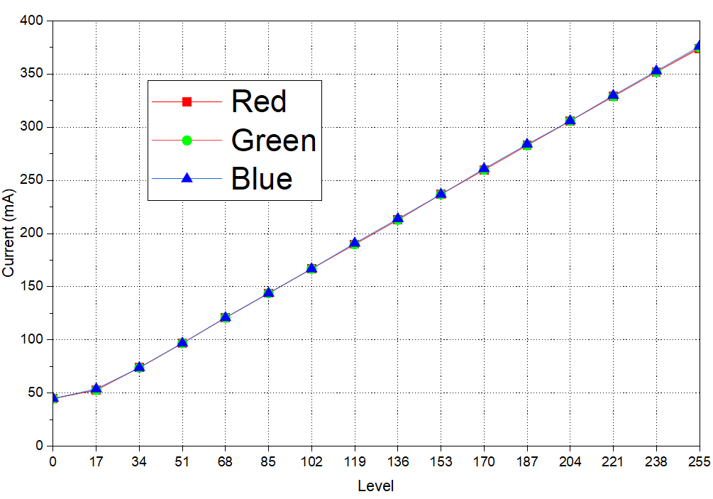

    edited 2026-03-13 13:06
    Remember now that the @JonnyMac strip demo has brightness set to relatively low values, $20 out of $FF (32 of 255).
    Setting to $FF makes it super bright and also draws a lot more current.
    Making some notes here on current draw:
    Red Only $FF = 318 mA
    Green Only $FF = 302 mA
    Blue Only $FF = 277 mA
    This gives me a chance to test out the second USB-C connector on the P2 Platform board, meant for power only.
    There is an issue there though... There's a Zener diode in series there, meant to be a backstop. But, it drops 0.55 V at full current, which is enough to mess this up.
    So, put a jumper over the Zener.
    Red + Blue $FF = 702 mA (multimeter switched from mA to 10 A setting)
    Red + Blue + Green $FF = 1026 mA It's bright! Hard to look at! Board is getting a bit hot too...
    Guess this is close to rated value: 8x8x3x5 mA = 960 mA.
    Probably within multimeter error range...
    Array draws 45 mA even when all off. Interesting. Have to see if datasheet supports that...
    Took a minute to record current (using multimeter on 10A setting) vs level for all three colors.
    The current vs color is almost perfectly equal. So, each color draws same current for same setting.
    The current seems to match the datasheet: with max of 5 mA per color per chip, or 15 mA per chip, 120 mA per row, 960 mA for whole array full on.
    If just using regular USB for power, probably want to limit max level to some value due to 500 mA total current limit.
    Guess the $20 setting in the @JonnyMac driver is good. $22 draws 74 mA per color --> 222 mA total if chips and colors set to $22.
