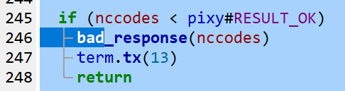

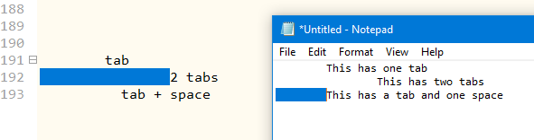

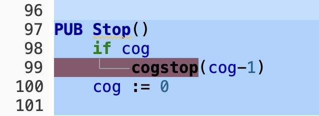

To help with reformatting code, where there are leading TABS and/or leading spaces, could double-click selecting work more like other code editors (at least the ones I use as a MacOS guy )? Instead of selecting all of the leading tabs/spaces as well as the first word of text, could the selection take up single tabs or any sequential spaces and not the first word of text? I often copy code from examples off the internet and tabbing & spaces used for indentation are not formatted in a style that conforms to the style I use. It is difficult to select just the leading tabs & spaces with a double-click.
I've attached a zipped mp4 of how this editing action works in the MacOS TextEdit app which is a simple example of how every (on a Mac) editor app allows double-click selection of leading tab/spaces.
FWIW, I tried two editors in Windows: EditPlus and Notepad. Double-clicking leading whitespace selected all of the whitespace (tabs, spaces, combination) at the head of a line.
In the Windows version of Spin Tools double-clicking the leading whitespace selects the whitspace plus some alphas. Triple-clicking selects the whole line (expected).

An editor feature request...
Current Spin Tools TAB select:
Thank for your consideration,
