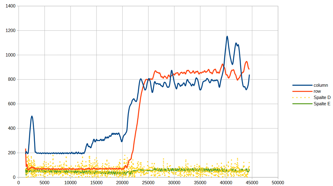

    Some progress:
    Instead of switching the camera stream on and off via i2c, which gave a frame rate of 7.5/sec now the camera sends pictures continuously, which gives a frame rate of 23/sec and same update rate for the position. That helps a lot.
    Using the FlexSpin compiler only one COG is used at the moment. Grab frame, calculations of position and PID all fit into each 43 ms cycle.
    PID controllers are modified:
    • K.P is reduced very much but a constant value is used if there is a difference to destination. Idea is to have a slow speed even if the deviation is big.
    • To work against sticking, short pulses are added, if there is no speed.
    Picture shows positions over time.
    Line direction works better. There is more mechanical waviness like valleys in column direction. Unsticking column direction also gets ball to move along line direction.

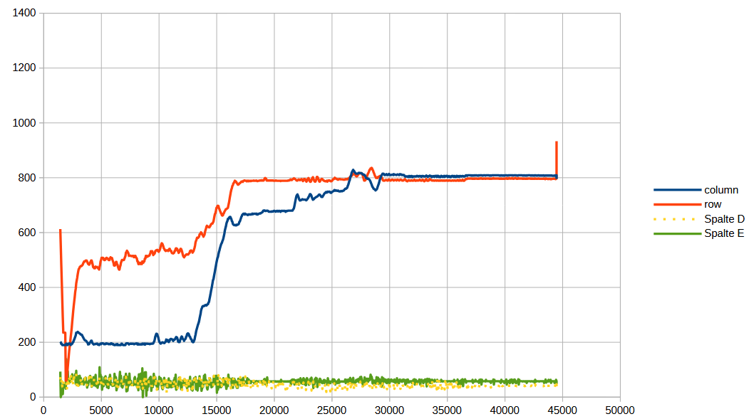

  • So I tried an outer 3 point controller with additional slow integral. Idea is that the slow integral shall deal with general servo trim. Output is a setvalue for speed.
    Inner PID working on speed. Faster integral with limit. Additional pulses to overcome sticking of the ball.
    Also went to floating point math for the controllers. It is more easy to dial the parameters.
    Unfortunately the result is not really better.
    Main problem is still the waviness and roughness of the thin black paper cardboard which is used as plain.
    X: Time in ms. Y: travel in 10*pixel
    To do the original maze game, a precision of about +/- 5mm, which is +/- 2.5pixels, is needed. The wooden basis is more even, but roughness might be similar or even worse. So this is not looking good. I probably need some other means to overcome sticking. These servos are too slow to generate short pulses.
