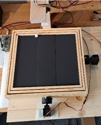

This is some fun experiment and work in progress. Goal is to control the path of the marble.
Hardware consists of a P2 Kiss Bord with attached BW Camera as 2-dimensional position sensor to detect a white marble on a black background. The marble runs on a plain, which can be tilted in two directions using 2 standard 180° RC servos. Mechanics is a labyrinth game.
Diameter of this glass marble is 13,77mm, weight: 3.35 grams
The usable size of the plain is 264mmx223mm
Vertical distance of the camera from plain: 390mm
Camera: https://forums.parallax.com/discussion/178031/connecting-a-bw-320x320-pixels-camera-arducam-hm01b0-to-parallax-propeller-p2-via-4-lines#latest but using resolution 160x160 Pixels
There is a 1W LED lamp close to the camera to avoid asymmetrical shadows.

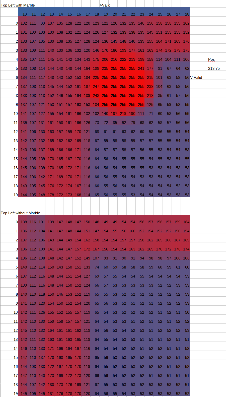

This is, how the camera sees the marble in the top left corner:
The wooden frame is rather bright too, so this is cut away.
The very simple method to get the position is right now to consider every pixel with brightness > 210 as part of the marble.
pub calcBallPos() | index, line , val, n, nc, nl '###########################################
    n, nc, nl:=0 , 0 , 0
    repeat line from LMIN to LMAX
        repeat index from CMIN to CMAX
            val:= picBuf.byte[line*(164) + index+4] ' 4 border pixels
            if(val>BBRIGHT)
               'term.tx(grey95.byte[95 - 95*val/255])
               n+=1
               nc+=index
               nl+=line
    if(n>0)
      colPos:= 10*nc/n
      linePos:= 10*nl/n

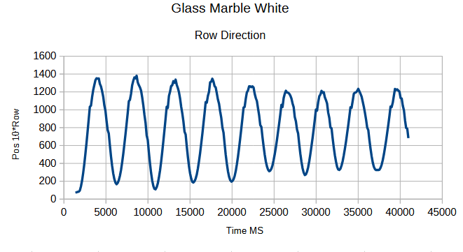

The idea is to try a PID-controller or rather two of them for the 2 directions. At the moment I am trying to learn about the system. There is an interesting Autotune Method to set the PID parameters, which gets information about the system via a Relay test: https://pages.mtu.edu/~tbco/cm416/Atune.html
So with an angle amplitude of 9 degrees at the servo (at the plain it is less), we get the following behaviour:
Cycle time for this is about 4600ms and resulting amplitude is about 89 rows.

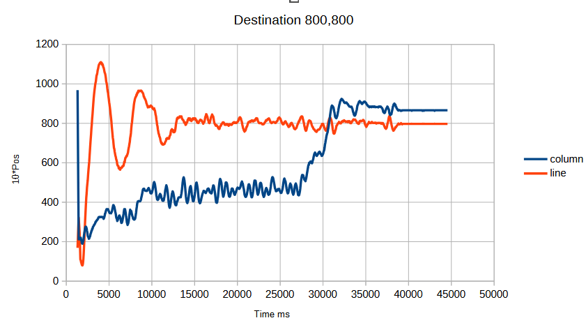

    Picture shows positions over time.
    Line direction works better. There is more mechanical waviness like valleys in column direction. Unsticking column direction also gets ball to move along line direction.

    Inner PID working on speed. Faster integral with limit. Additional pulses to overcome sticking of the ball.
    Also went to floating point math for the controllers. It is more easy to dial the parameters.
    Unfortunately the result is not really better.
    Main problem is still the waviness and roughness of the thin black paper cardboard which is used as plain.
    X: Time in ms. Y: travel in 10*pixel
    To do the original maze game, a precision of about +/- 5mm, which is +/- 2.5pixels, is needed. The wooden basis is more even, but roughness might be similar or even worse. So this is not looking good. I probably need some other means to overcome sticking. These servos are too slow to generate short pulses.
