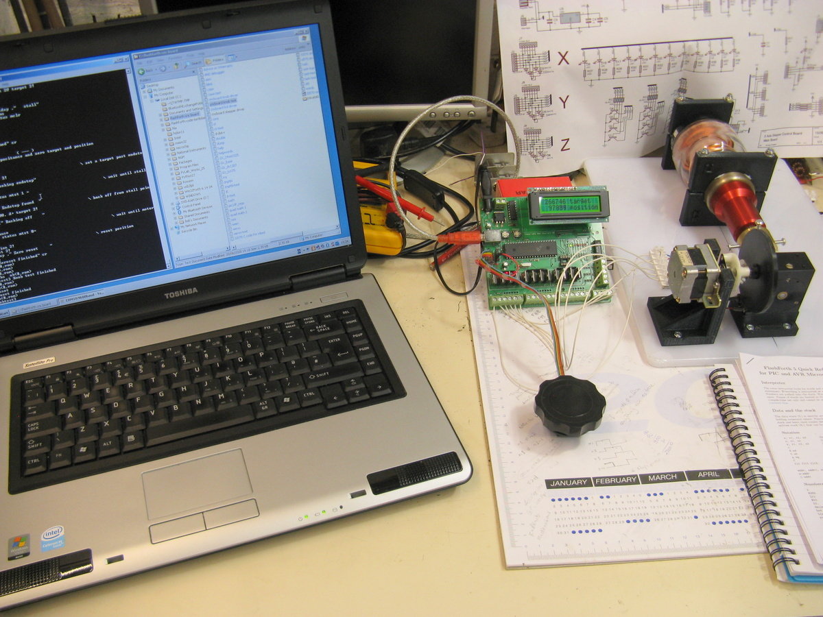

Quite a while back, I helped make a magnetic loop antenna for a friend. My job was to create the stepper motor driven capacitor and the desktop controller. The controller had a knob to set the capacitor, which was a cheap encoder with a click stop action. This was really irritating in this application, so I dismantled the encoder and took out the click spring. This also resulted in the operator being able to step the control by one easily. I programmed the pic controller in multitasked flashforth, I remember. Because the knob had to set the capacitor in the range 0 - maybe 20000, I arranged that the knob increment was variable, depending on how fast the knob was rotated. It was either x^2 or x^3, I can't remember - but it felt quite natural, you could spin up large numbers quickly or slowly increment by 1. I was quite proud of that project.
