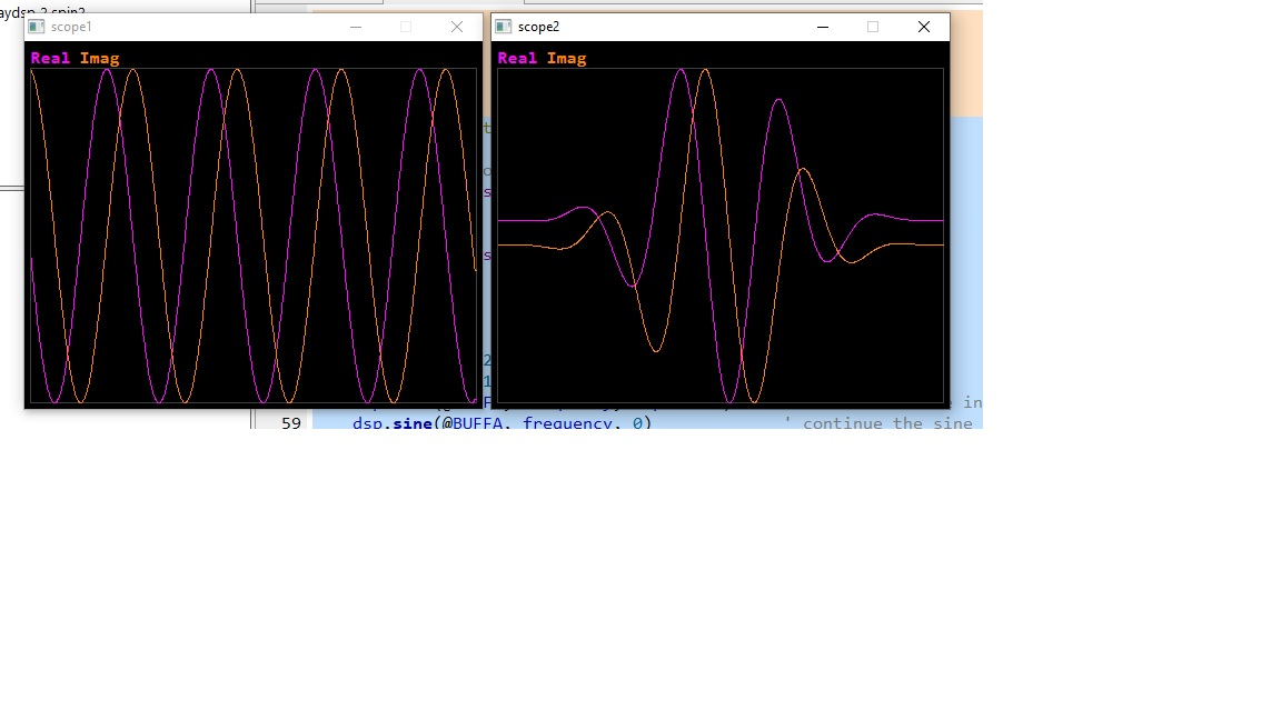

  • I spotted the scope plot of the windowing method didn't look quite right. The whole idea is for the waveform to start at 0 and end at 0. The scope trace above doesn't look like it does that. However, it was only the two traces being set on AUTO scaling. When I defined the max and min plot scale, then the two traces did show zero ends:-
    The production of the window in the DAT section was not laboriously typed in. It was a matter of:-

    I'm working towards a bandpass filter for use in a software defined radio whose low and high cut-off frequency can be changed by the user whilst listening to the radio. The FFT fast-convolution filter I intend to use requires the bandpass filter impulse response as one of it's inputs.
    I made a demo of producing that impulse response on the P2. I've used SPIN2 floating point for now, so as to be sure of not losing information with integer rounding. These are the debug plots it produces:-
    Top line, left to right: The Blackman Harris window, The lowpass filter impulse response, The windowed lowpass filter impulse response
    Bottom line, left to right: An iq sinewave, The windowed lowpass filter impulse response converted to bandpass impulse response by multiplying by the sinewave
    I was gratified that the results look to be identical to the filter I produced for a LabView receiver, written quite a few years back.
    I had to update @ersmith 's BinFloat.spin2 library from the obex to allow it compile under Spin2 v52 (Two names - exp and exp10 - are now reserved words). I removed methods that are now built into Spin2.

    The front end of my software define radio converts a 48 khz wide chunk of the short wave bands to a baseband iq signal. However, due to tiny imbalances in the circuitry, the i and q channel into the adcs of the HDaudio module have small dc offsets placed on them. The dc offsets are undesirable, leading to a permanent, small phantom signal in the middle of the spectrum display. So I've been experimenting with estimation and removal of the dc offsets. I've coded a solution in Spin, prior to writing a faster method with inline Pasm. The attached code shows a slow iteration to a stable point, eliminating the DC offsets.
    The scope window on the left shows the iq signal with a bad dose of dc offset, the window on the right shows the signal having been cleaned up.
