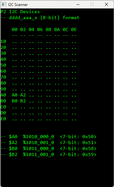

    Interesting... It is sorta like two 512k chips on same bus with different A0 addresses...
    Imagining will show up as at least 3 devices in i2c scanner....
  • JonnyMacJonnyMac Posts: 9,809
    I think two devices: one at %1010_0000 and the other at %1010_0010 -- this assumes that the A1 and A2 pins on the chip are pulled low.

    Got revised Platform3 boards and built a few with this new EEPROM.
    Think it is working, maybe. Shows up in scanner as 4 devices...
    Think maybe can use existing driver for eeprom, just treat as two separate chips...
    Guess we'll see...
    363 x 597 - 12K
  • RaymanRayman Posts: 16,340
    Flashed a simple program and appears to be working :)
