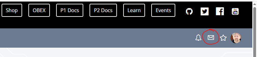

    edited 2026-02-12 22:32
    Scroll to the top and look for an envelope icon. Click on that to get your DMs.
