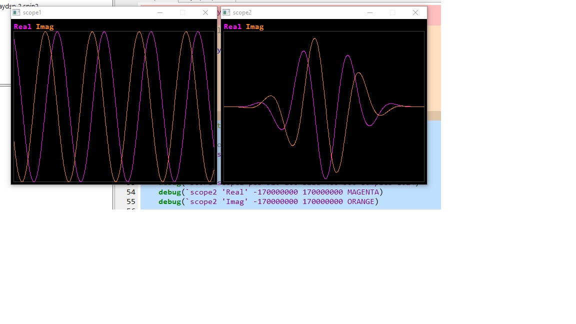

I'm working towards a bandpass filter for use in a software defined radio whose low and high cut-off frequency can be changed by the user whilst listening to the radio. The FFT fast-convolution filter I intend to use requires the bandpass filter impulse response as one of it's inputs.
I made a demo of producing that impulse response on the P2. I've used SPIN2 floating point for now, so as to be sure of not losing information with integer rounding. These are the debug plots it produces:-
Top line, left to right: The Blackman Harris window, The lowpass filter impulse response, The windowed lowpass filter impulse response
Bottom line, left to right: An iq sinewave, The windowed lowpass filter impulse response converted to bandpass impulse response by multiplying by the sinewave
I was gratified that the results look to be identical to the filter I produced for a LabView receiver, written quite a few years back.
