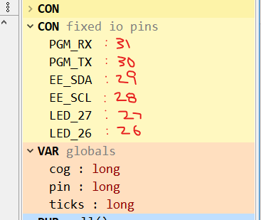

I noticed in the outline view that when you open a VAR section it will tell you the type, but when you open a CON section the values aren't provided. Since the view of the outline and the view of the code editor can be in different places, it might be useful for CON blocks in the outline to display the symbol values when opened.

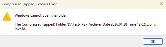

Possible gremlin in 0.52.1 (and also 0.51)...
OBJ
uart : "jm_fullduplexserial.spin2"
An archive created when the .spin2 suffix is included at the OBJ definition appears broken.
Windows throws an error and cannot open the zip. As does 7-zip.
Chrome can preview inside the zip, and it shows a double suffix on the packed file: jm_fullduplexserial.spin2.spin2
I assume that double suffix is the clue.
Removing the .spin2 from the OBJ declaration resolves it.
-- might be user error; I thought adding the suffix to filenames was OK in the past, but maybe that changed, or I dreamt it?
