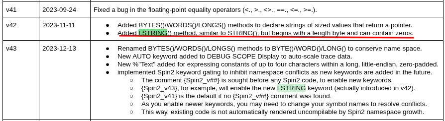

  • @Rayman said:
    Guess would be nice if could do sizeof(name[0].namefield) for the STRCOPY bytes. Is there some Spin2 equivalent of that?
    perhaps this is what you're looking for? Been playing with these a bit. seems like a "Pascal String" to me
