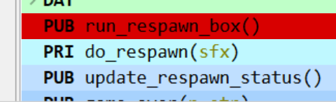

Darn. I was really hoping the color for sections and highlights could be found in the .spin-tools configuration file. I have a very big P1 project with 3000+ lines and would love if the make the line maker in the outline view more obvious. Had I found the colors in the configuration file I was hoping to go from this:
to something like this
As it's awards season here in Hollywood, the phrase "For your consideration..." is used quite a lot. I'm hoping that if user-definable colors come to Spin Tools that the outline highlight can be customized, too.
