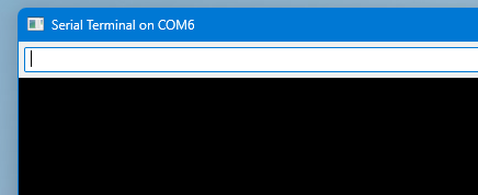

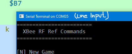

    Oof... I spent all day chasing my tail, rewriting code, and doing a lot of swearing. It finally occurred to me that the terminal was set to Line Input mode. Aargh!!! I was trying to use it the way I've always used PST: just press a key. This is on me, but maybe myself and others can be helped down the line.
    Request: Would it be possible to add " (Line Input)" to the title bar of the terminal window when it is in that mode as a reminder to us mortals that the terminal may not be configured they way we think it is?
    Would it be possible to reassign the F12 key so that it invokes PST instead of the internal terminal?
    Sorry, I think I understand what happens:
    When the line input mode is enabled there is a text box at the top of the terminal window:
    However I just realized that it doesn't work like PST, with PST each key is sent immediately while in Spin Tools the whole line is sent when Return/Enter is pressed. For some reasons I was sure that PST wasn't sending the keys immediately.
    With the line input disabled there isn't a text box, there is a blinking cursor and the keys are sent immediately. In your screenshot there isn't the text box so I think the line input is disabled, all keys should be sent immediately, if that's not what happens there is something else.
    Since the line input mode was meant to "emulate" PST I think that I can fix the key typing and rename the option as PST Mode, there won't be any line input mode unless this is actually useful for someone. I need to verify what the history does in PST (becase seems it does nothing...).
    Not now, maybe with a key shortcut customization option but is not easy. For now you can use the external tools.
