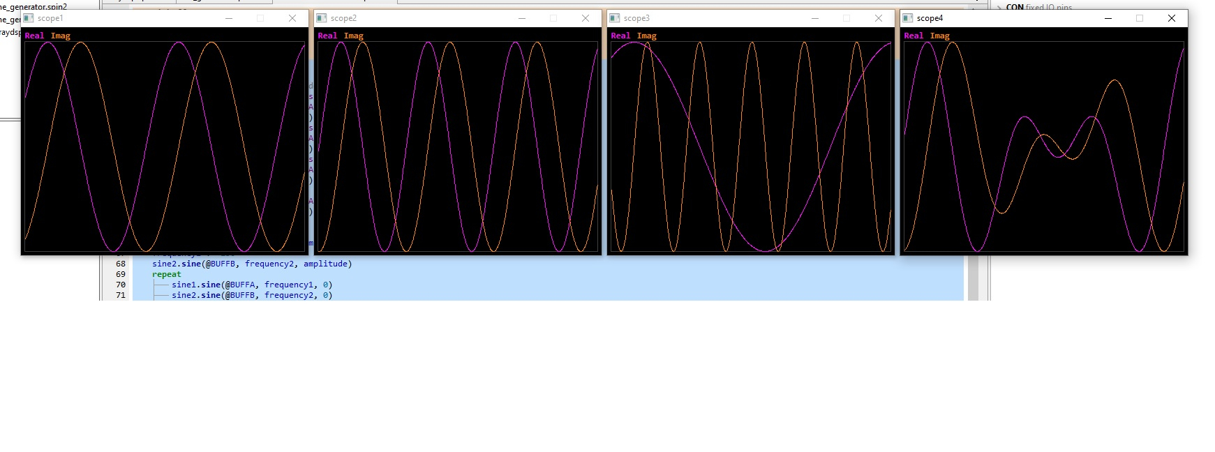

    Anyway - having lot's of spare time as a retiree I scribbled this out:-
    1. One cog permanently runs a task scheduler responsible for starting other cogs as required via coginit
    2. The scheduler repeatedly runs two schedules each held in a structure. The two schedules do not remain in sync:-
      (a) Realtime schedule - all rt tasks in this schedule will complete within the specified rt period
      (b) Non-realtime schedule - all non-rt tasks will complete as soon as possible
    3. To use all 7 cogs as effectively as possible is not easy, but this is simple (maybe!)
      (a) 1 - 7 rt tasks can be launched immediately, one task per cog. No further rt tasks are launched until all current rt tasks complete. This is to ensure any results calculated are complete before later rt tasks which
      need these as inputs are started. It's a crude dataflow implementation
      (b) A number of non-rt tasks may be launched as soon as free cogs are available. No further non-rt tasks will be launched until the current ones complete, again for dataflow reasons. The number of non-rt tasks
      takes account of the number of rt-tasks currently running and the number of rt-tasks about to run next, so as not to leave rt tasks short of cogs - ever.
    4. Thus adding more non-rt tasks as extra features become desirable does not affect rt performance. It does slow down current non-rt performance
    5. Particularly designing the rt task schedule, it's essential to know everything will complete within the rt period. A simple tool that immediately came to mind was a mechanical cad package - I use something free called sketchup.
      (a) The rt period is drawn as a tall rectangle - it's width is set to represent the rt period
      (b) Each rt task is a short rectangle whose width is set to represent the rt task worst case duration
      (c) The rt tasks are fitted inside the rt period rectangle
      (d) The rt tasks are arranged horizontally in the order they need to be processed in. Where rt tasks are not dependent on each other for data, then these can be arranged vertically to run simultaneously in several cogs
      (e) Labelled lines can be fitted to show dataflow dependencies to check all data is calculated before it is needed as an input later
    6. Non-rt schedule is designed similarly, but timing is much more variable depending on how many cogs you have left it to do it's job
    7. Looks like debug in P/NUT would be very useful to check whether you were getting the sequencing you required in the above.
    Waddayathink?

  • The Multus Proficio I included as a picture is designed to connect to a PC via USB. The USB link handles both control and signals. I include it just to get some idea of the hardware needed. You can see the 5W power amplifier transistor on it's heatsink that is part of the transmitter

    So I finally got round to writing some code. I've chosen to make 'inline pasm' for SPIN2, because it neatly supports calling the dsp functions with parameter and local variables. Whether a practical dsp application could be written with Spin gluing everything together like that remains to be seen. Whether compiling the SPIN to machine code would be useful is something else to try.
    It's certainly a very pleasant test bed for debugging dsp functions - the 'scope' displays are invaluable. Pnut is slow to display, Spin Tools is a lot faster. Both are quite usable.
    Directions:
    1. Unzip the code to it's own directory
    2. Load mix and modulate.spin2 into your ide of choice (tested on Pnut and Spin Tools)
    3. Run with ctrl- F10
    Scope 1 is a 100 Hz iq sinewave generator
    Scope2 is a 150 Hz iq sinewave generator
    Scope3 is the result of modulating these two signals
    Scope4 is the result of mixing the two signals
    Whilst coding, I display two pdfs I made of 'Propeller 2 Assembly Language' and 'Spin 2 Language Documentation' which adds a clickable contents strip on the left hand side. I also open @Wuerfel_21 's 'Propeller 2 Docs' with it's 'hyperjump'. You can usually find what you're after pretty quickly, with those.
    So - it's the beginning of an array based dsp library, which I'm hoping will be useful for software radio. I think next is to adapt the HDaudio driver to input and output to my signal buffers so I can feed in real signals and hear the results. I bought the HDaudio add-on set before Chistmas. I'll also make some measurements on the time spent in SPIN versus the time spent in PASM code, to see if that ratio is at all tolerable. With the PASM functions working on 1024 samples at a time (rather than a single sample at a time) I'm hopeful.
    Cheers, Bob
