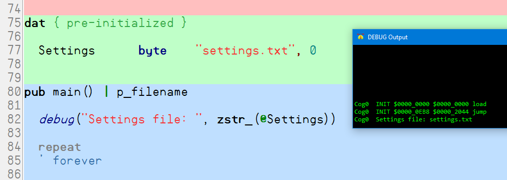

@ersmith Couple debug questions...
First, ZSTR doesn't seem to work like this, should it?
debug("bitmap read into psram...", ZSTR(pFilename))It works words with Spin Tools but gives blanks here...
Second, in a fairly complex code, it is getting broke when "BRK Debug" is enabled.
Any clue as to why that would happen?
It seems like one of the cogs isn't working...
Confirmed:
CON _xtlfreq = 20_000_000 _clkfreq = 10_000_000 PUB tester() debug(udec(clkfreq),uhex(clkmode)) debug("bitmap read into psram...", ZSTR(pFilename)) repeat DAT pFilename byte "test.bmp",0Hmm, doesn't work in Pnut either. I get a garbage string, I must be using it wrong...
I think you need @ to create a pointer for zstr
are you using
-gor-gbrkswitch?The former is known to be a bit funny, the latter would be surprising, I'm pretty sure that worked?
Thank you Jon. Now works in both Flexspin and Pnut.
-gbrk is used
CON _xtlfreq = 20_000_000 _clkfreq = 10_000_000 PUB tester() debug(udec(clkfreq),uhex(clkmode)) debug("bitmap read into psram...", ZSTR(@pFilename)) repeat DAT pFilename byte "test.bmp",0@Wuerfel_21 Using the IDE, so not sure…
ahh, that.
Incorrect hungarian notation tripped me up.
