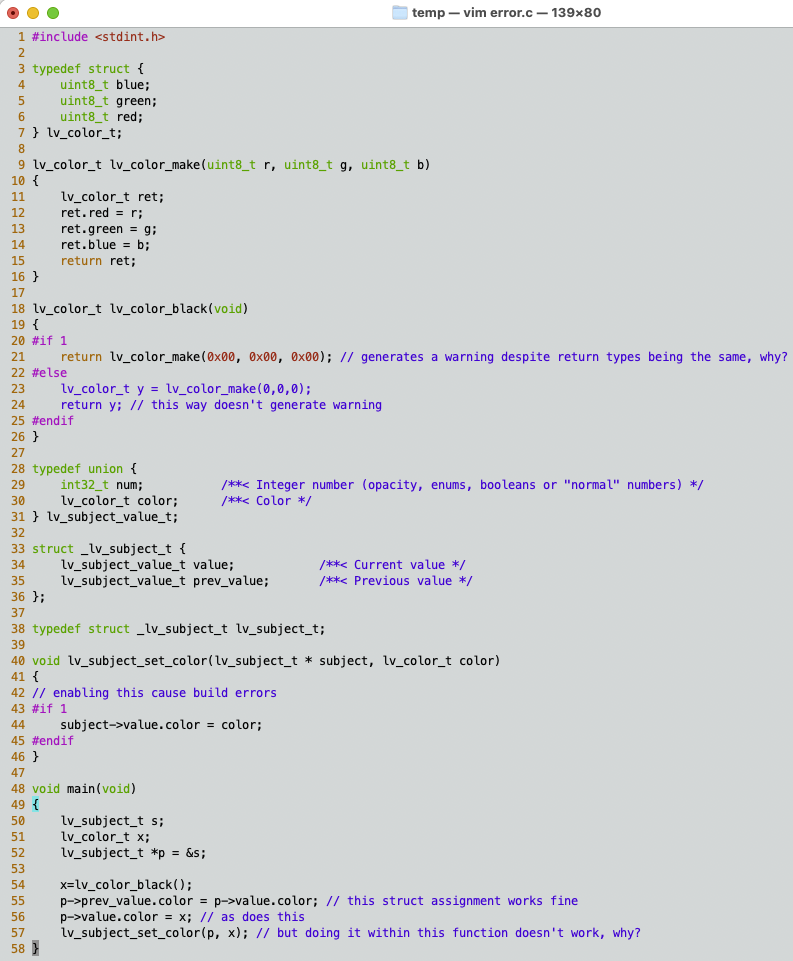

    So I'm (optimistically) trying to build the LVGL project with flexspin and am running into many build problems. Here's one of them:
    Is there a known reason why this example code doesn't work? I've pared it down from some failing source and put it into the single attached file if anyone wants to reproduce it, as well as a screenshot with numbered lines shown.
    I have two issues here. Some strange warning when returning a value from another called function in the calling function's return statement. Types match so I'm not sure why it complains. And also a bunch of build errors happen if I try to assign struct members from pointer dereferencing within a function, but yet it's okay when the same thing is done from main() using local variables instead of arguments...? I'm using v7.6.2 of flexspin here if that mattered. Plus why does it report the same thing multiple time for the same line? Maybe a bug? If so, can it be fixed. Assignments like this are scattered all thoughout the LVGL codebase and are reasonably common for C, it's not that exotic. Almost seems like flexspin is not maintaining all the structure/return types correctly or something like that perhaps and is getting confused as to what can be assigned to what. This is just one category of error I'm seeing but it's fairly common in the codebase. I think cleaning it up may help get a lot further with the build, if it's a bug with the type storage. The full list of source code problems is also attached (as warnings.txt and errors.txt) for reference and much of it relates to types.
    ❯ flexspin -2 error.c
    Propeller Spin/PASM Compiler 'FlexSpin' (c) 2011-2026 Total Spectrum Software Inc. and contributors
    Version 7.6.2 Compiled on: Mar 2 2026
    error.c
    /Users/roger/Documents/Code/temp/error.c:21: warning: incompatible pointer types in return: expected unknown type but got reference to unknown type
    /Users/roger/Documents/Code/temp/error.c:44: error: Expecting identifier after '.'
    /Users/roger/Documents/Code/temp/error.c:44: error: unknown identifier expression in class _struct___anon_9b3f68f60000001c
    /Users/roger/Documents/Code/temp/error.c:44: error: assignment to constant value
  • roglohrogloh Posts: 6,390
    edited 2026-03-12 22:23
    Also I found that when I provide a different/unique local name the problem I have in the post above doesn't occur and the build compiles okay. This is not good if we need unique names for struct members and function arguments. It's a lot of work to try to find all these in a large port using lots of structs.
    #if 0  // enabling this code cause build errors
    void lv_subject_set_color(lv_subject_t * subject, lv_color_t color)
        subject->value.color = color;
    #else // but this variant has no error if using a different local paramater name to the field in the struct?  What?
    void lv_subject_set_color(lv_subject_t * subject, lv_color_t color_)
        subject->value.color = color_;
    #endif
  • ersmithersmith Posts: 6,284
    @rogloh it looks like there's a fairly fundamental problem in flexspin with the parsing of multi-level method references (like a->b.c). But it's a weird error that's hard to pin down, as it is context dependent. I'll keep looking for it, but I don't know how long it will take to figure it out and come up with a fix.
    Thanks for the bug report!

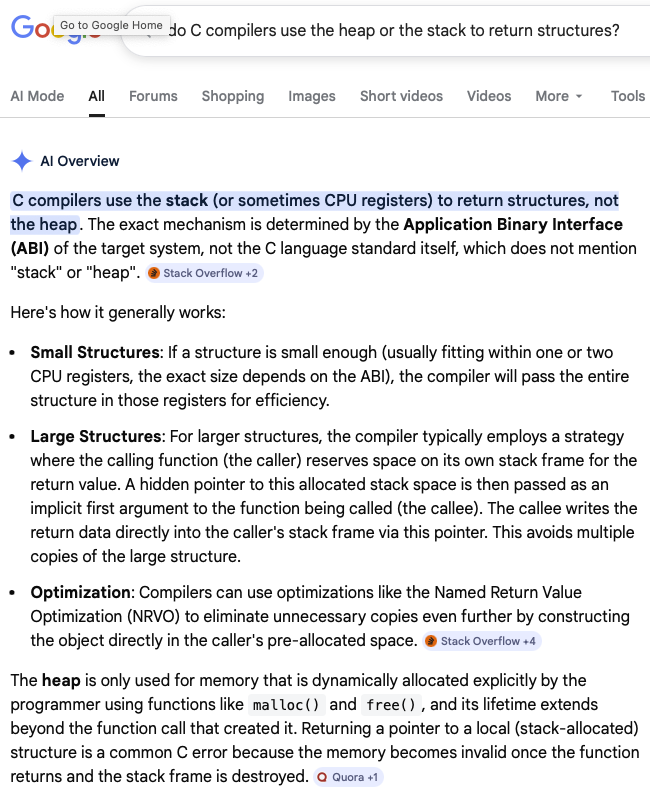

    One other question I have and perhaps something that could be altered to improve performance is related to the passing of structs as function return values. In looking into the disassembled function in my post above that related to the warning about unknown types:
    I found that the code it generates includes writing to the heap.

    For a function that returned a 3 element structure it seemed like a whole lot of extra work is done and this need to use the heap was really unexpected, as it would add quite a bit of additional overhead on each invocation of the function whenever it returns a struct. I know in general it's not all that efficient to pass and return structures to/from C functions because a copy is required and it's typically better to use pointers to read/write struct members, but I didn't realize that flexspin would need to use the heap for doing this and need to lock memory and garbage collect etc.
    Most of the C compilers I've used would typically use the stack to propagate the struct. When I googled this "do C compilers use the heap or the stack to return structures" I got this:
    Now perhaps there is a way using the stack and local variables to return a struct that is more efficient than all this heap oriented code. I know the struct variable is created on the stack initially and ultimately needs to be copied to somewhere else back at the assignment statement of the caller. If you keep an intermediate COGRAM variable to point to the address that will accept the struct return value (which itself gets preserved on the stack for each level called like these 3 existing variables below do), you could then at return time do the copy from the callee's stack back to the caller at the correct location. Also if the function returning a struct is called and is never assigned to something, this destination pointer variable could just be passed as a NULL pointer which is checked before the copy happens. Obviously there are extra requirements related to keeping track of space for this in the stack frame of each function but seems like this type of approach is the better option for performance and only a single block copy is ever needed per return and no heap use and just one more element passed on the stack frame like the 3 below (one extra clock cycle for each setq transfer in pushregs and popregs and one extra COGRAM long). It's gotta be a lot faster this way, surely.
    What are your thoughts on this, and do you know why the heap was chosen instead of the stack? If you actually step through the entire amount of code that executes on the copying of this struct via the heap you'll see just how many extra functions need to be invoked. It's amazing to see in the code. You'd not want to ever call this underlying function in some inner loop.

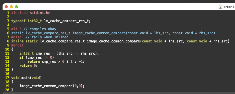

    @ersmith Here's another compilation problem I found with flexspin in my LVGL build that I've pared down to something even simpler. This C code compiles okay when defined as a static function, but enabling the "inline" modifier makes it fail to detect the correct types and the compilation fails with the following error.
    error.c
    /Users/roger/Documents/Code/temp/error.c:13: error: incompatible types in return: expected function of 2 args returning int but got int
    /Users/roger/Documents/Code/temp/error.c:19: warning: Bad number of parameters in call to image_cache_common_compare: expected 0 found 2
    Why does it think there should be 0 parameters passed when it's inlined?

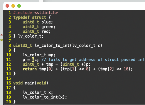

    Here's another one. Can't seem to get the address of a structure passed to a function. Error report seems to think it's getting passed a structure not an address but I'm using the & operator in the expression so it should be an address.

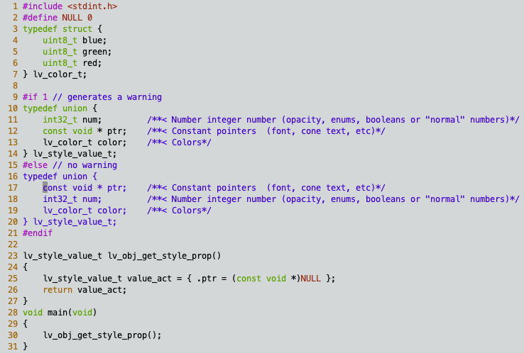

    @ersmith Here's something that may be related to flexspin warnings generated during types checks when using unions and seems like a (minor?) bug. Looks like the check is only being applied to the first member of the union, and a warning is generated if an assignment is made to another member of the union with a different type. If I change the #ifdef to enable the second version it seems okay and does not generate a warning. In any case I found that the code generated is the same in both situations regardless of the warning.
    error.c
    /Users/roger/Documents/Code/temp/error.c:25: warning: mixing pointer and integer types in assignment: expected int but got pointer to const void unknown type

  • evanhevanh Posts: 17,258
    I suspect the problem is the attempt to pass the whole struct, rather than a pointer to the struct, as your function argument. That's probably one of those bloaty things that can be done in C++.
    edited 2026-03-14 04:46
    @evanh said:

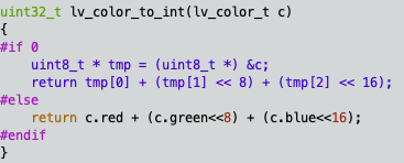

    The complaint is on the line where it tries to get the address of the passed struct (ie. function's local copy). Passing the struct itself to the function is okay.
    Note: I changed the code to this instead to fix it.
    With various code tweaks I've fixed a lot of these random problems except for the myriad of dreaded:
    error: incompatible types in assignment: expected _struct___anon_98b868fb0000006d but got _struct___anon_d2d368f40000006d
    and
    error: incompatible types in assignment: expected _struct___anon_98b868fb0000006d but got unknown type
    type of error which I still don't know why are happening. If that problem can be resolved it may compile ok, or at least get to the next step.

    dest AST left tree:
        dest 2 left kind=51
            dest 3 left kind=54
                dest 4 left kind=4
    But when I modifed the test C code to improperly assign the local struct directly to the pointer without an address of operator, I just get the exact same result below. It's as if the address operator (&) is not being parsed correctly into the AST tree somewhere. You may possibly know where this should happen and whether it's a bug in the parser code or some other issue.
    uint32_t lv_color_to_int(lv_color_t c)
        lv_color_t *p = c;
        return p->red;
    You can see it's the exact same set of type numbers used in the AST tree. It's like the & has had zero effect when constructing the tree.
    83= AST_PTRTYPE,
    54= AST_OBJDECL,
    51= AST_OBJECT,
    4= AST_IDENTIFIER
    /Users/roger/Documents/Code/temp/error.c:11: error: incompatible types in assignment: expected pointer to _struct___anon_9b3f68f600000002 but got _struct___anon_9b3f68f600000002
    dest astkind=83, src astkind=51
    src is not a pointer type
    src AST left tree:
        src 2 left kind=54
            src 3 left kind=4
    dest is pointer type
    dest AST left tree:
        dest 2 left kind=51
            dest 3 left kind=54
                dest 4 left kind=4
    Cheers
    Roger.

    @rogloh said:
    @ersmith I may have found something.
    So I dug into this frequent error a little more:
    I wanted to see what is going on so I modified flexspin's frontend/types.c code slightly to output some extra debug where it happens in the code to print the left side of the AST tree for both the source and dest AST's used in the assignment statement (right side of the tree seemed to remain empty in this case so I left it out).
    Thanks for digging in to it so deeply! I think what's happening here is that one part of the code is trying to pass the structure by value, because it's a small struct that fits into a register. But another part of the code wants to pass it by reference, because accessing the individual members (uint8_t) requires memory access -- getting at the individual bytes of a register is slightly complicated for the compiler (mostly for historical reasons and for P1 compatibility). The by-reference side is silently converting the &c back into a regular c (because under the hood a reference c is really a pointer) whereas in fact c is just a regular variable.
    One thing that might serve as a work-around is declaring the struct as having bitfield members, like:
    typedef struct {
        unsigned blue:8;
        unsigned green:8;
        unsigned red:8;
    } lv_color_t;
    Those are handled in a radically different way by flexspin because (IIRC) taking the address of a bitfield is forbidden, so we don't have to worry about producing a pointer like &foo.blue.
    Regards,
    Note that there's a DumpAST function you can use that prints out the given AST in an XML-like manner.
    Thanks Ada, that's useful.

    @ersmith said:
    typedef struct {
        unsigned blue:8;
        unsigned green:8;
        unsigned red:8;
    } lv_color_t;
    Regards,
    Eric
    Ok thanks Eric. I'll try this. There were a LOT of flexspin errors related to this particular lv_color_t structure so it may get rid of a lot of them in one go with any luck.
    EDIT: nope, doing that didn't change any of the errors unfortunately. It's the exact same set of errors/warnings I get before I changed it to use bitfields.

    @rogloh said:
    @ersmith said:
    typedef struct {
        unsigned blue:8;
        unsigned green:8;
        unsigned red:8;
    } lv_color_t;
    Regards,
    Eric
    Are you sure you used the exact syntax:
    typedef struct {
        unsigned blue:8;
        unsigned green:8;
        unsigned red:8;
    } lv_color_t;
    i.e. no uint8_t anywhere in there? Because when I tried that it drastically reduced the number of errors on the samples I tried it on (some of the simplified ones you posted).

    @ersmith said:
    @rogloh said:
    @ersmith said:
    typedef struct {
        unsigned blue:8;
        unsigned green:8;
        unsigned red:8;
    } lv_color_t;
    Regards,
    Eric
    typedef struct {
        unsigned blue:8;
        unsigned green:8;
        unsigned red:8;
    } lv_color_t;
    Er, I'll need to retest that - I must have missed the change from uint8_t to unsigned part - I think I just had the uint8_t with the bitfields. Will report back here in a bit.
    UPDATE: I may need to retest on a fresh tree now as since then I've changed a bunch of code to try to reduce the errors using code changes like this:
    void lv_obj_set_style_outline_color(lv_obj_t * obj, lv_color_t value, lv_style_selector_t selector)
    +#if 0
         lv_style_value_t v = {
             .color = value
    +#else
    +    lv_style_value_t v;
    +    v.color = value;
    +#endif
         lv_obj_set_local_style_prop(obj, LV_STYLE_OUTLINE_COLOR, v, selector);
    and the unsigned + bitfield change actually increased the error list from 380 to 447 and reduced warnings from 766 to 679.
    Did you test on the LVGL tree with or without my changes applied?
    Okay I also just tested on a fresh LVGL v9.5.0 tree without my other changes, so it's just the lv_color_t change in isolation. I observed the same thing. Warnings went down and errors went up.
    Testing a clean v9.5.0 tree with just the lv_color_t change (i.e using an unsigned bitfield instead of uint8_t for red/green/blue):
    ❯ grep ": warning" errors | sort | uniq | wc
    694 11834 155749
    ❯ grep ": error" errors | sort | uniq | wc
    520 5667 82728
    Original baseline v9.5.0 tree without ANY changes applied:
    797 13446 174048
    469 5290 66830
