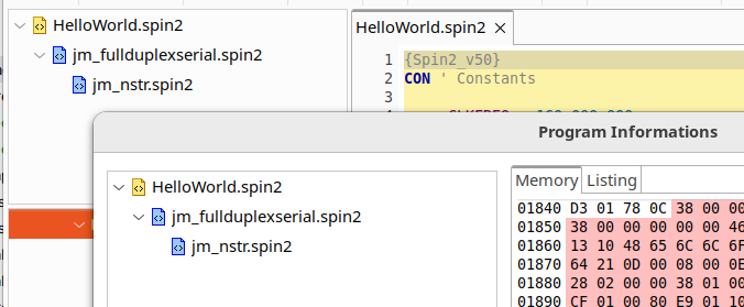

A niggly thing... It would be nice if there were more contrast between the icon colors in the object tree. Would it be possible to use the folder icon colors from Propeller Tool? I poked around your GitHub repository and found that those icons are 16x16 PNGs. In the spirit of imagining you saying, "Help me help you" (great line from the movie, Jerry Maguire), I downloaded the object tree icons and made versions that use Propeller Tool colors. They're a bit simpler with less shading, but I think this will help the contrast so that identifying local versus library files will be easier.
I have added your icons, seems good to me:
I'll use them in the object tree only, the file browser still uses the current icons to be consistent. Maybe it would be good to better highlight the spin files, however I would like to keep the color gradient style.
Just for info, I'm using the Fugue Icons from https://p.yusukekamiyamane.com/ there is also the PSD source, however it doesn't import correctly with Gimp (even the latest version 3.x has problems).
