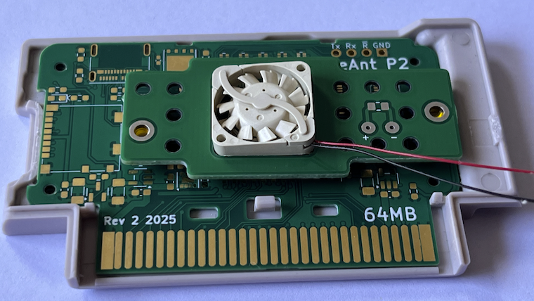

How would you mount a fan, if needed? Would having at least a couple of 2mm holes make sense? Even if too big for the 3mm thick fan, it'd allow some kind of adapter plate. There are also a smaller series of solnet nuts from Pemnet, to suit M1.6 screws and similar. Diameter is around 3.7 or 3.8mm from memory
Yeah I was planning to add some mounting holes either for a fan itself over the P2 if possible or for a bracket/PCB plate that holds a fan over the P2. I still think we'd potentially want one given the tiny volume of the enclosure, just to stir the air around and try to exhaust some of the heat. The heat building up has got to go somewhere when spread over the PCB so it's prudent to make a design that allows for a tiny fan. Plus it makes no noise and draws little current so why not include the option of having one if there's room for it. I'll also include some pads for the fan's power wires at both 3.3V and 5V since we've identified fans that run at both these voltages. I wonder if a fan would add much electrical noise to a 3.3V rail...? Maybe a LDO is needed? I was also considering a separate LDO for the PSRAMs on the other side of the board but it's probably not needed. If I have room for a footprint I may include it with some jumper option of using it instead of the main switcher.

Not quite there yet @Tubular but I think with some more shuffling and compression of part spacing I might be able to get the original solder nut size to fit the board. It won't be quite centralized like before but we might be able to modify your fan board or make another variant that accommodates the different hole offsets from the centerline. I still need to move the PSRAMs in closer too. I hope the countersunk M2's screws can fit in, there won't be a large amount of space so it's best to make this fan board a rather thin 0.8mm PCB.
I also wonder if we couldn't use simple header pins to hold it, and they could transfer the fan power too. I almost want to glue the fan within a PCB square hole cutout to gain another 0.8mm. We've only got 6mm total clearance above the board to the plastic cartridge inside surface and this doesn't include the P2 height, plus we want a small gap for air to actually flow over the P2. If the fan was mounted inside a cutout instead of screwed to the PCB plate it might give us about 1mm of gap for that (6mm-1.2mm-3.8mm = 1mm). We could shim it while gluing to provide just the right clearance. We could also drill a few holes in the cartridge above the fan and/or along the top edge for more airflow if (most probably) required. Routing out some of the inner surface of the plastic might gain us a tad more clearance if needed. Calipers measured about 1.4mm thick plastic there.
Make the back side GND, behind the Prop2, as gold flashed copper. Then a shaped heat-sink can be neatly pressed onto it for good heat-sinking. And those screw mounts could also be exposed right through to make the heat-sink be a ridged mount too. Have the back of the cartridge be aluminium. Can even give it ribs. Then a fan shouldn't be needed.

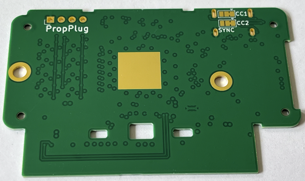

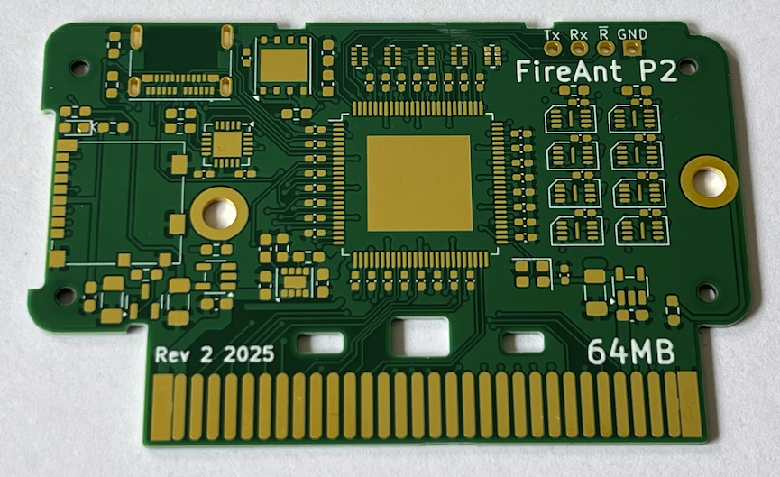

The rev 2 FireAnt P2 PCBs arrived back this morning. They turned out pretty nice and also fit inside the cartridge a little better now with some custom size tweaks I added after doing rev 1.
The gold square in the middle of the P2 is still connected through to the other layers. They've actually filled the vias so it looks solid but when I examined in close up I could see the array pattern of thermal via holes 15x15 (~75% used). I probably could have used the entire hole array since the paste can't even get through it now. The PCB manufacturer only does through hole vias so the back of the board makes it looks a little like it has caught chicken pox with the ground plane clearance of all the other non-grounded via signals on the board, lol.
Before I sent it off I also decided to remove all the component designators which will make manual assembly slightly more challenging for me but makes for a cleaner final board. The CC1/CC2 pins of the USB-C connector can be used for connecting the standard 5.1k pulldowns or can be optionally fed a composite sync for my external USB-C to VGA/HDMI PCB (which also arrived today and is shown too inside its selected enclosure). That board has had a LMH1980 sync separator circuit added to the path for VGA hsync and vsync signals (although it is yet untested), the remaining part is simply the micro USB power and PC data port, the USB-C connection to the FireAnt board and a copy of what I'd already used in the P2 VGA to HDMI breakout board originally discussed here: https://forums.parallax.com/discussion/177903/converting-component-vga-audio-to-hdmi-on-p2 The VGA video signal is now also buffered with a 3 input video amp (THS7316) before driving the VGA port so it can also be 75 ohm terminated by the MS9288A chip at the same time for output via HDMI.
