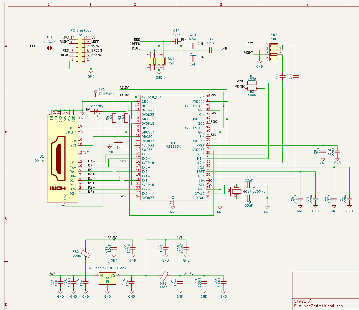

My P2 IO interface is currently:
  • HSYNC, Blue, Green, Red, VSYNC (5 pins)
  • HDMI CEC (1 pin)
  • L&R audio (2 pins)
If I2C was found to very useful I think a possible alternative 8 IO pin P2 interface could be:
  • HDMI CEC (1 pin), or Composite Sync for VGA instead of CEC - best if (solder) jumper selectable?
  • RGB or YUV (3 pins using SoG)
  • I2C SDA/SCL (2 pins)

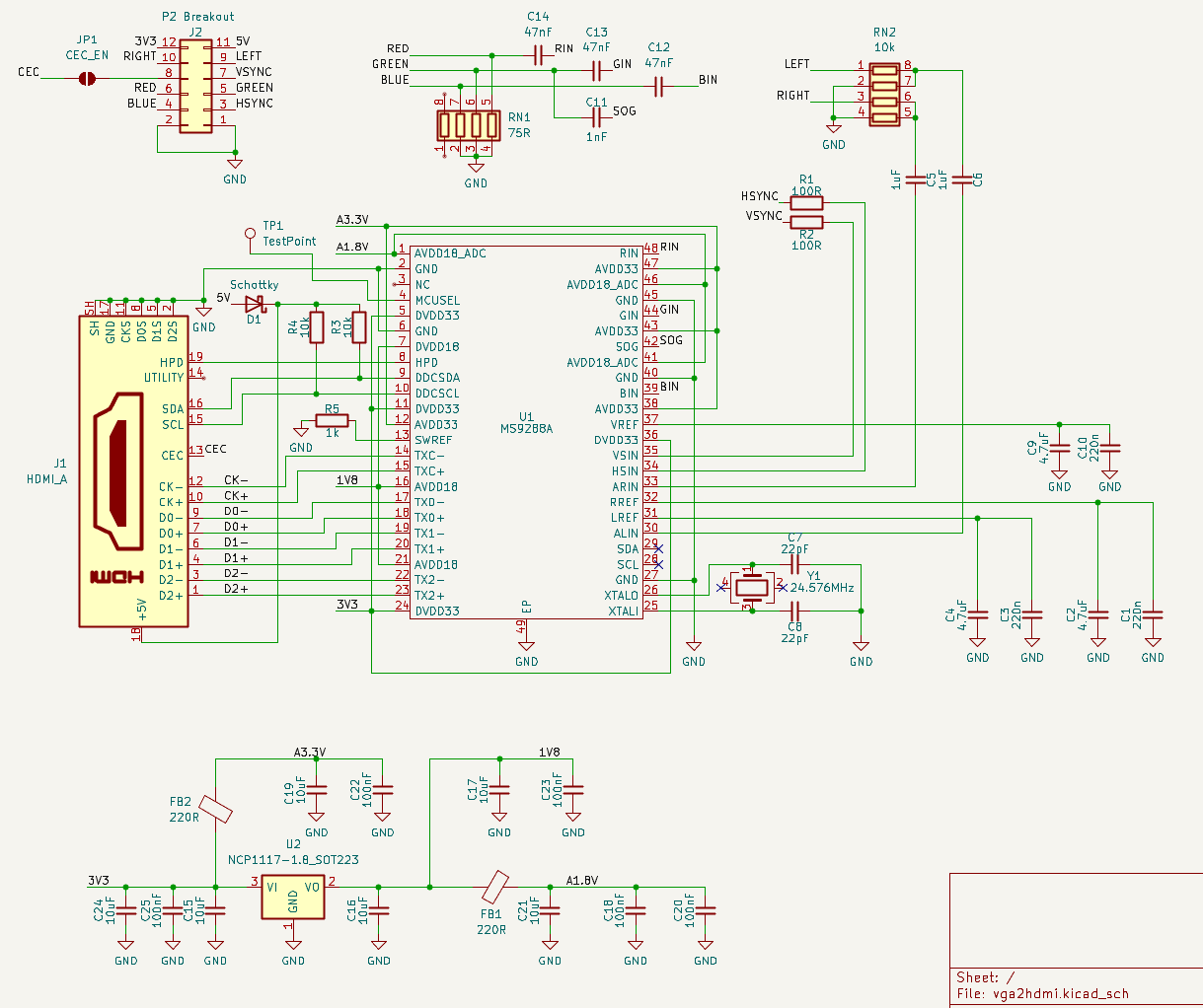

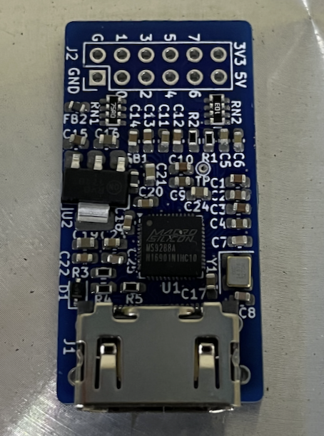

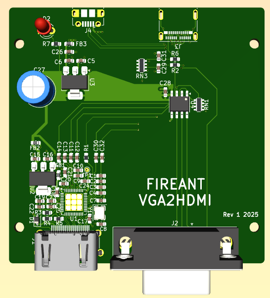

Here is the schematic I used:
EDIT: Reposted updated schematic with the capacitor value fixes.

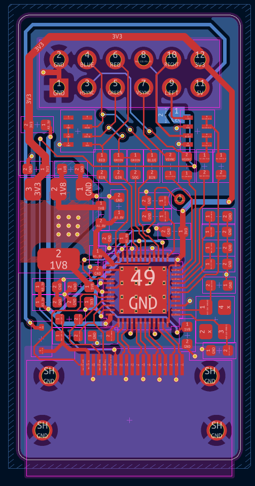

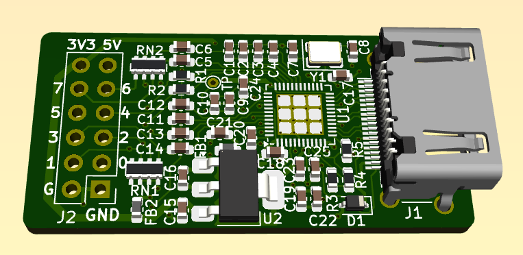

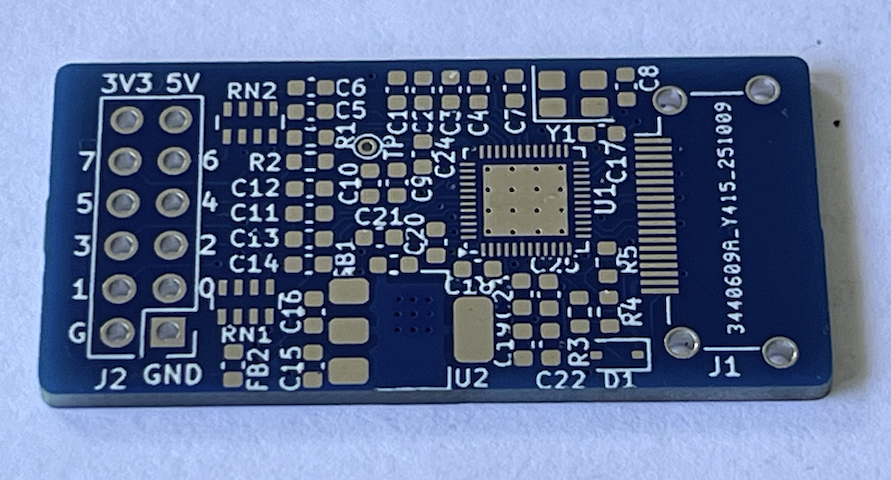

Here is the board render/layout:

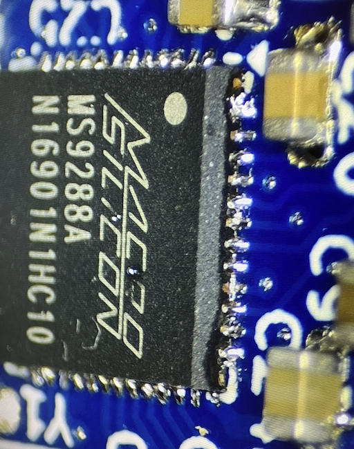

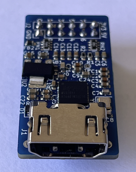

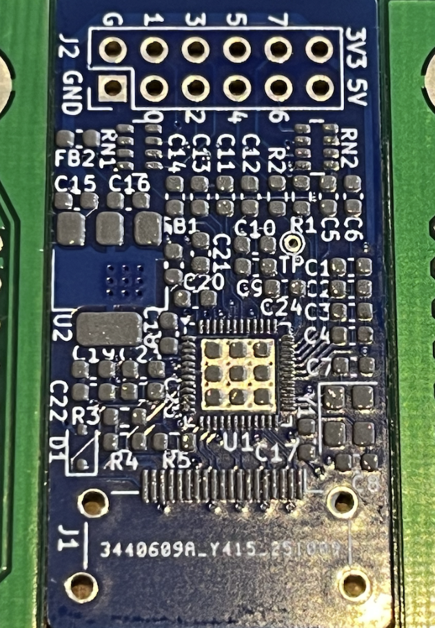

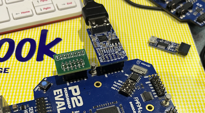

Here is the first PCB I received being populated & cooked, checked, tested:
The connections were thankfully okay and it worked fine first go including audio which I tested on a small LCD screen with HDMI and headphone jack output. I ran @Wuerfel_21 's Spin Hexagon game with it outputting to small speakers initially. I've not yet tried component or SoG, although in theory it can do that too. I've tried various typical resolutions and they all worked with my Dell monitor specifically including:

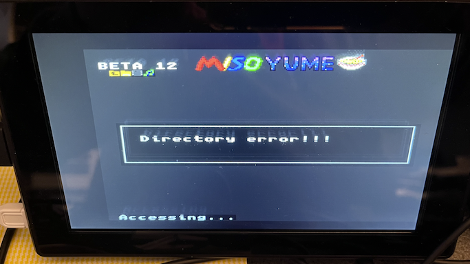

    When I tried to upgrade to your latest master branch it's now failing to detect my SD card and I see a FS Mount error now. Probably something changed underneath, I'm just using the standard P2-EVAL SD card pins and didn't mess with that in the config file before and after the update. Wasn't there some probably some days ago with some change evanh made and the checked in code being bad for SD cards or something...?

    @rogloh thanks for posting the schematic. Can't believe it's that simple... Thought for sure you'd need that i2c chip to make it work...
    Wonder if this could work for P1 too...

    Guess SOG is "sync on green"? Can that be left off? I.e., not populate C11?
  • RaymanRayman Posts: 16,449
    Actually, wait a sec... If SOG can work, that would mean could deliver video and +5V over RJ45 cable. That could be handy for the PLC type stuff been doing...

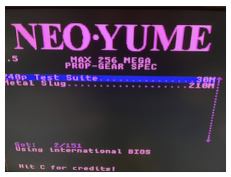

    Sorry I didn't mention which code, it's the NeoYume master branch (pulled from yesterday) that has the problem. Here's the config file I was using - with my own PSRAM board on a P2-Eval. The prior NeoYume branch that worked to prove out my setup was indeed rather old and called usbnew. After the full upgrade to the latest to test Sync-on-green etc it's now reporting a FS Mount error at the initial start up screen and nothing is shown in the game menu. I'd just changed the config.spin2 file to use the same USB/VGA/PSRAM pin settings as before (just in the new config file format). The SD pin settings are still at their defaults. Something seems to have changed in the SD card code. Could it be trying to do 4 bit mode even without the #define for that feature enabled? Or maybe I need to get a different SD card now as this is an older 2GB one (which has always worked before on the P2 - that's why I keep using it, others have had problems in the past).
    Yes it's sync on green.
    Haven't tried it without, but it's just a capacitor for the SoG input which is probably used if no syncs are detected on H&V. I suspect it could be run without if you don't use SOG but don't know for sure. If you run it, it probably needs to be connected. Green is fed to both pins. Seems harmless to keep in.
    Works without i2c, but there's no reporting of the attached device's actual capabilities of course.
    Don't see why it couldn't.
    Bear in mind if you build one the audio levels may need adjusting. That schematic has the wrong values there for the caps. I'm going to desolder and add a 1uF instead of the 1nF on those coupling caps. The 10k ladder will drop the levels by half too to prevent possible overload at 3.3V and without a datasheet I'm not sure of the MS9288A's input impedance or if this has any AGC on the front etc. It's probably designed for line levels. With the 1nF 's fitted the levels seemed somewhat low but that was on an LCD monitor's headphone output at half volume. Other systems or TV's might be louder. Will find out more when I attached to my plasma TV

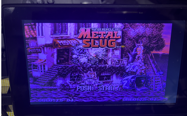

    Just tried the MODE_SoG option in NeoYume. It syncs up but like I noticed with my driver the colour levels are not good, instead of white the menu screen has a purple hue to it as well as the game itself. Also the game is offset to the left a bit now and no longer centered by default. I guess the SoG timing is behaving somehow different to VGA with this, or the LCD needs re-centering for different inputs. Might be the capacitor values again.
    The MODE_RGBS option also doesn't work at all too with the monitor not taking it and remaining black, like mine.
    The MODE_YPBPR worked (offset to the left a little again) so this proves out component. Colours looked better and fairly normal. I tried both Rec601 and Rec709 and they both worked. Also tried SUBMODE_3X with the component mode but that didn't appear to sync up at all. It did with MODE_VGA though (which was centered nicely again - pictured below). Note this LCD panel is reporting 1360x768 input but is natively a 1024x600 panel so some scaling is going on. That resolution would be nice with my plasma which is 1368x768 natively.

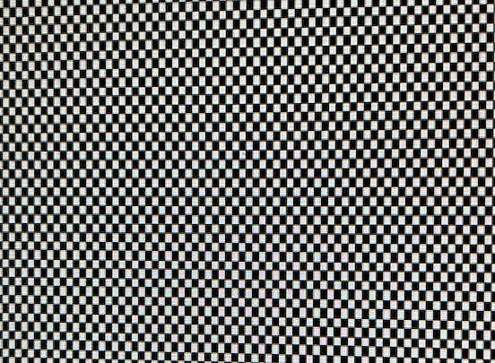

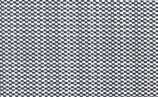

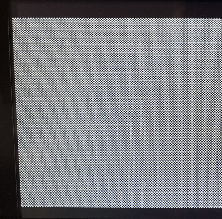

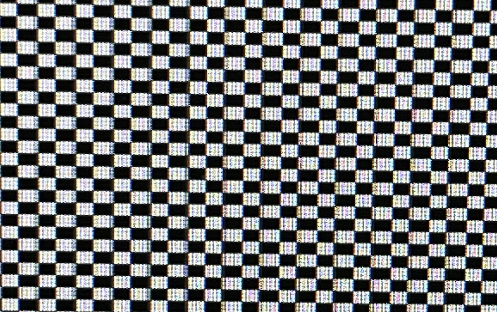

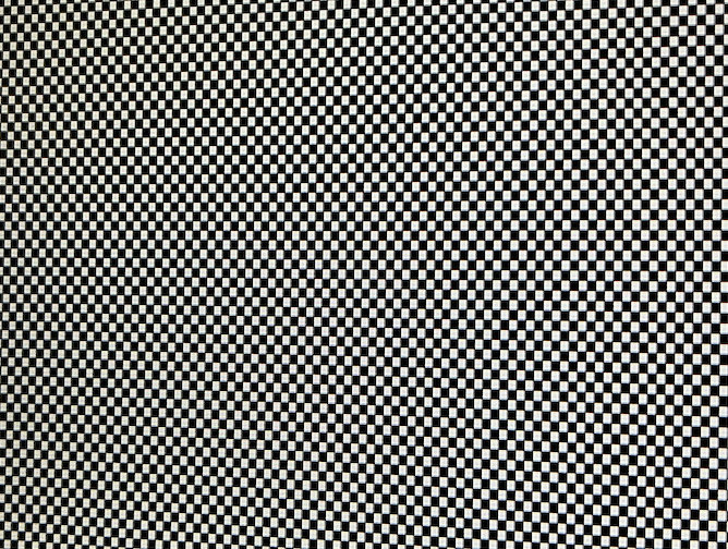

    The thing I'm rather interested in is pixel sampling.
    Can you load 240ptest and bring up the checkerboard screen?
  • roglohrogloh Posts: 6,399
    edited 2025-11-16 02:51
    @Wuerfel_21 said:
    If it looks crappy on Sync on Green and good on YPbPr, that just means it's set up to treat any soggyTM signal as YPbPr. That's what makes the signal turn purple, RGB misinterpreted as YUV.
    Good to know - could well be something on the display side too - just a cheap LCD panel.

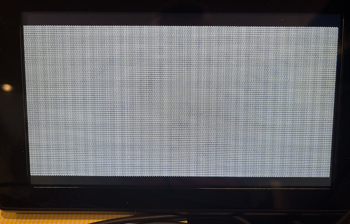

    Yeah here it is in VGA mode with 3x and shows some aliasing pattern. But remember this is scaling as well on the panel too as it's 1024x600 panel.
    SUBMODE_2X looks far better when I zoom in - mainly vertical scaling going on but it's rather subtle in real life.

  • Now try either the Megadrive version of 240ptest (in MegaYume) with the 256x224 mode or the aforementioned Trials of Mana hires font stuff in MisoYume (I think I had you mess with that earlier, you should still have the file) - those deviate from standard sample rates, so it's interesting how those'd be handled.
    edited 2025-11-16 06:03
    Will do it later...

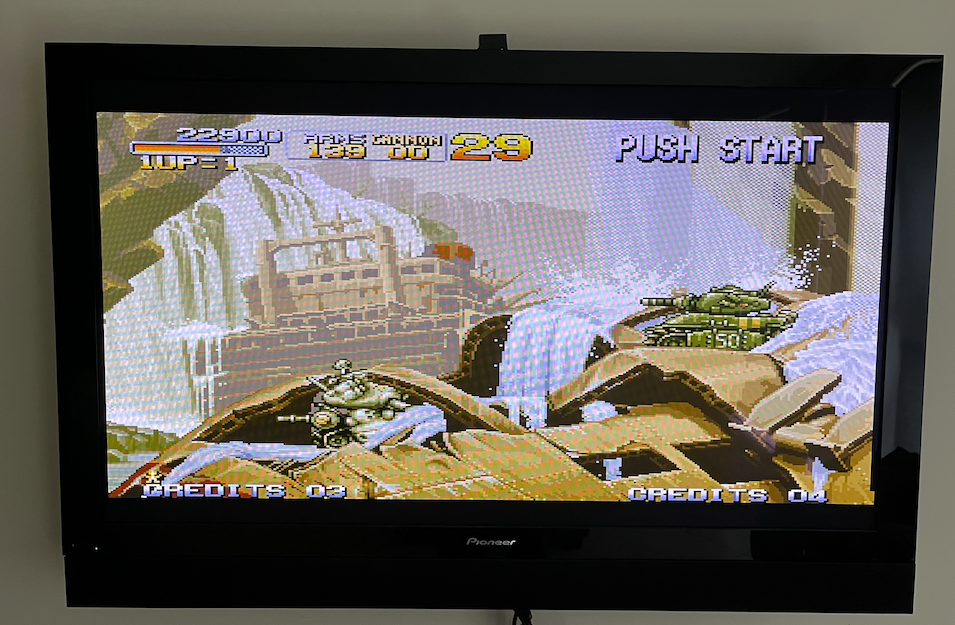

    Just retested SUBMODE_3X on plasma TV after SUBMODE_2X worked. The 3X mode actually DOES work, I just had a poor connection at the 2x6 header initially. Once I wiggled it a bit it displayed a picture. It looks pretty good. Audio is also working on the plasma TV and it's reporting 1360x768 which it's happy with. Not sure if those diagonal colour artefacts are some sort of sampling issue from the TV to the camera. Audio levels were a bit low. I think I'll now change the coupling cap to 1uF and retry then short the 10k input resistor after that to see if that helps too.

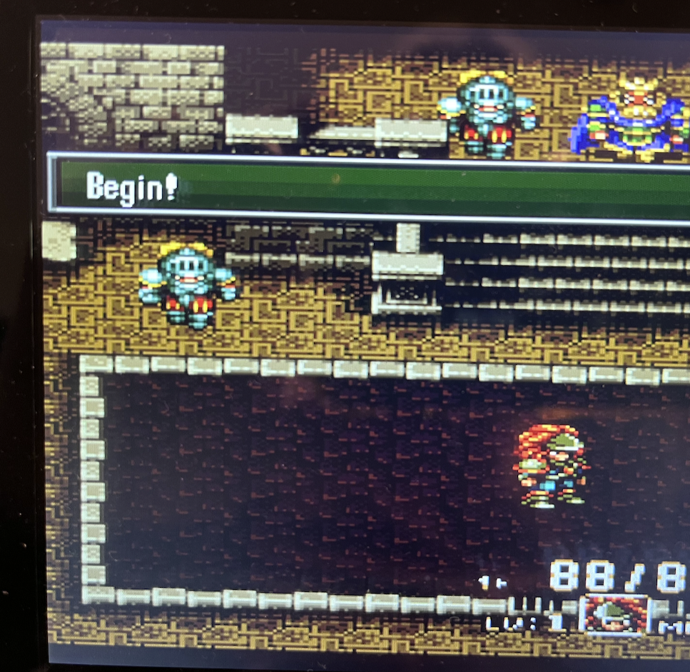

    @Wuerfel_21 Tried latest MisoYume from master branch as of today in order to look at that Trials of Mana thing you wanted - this used to work with the SD card. But getting a bad SD access again for some reason. I have files in /MISOYUME folder on that card that used to get displayed and work from an older branch, but not for this latest fresh update from github. Config.spin2 modifications attached.
  • Wuerfel_21Wuerfel_21 Posts: 5,857
    edited 2025-11-16 13:57
    Uhhh, if it works on an older version, try bisecting where it stops working.

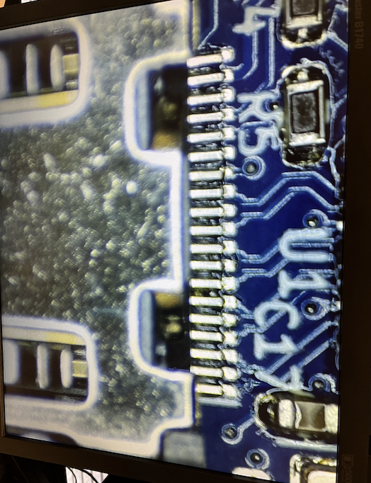

    After messing about for a couple of hours on this with older MisoYume revisions etc, I have no clue why but by moving the DIP switches to making the P59 pullup high ON (all others left off), it now works and lets me read the folder. With the P59 pullup high switch left OFF it fails every time to even read the MISOYUME folder. NEOYUME and MEGAYUME worked fine without this DIP switch set like this on the very same micro SD card, and built with the same version of flexspin.
    Must have something to do with having no electrical resistive load on this pin affecting the SD card (but at that specific named folder - weird). It's the DI pin so it would affect data going out to the card from the P2 output.

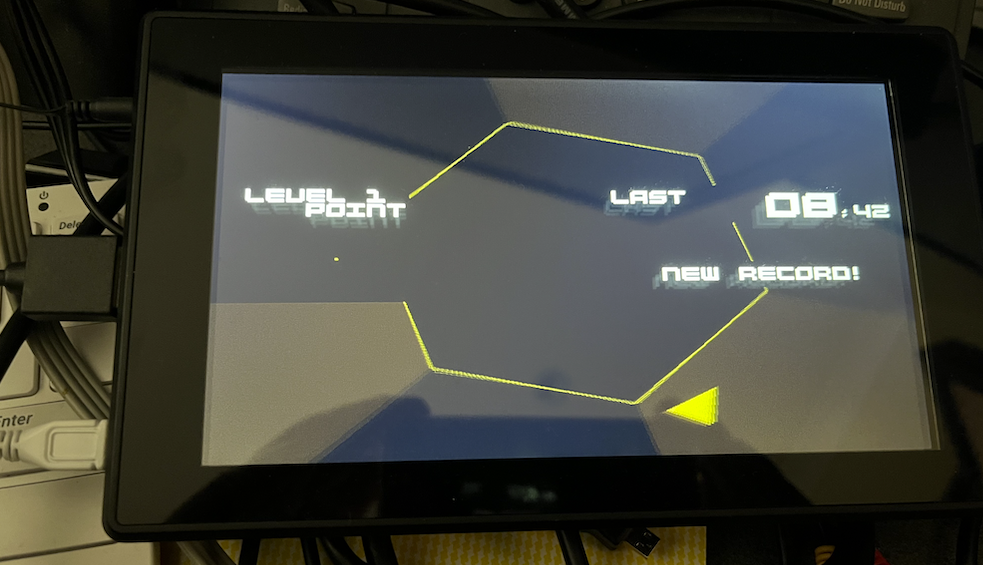

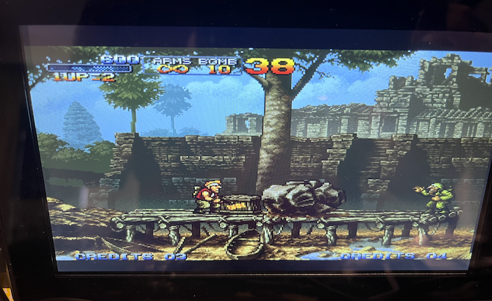

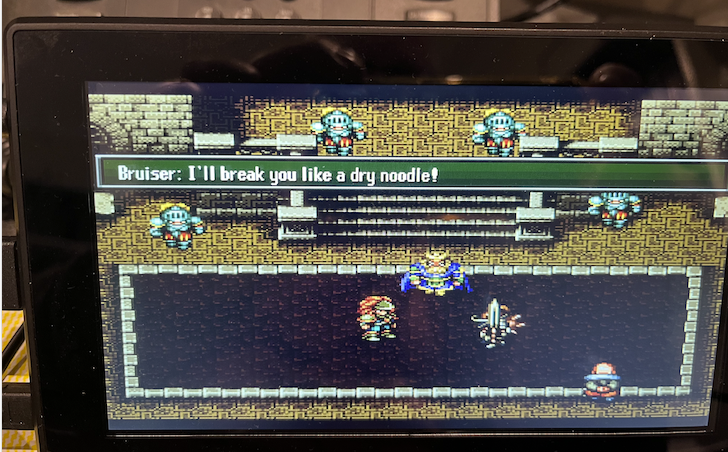

    Any ran that Trials game and captured a couple of pics from the HDMI LCD. Seemed pretty readable/clean albeit stretched to fit the screen. RGBHV & SUBMODE_2X.
