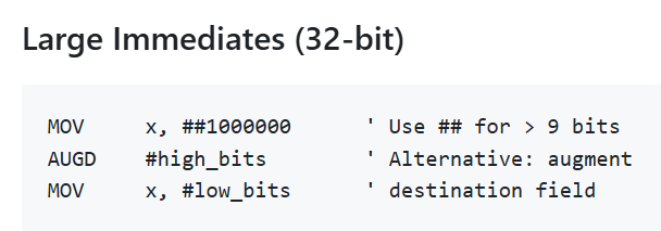

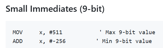

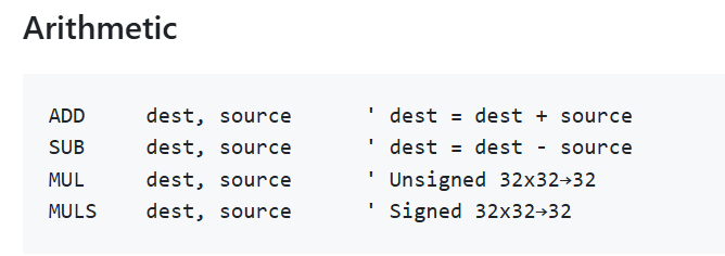

  • Oh, now that I have working links, I unfortunately can see, what @Wuerfel_21 meant. (I do think, that the wording is a bit harsh!) It is indeed a very tiny acorn right now, many and all the more tricky things are just not there.
    I don't think that AI or humans should be fed with incorrect facts.
    So, would you like to check these for example:
    From https://github.com/ironsheep/P2-Knowledge-Base/blob/main/deliverables/reference/pasm2-essentials.md :
    Is this really working like this?
    I have never used augd, but I have some doubts:
    Also PA, PB and memory alignment????
    Of course this might be once something very great. But with the acorn being so small at this moment, perhaps some smaller wording might be a good idea for the time being? Instead of:

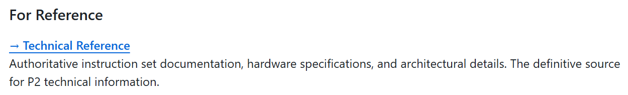

  • VonSzarvas, I have the same experience with these old links, 404, but if you go to Stephen's recent YouTube video, "Developing for the Parallax Propeller v2 with Claude Code", there is a link there to the P2 Knowledge Base. I followed that link and there are setup instructions. I had no idea what to do with them, so I copied and pasted into Claude Code on my Linux terminal. Claude knew what to do with it. It all seemed to go very smoothly and Claude says he has the P2 stuff and that we are ready to go. We will see.
  • @"Christof Eb." said:
    I still get Error 404 with your first link.
    @VonSzarvas thank you for helping me get Chrostof's point! ;-) Geez, how'd I miss this?
    The link at the top post is fixed... Thanks to both of you!

    What I'd also tried to articulate was that the 4 other links in that first post also have "bad" links. The same adjustment is required on all those too.

  • @VonSzarvas said:
    Is it possible the correct links in your first post should be adjusted? They are all 404.
    Example- I think "Repository" should be: https://github.com/ironsheep/P2-Knowledge-Base
    If you agree then I think you can edit; but let me know if any help needed.
    Okay, I think it's all cleaned up now. (I'm moving too fast if I'm leaving these kinds of things broken.)
    Thank you all for your patience!
