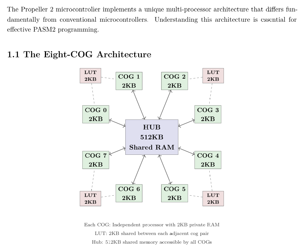

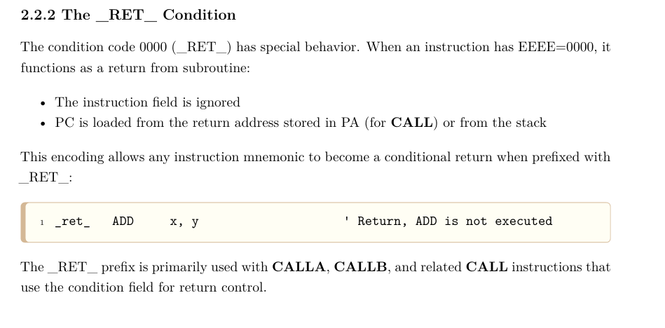

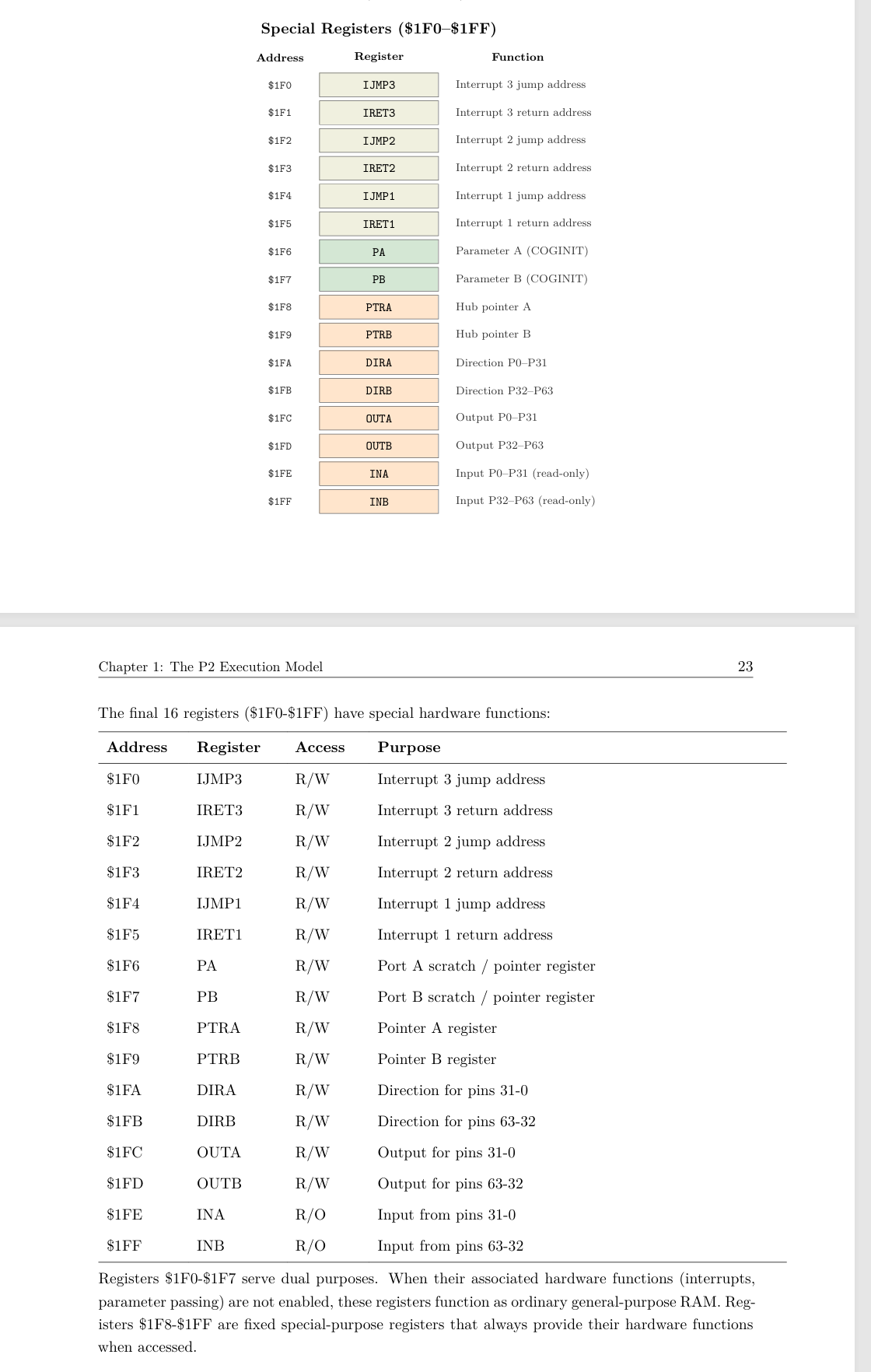

  • Wuerfel_21Wuerfel_21 Posts: 5,862
    edited 2025-09-26 00:13
    I was bored so I actually looked at your repo Stephen, and I've never seen hotter garbage in my entire life, like, wow, a true accomplishment in snatching s‌hit from the jaws of mediocrity.
    Remember here that misinformation has negative value. Especially to a clanka with no grounding in empiric reality.
    It's easy to create documentation with great coverage if the information doesn't need to be accurate, but you could use a 100% organic typewriter monkey for such a purpose and it'd be better for the environment and less easily confused with factual documentation.
    Also I don't know what you're trying to accomplish by putting text in a YAML file, I Don't Think It Works Like That. Or rather, no better than otherwise (un)structured text. I've been seeing memes about the futility of this formal-language-as-LLM-prompt approach already, lol.
