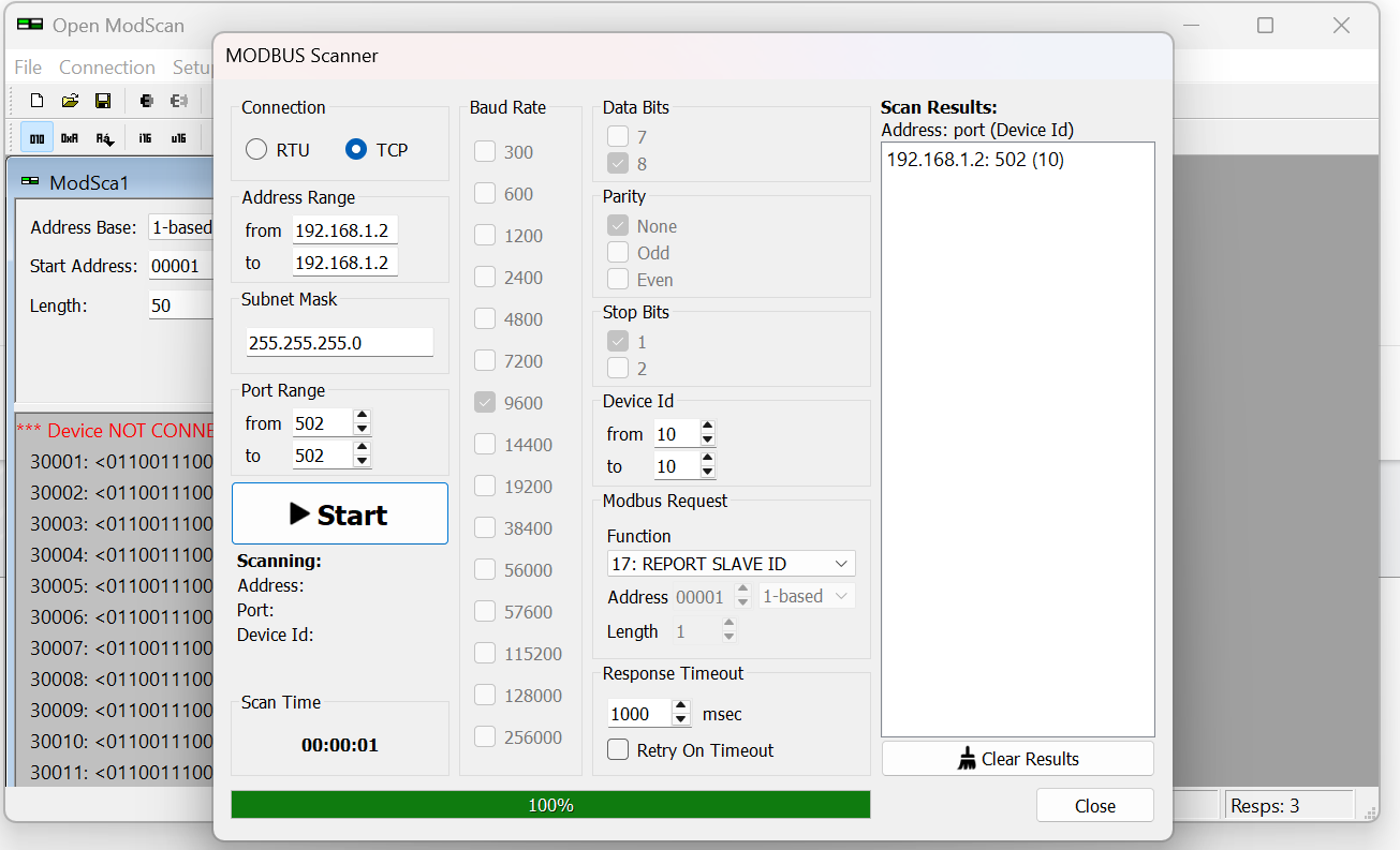

Just changed port from 80 to 502.
Tried just now to connect with Open Modscan's scanner and seeing data that makes sense.
Found a document that describes what getting from scanner:
https://www.prosoft-technology.com/kb/assets/intro_modbustcp.pdf
  • RaymanRayman Posts: 16,163
    In the above, first pinged it with function #3 (Read holding regs) and then function #17 (Report Slave ID).
    Had the code debug out all the bytes.

    This code now appears to be working with Open ModScan's Modbus Scanner in TCP mode.
    Not 100% sure if the data is correct or not yet. The regular Open Modscan interface won't let me open the socket for some reason.
    Open ModScan is happy now with the regular data interface as well as the scanner.
    TCP is pretty picky about #bytes that gets transferred, has to be exact...
