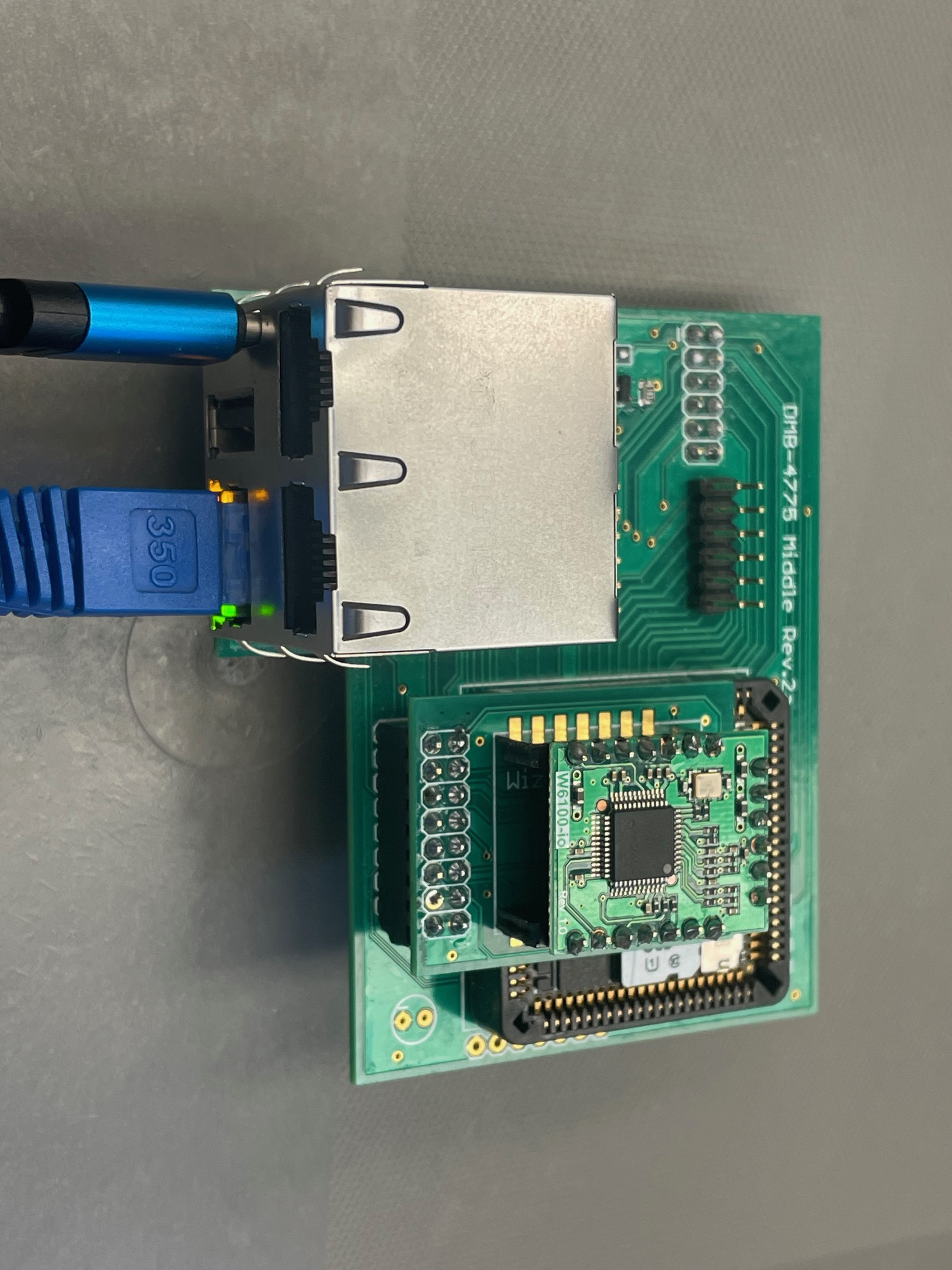

Using this with the DMB-4775 enclosure board with a special PCB for the SWaP module and a daughter PCB interface for the wiznet module.

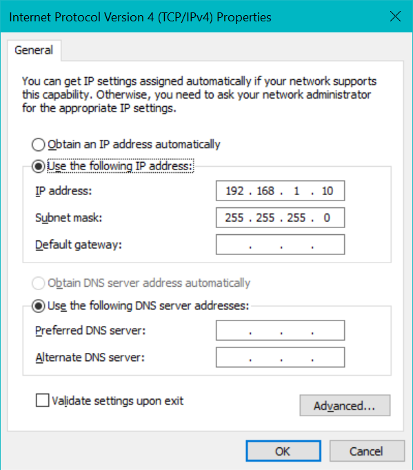

I'm directly connecting with ethernet cable to a spare ethernet port on a PC. This doesn't seem to be a DHCP server, so need to specify IP address for the wiznet here:

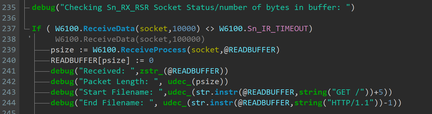

  • Ok, this was a terrible way to add a wait. For the moment, change 10000 to something larger like 25000. I am going to rework this to be a number of ms to wait before closing the connection.
    There are several improvements I have not folded into this terrible code of mine that I have made in other projects.
  • @Rayman Be sure to copy the favicon.ico file too. Otherwise the browser will try and pull it on every request instead of caching it. That may make for unexpected results.
  • RaymanRayman Posts: 16,264
    @ke4pjw Thanks. Adjusted that delay, but doesn't help...
    Wondering if browser doesn't like the index.html file...
    The favicon is showing up on browser tab, not sure how though...
    From the debug it looks like the code is seeing a request with a blank filename...

    Think found the problem!
    Commenting out the second condition makes it work:
    Repeat until FS.fileTell() == FS.fileSize() 'or W6100.isdisconnected(socket) == True
