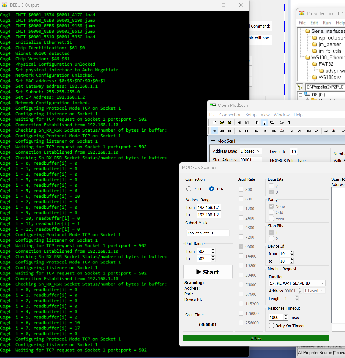

Tried just now to connect with Open Modscan's scanner and seeing data that makes sense.

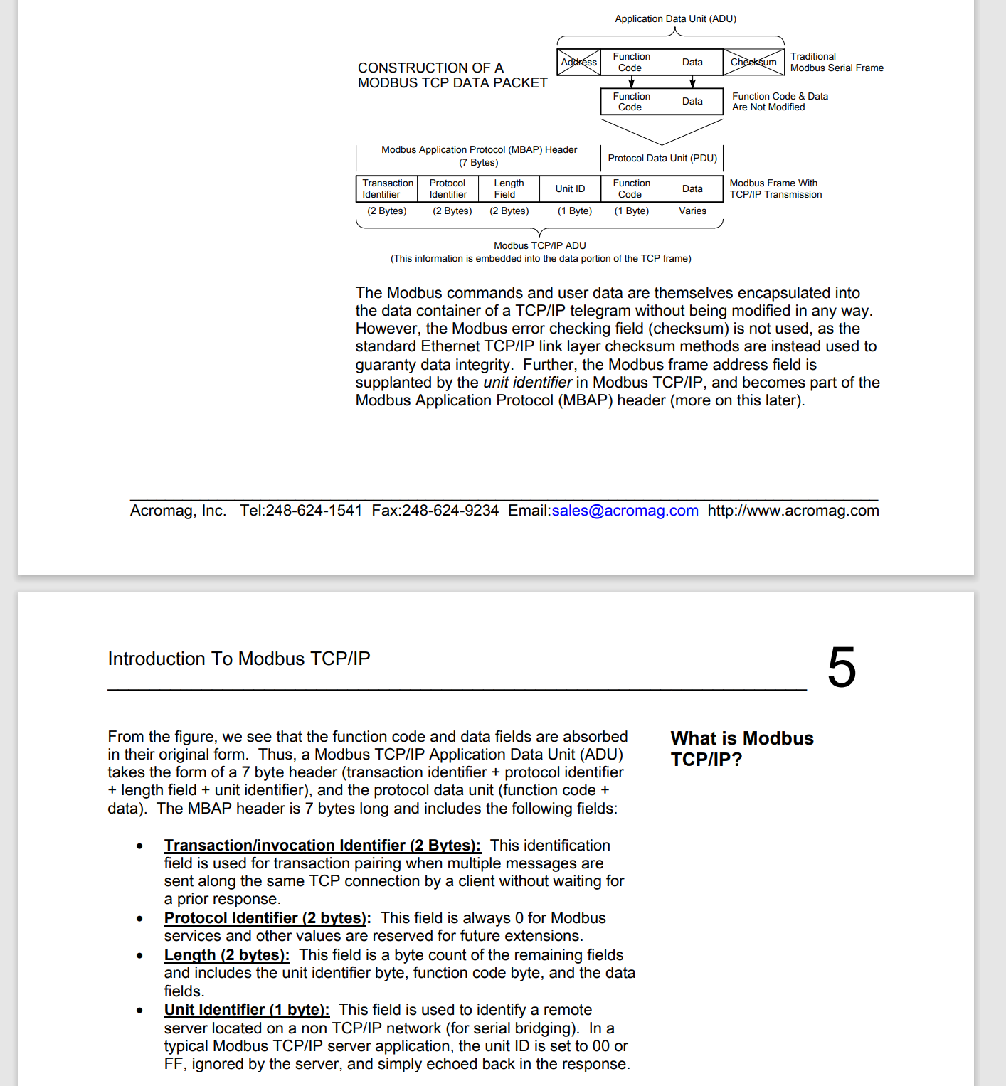

Found a document that describes what getting from scanner:
https://www.prosoft-technology.com/kb/assets/intro_modbustcp.pdf
1414 x 1527 - 271K
1410 x 1466 - 389K
  • RaymanRayman Posts: 16,461
    In the above, first pinged it with function #3 (Read holding regs) and then function #17 (Report Slave ID).
    Had the code debug out all the bytes.
    Was unsure at first why the packet started with a few zeros, but seeing that now in the above document.
    Was thinking that was going to be exactly the same format as RTU, just without CRC.
    Guess it somewhat is, but not exactly...

    This code now appears to be working with Open ModScan's Modbus Scanner in TCP mode.
    Not 100% sure if the data is correct or not yet. The regular Open Modscan interface won't let me open the socket for some reason.
    Might have to look for instructions...
    Open ModScan is happy now with the regular data interface as well as the scanner.
    TCP is pretty picky about #bytes that gets transferred, has to be exact...
