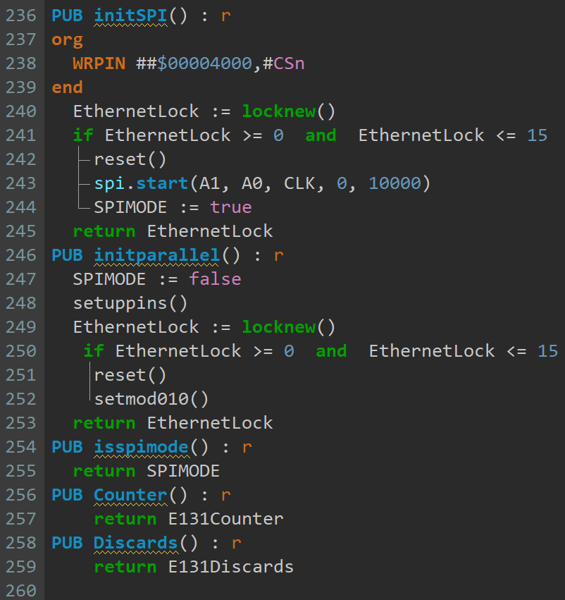

Took Spin Tools for a drive last night. Dadgum is it nice. I figured I would have to update some code, and I do. Everything I have been coding is in Propeller Tool.
I have a retro computing project that is a plug in cartridge to my Color Computer 3 that is P2 based. Everything about it appeared to work, except SIDcog. Haven't tracked down the issue yet, but will work with it as a standalone object to see if I can figure it.

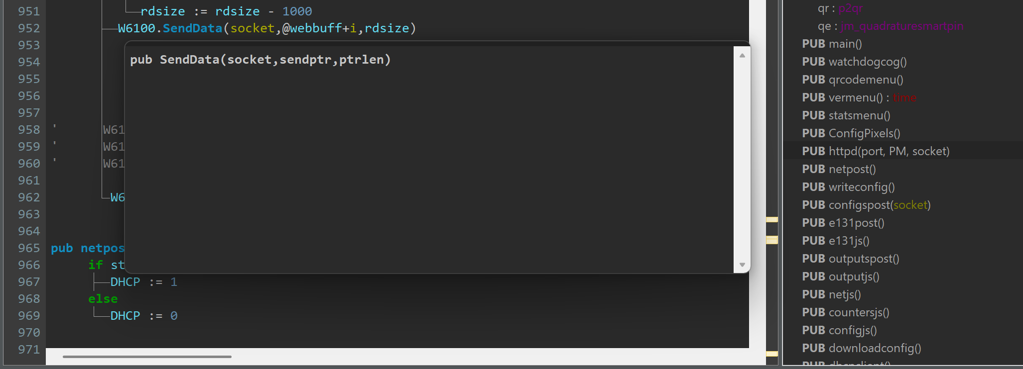

Again, I really like just downloading and running a tool like this. It popping up the comments when you hover over a object and the ability to navigate directly to a method is awesome!

If features like this, I feel spoiled as all get out. (To use a southern expression)
Now I am going to have to add comments to each PUB to explain the more complex methods. Worth it!
PS: Thank you @JonnyMac for already having done that to all your code!

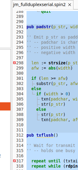

Also, implemented the editor bookmarks, like Propeller Tool.
Click on the line number column to toggle the bookmark then use the Edit -> Go to Bookmark menu items or the CTRL+num shortcut to jump to the bookmarked line.

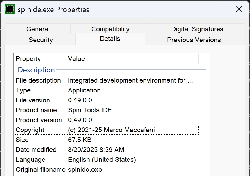

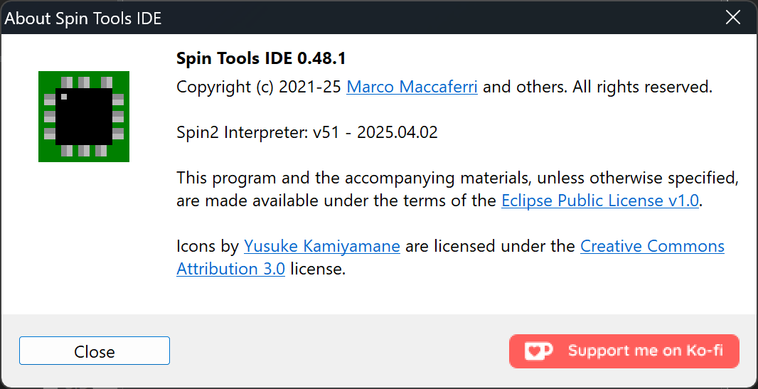

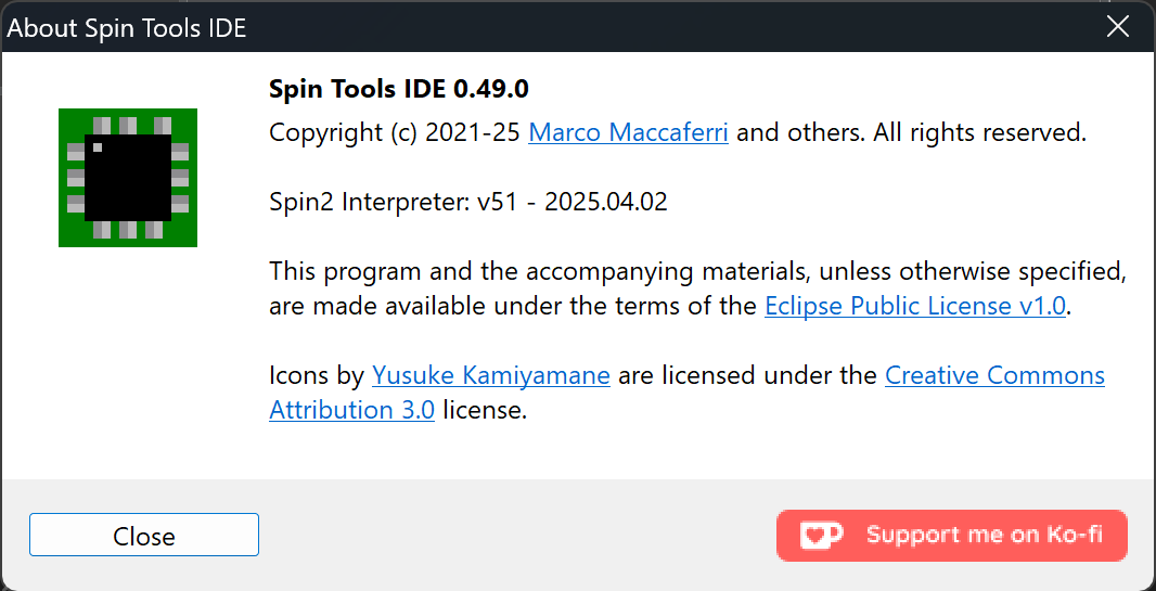

FYI, V0.49.0 still shows 0.48.1 in the about screen on Windows.
However the filename does show it is V0.49.0.0 in the properties of the executable itself.
Just thought you might want to know.
Also thanks for the update!
--Terry
Odd, that's not happening for me.
Do you have a shortcut that's pointing to the older version? (I've done this)
If you have unpacked the new version over an existing, the old spin-tools.jar file is still there and it is loaded before the new one.
Check the lib directory, and delete the old spin-tools-0.48.1.jar file (make sure there is the new spin-tools-0.49.0.jar file).
@macca That did it. I didn't realize the .jar files were named differently. Now I know
Thank you!
