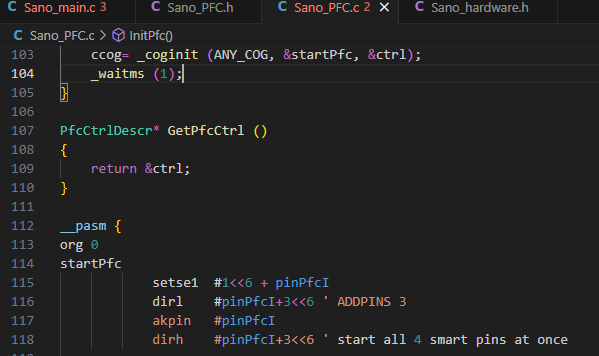

  • BTW, the Spin-style inline ASM feature of FlexProp confuses the systax highlighting:
    I don't know if that can be fixed at all since the code is detected as C and not Spin.
    You are right since it's C i can't do anything since the highlighter for spin2 is enabled by the .spin2 file type by VSCode.
    If this is a spin2 file compiled by flexspin and this syntax is used I might be able to highlight this syntax correctly.
    My goal for the Spin2 extension is to be the first class highlighter for full PNut/PNut_TS syntax
    • a secondary goal to do much later is add flexspin support for spin2 only.
    meanwhile, until the seconday goal is achieved i've added minimal flexspin support which is enabled by a setting.
