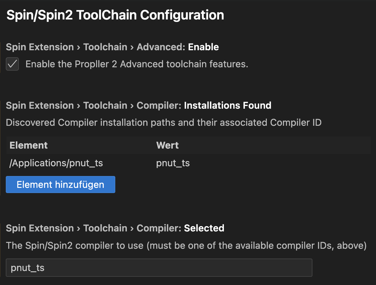

  • wummiwummi Posts: 106
    Hi Stephen,
    I working with MacOS 15 and installed pnut_ts.
    I can use pnut_ts in the terminal and ist works.
    I want to start the compiler in VSC, I install the spinExtension Version 2.4.2 and generate task.json from Doku: TASKS-User-macOS.md
    When ist i type command/shift/B and compileTopP2 I get the Error: command 'spinExtension.getCompArguments' not found
    Where can i define "getCompArguments" and what are the Arguments?

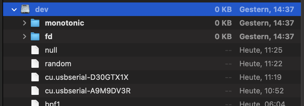

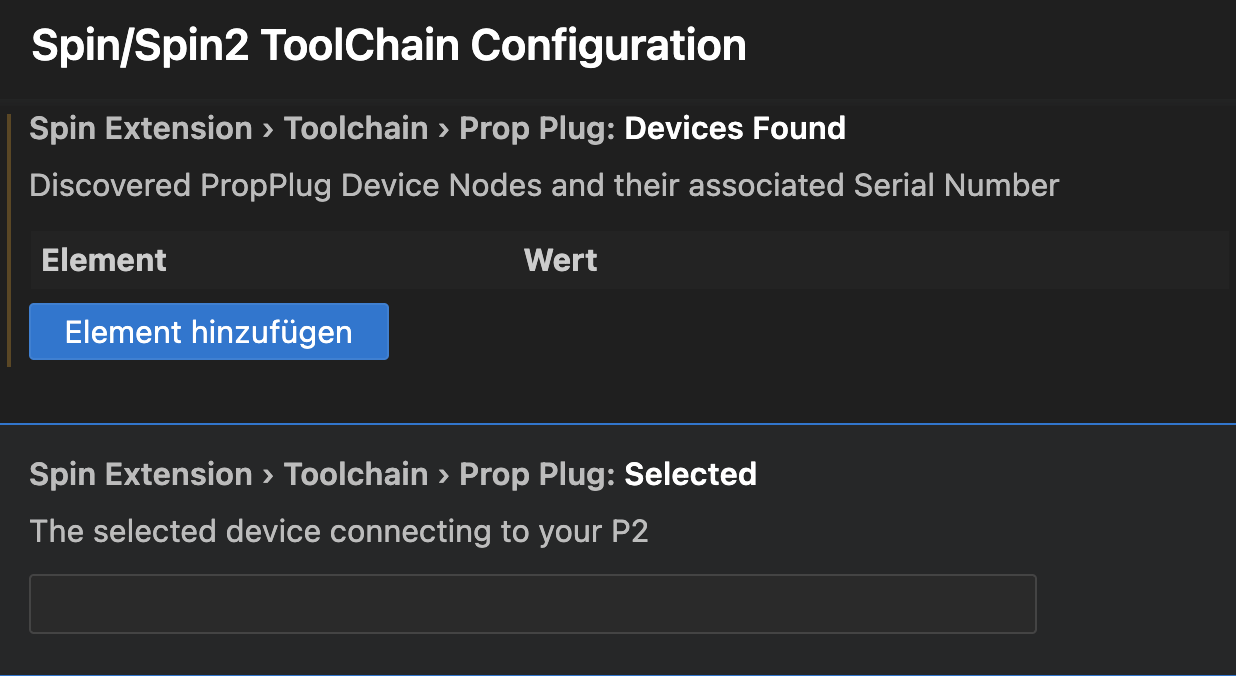

    Thanks Stephen, VSC now find the pnut_ts and compiles my Projects.
    But VSC do not find the PropPlugs and can't download the .bin files under MacOS 15.
    Is there a build in P2-Loader or need I an external Programm?

    The Pin2 Extension on MacOS 15 don't find any PropPlug, so I can't download the binary's to the P2.
    The PropPlugs are ok and SpinTools can find them and download can be done under MacOS 15.
    What can I do to fix this, or is an external P2Loader necessary?
    I have to check, you probably already did this... ;-) Did you enable the new toolchain support?
    What symptoms are you seeing that the prop plug is not being found?
    When you have a .spin2 file open in the current editor window, do you see the new statusbar controls?
    Hi Stephen,
    I do enable Advanced toolchain features.
    But no Prop Plug: Devices Found
    Enter the associated Serial Number manualy don't work.
    Toolbar:
    The usb devices in dev:
    Good morning Stephen,
    i habe a look at usb.serial.ts and found that you only accept an FTDI FT231X.
    I use most FT232R USB UART: Produkt-ID: 6001.
    But when I plug in an FT231X USB UART: Produkt-ID: 6015, it is also not found.
    In usb.serial.ts Line 78: const ports = await SerialPort.list(); you get a list of ports.
    Can you log the ports, and we can see where the problems are?
    As a former (retired) HP employee, we had a term, "Excellent Question," which was asked in meetings where we already had an answer. ;-)
    This is one of those. Yes I can do two things. There is a newer version of the underlying UsbSerial package I'm using. I can upgrade to that hoping there is better device support, and secondly i already have a built-in report you can activate showing which devices are being seen. I will update that report to show PID/VID if it doesn't already, so it can also help us diagnose.
    Go to settings keybindings, look for how to activate "Generate USB Findings Report," and see if that tells you anything currently.
    I'll release an update with the newer UsbSerial as soon as I prove it still works in my test environment.
