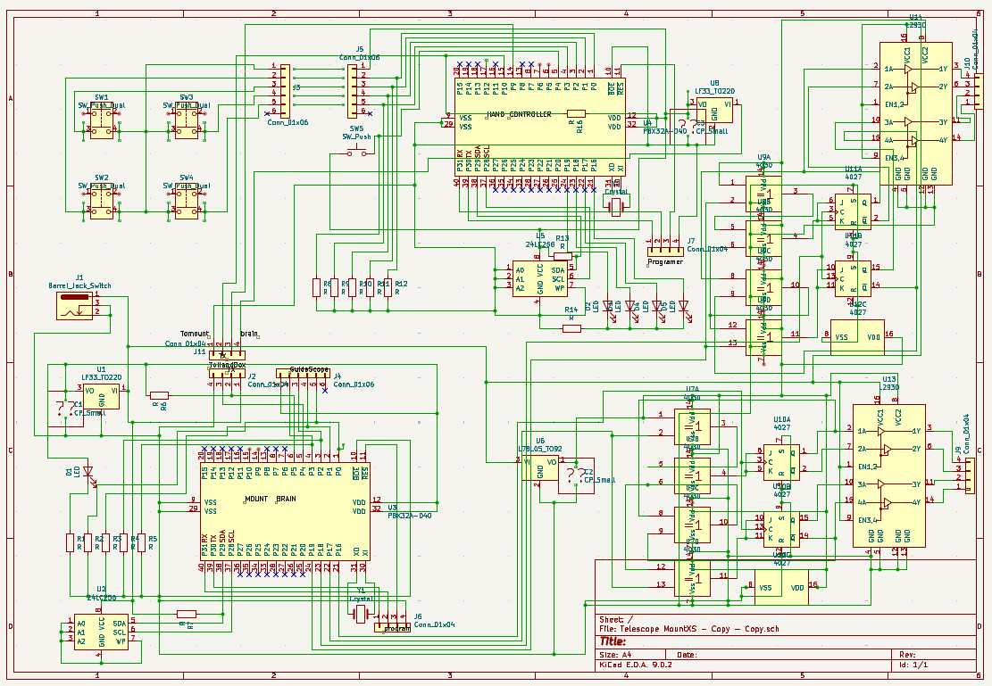

  • bbrienbbrien Posts: 603
    edited 2025-07-18 23:12
    The devices have all of the required capacitors.
    I have already downloaded the two programs that you have modified.
    I have already loaded the devices with the new programs but am having problems with the simulator(red package), may have damaged the processor, waiting for new one. am setting up the big box in the meantime. Will report in a few days. " Thank you"

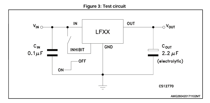

  • Hi,
    so you now have sent a choice of 3 (!!!) propeller boards, and we can now guess if the last picture shows the board, that you don't use any more for handbox or motor driver.
    Your schematic does obviously not match the master board, which shows switching regulator modules!
    **It is not us, who need accurate and reliable information about your setup. It is you who wants to go forward with this project. It is you, who wants help and therefore needs to make sure that we have consistent, full information. **
    And no, if you had a look into the datasheets, then you would have found, that you need condensers on both sides of the linear regulators. These must be attached with very short leads.
    From: https://www.st.com/resource/en/datasheet/lfxx.pdf
    The L293 also needs condensers and probably heatsinks:
    "10 Power Supply Recommendations
    VCC1 is 5 V ± 0.5 V and VCC2 can be same supply as VCC1 or a higher voltage supply with peak voltage up to 36
    V. Bypass capacitors of 0.1 uF or greater should be used at VCC1 and VCC2 pins. There are no power up or
    power down supply sequence order requirements.
    Properly heatsinking the L293 when driving high-current is critical to design. The Rthj-amp of the L293 can be
    reduced by soldering the GND pins to a suitable copper area of the printed circuit board or to an external heat
    sink."
    From:
    https://www.ti.com/lit/ds/symlink/l293.pdf
    And for each chip on the propeller boards:

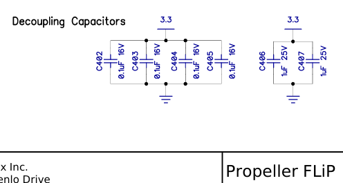

    From: https://www.parallax.com/package/propeller-flip-module-downloads/
    I would add a protection diode against reverse voltage at the power input.
    Also I would add an additional LARGE capacitor nearby the L293, because you do not want to disturb the power supply by each step.
    You have lost many months in your project, because you did not take power supply seriously before. And it is most alarming, that you might have damaged the P1. In my experience these are quite robust. So if the P1 is damaged, then something is wrong with you hardware!!!!!

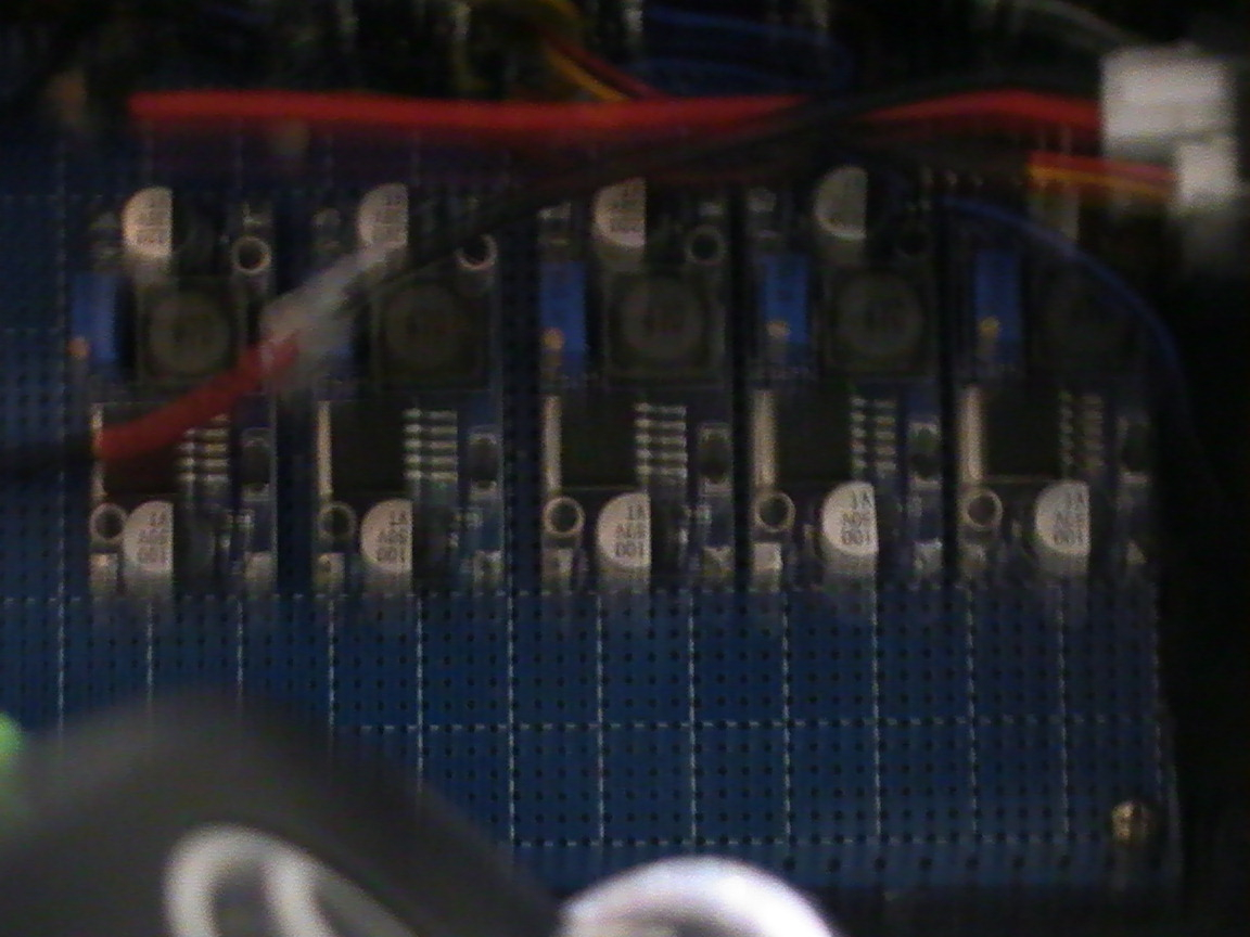

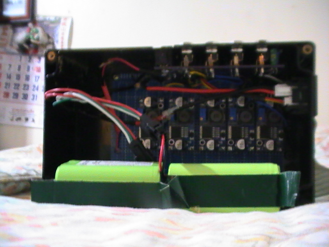

  • these are the first photos and programs. The photos are of my primary power supply, it can deliver 6,9,12volts at up to 3 amps. my steppers only draw about 200ma at full drive and will not move if no power is delivered. the gearbox will not allow any back movement even if you try to move the scope by hand.am searching for shorted terminals on the guider switches ,will continue later.
    1152 x 864 - 213K
    1152 x 864 - 186K
  • Against better knowledge I did have a look into Mount BS19B. It convinces me that any work is in vain before the checklist is done properly. You absolutely need a schematic, which is trustworthy and complete. And you will then need to have terminal program connected to the mount. But to really test the mount device you first need a proven hand box sender. So the order of steps in the checklist makes a lot of sense!
    But I can assure you, that this program indeed has non-zero speed on both motors, as you could have found out yourself. (If this project was mine, I would connect two potentiometers for these two basic AUTO-RATES, perhaps we you can add this AFTER it works.)
    Do not do any changements to these both programs, or we will loose my proving of #121!!!

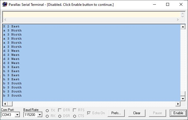

    "got the GEAR simulator working also for the sender and tested with NORTH and SOUTH buttons, which both send the correct code. So these two files here in this post do compile and should work together regarding protocol."
    What on earth are you doing?

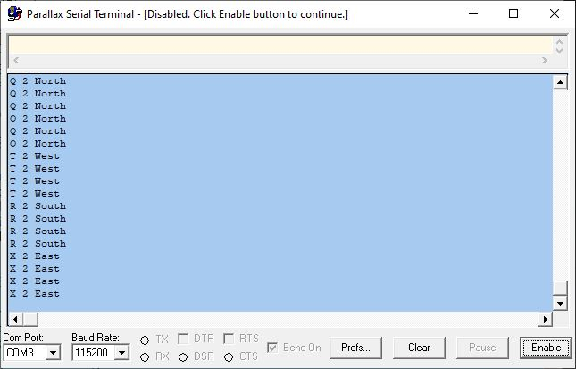

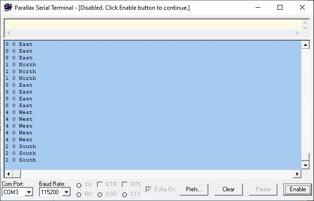

  • l
    Loaded handboxDH9A1A into hand controller and this is what I get.

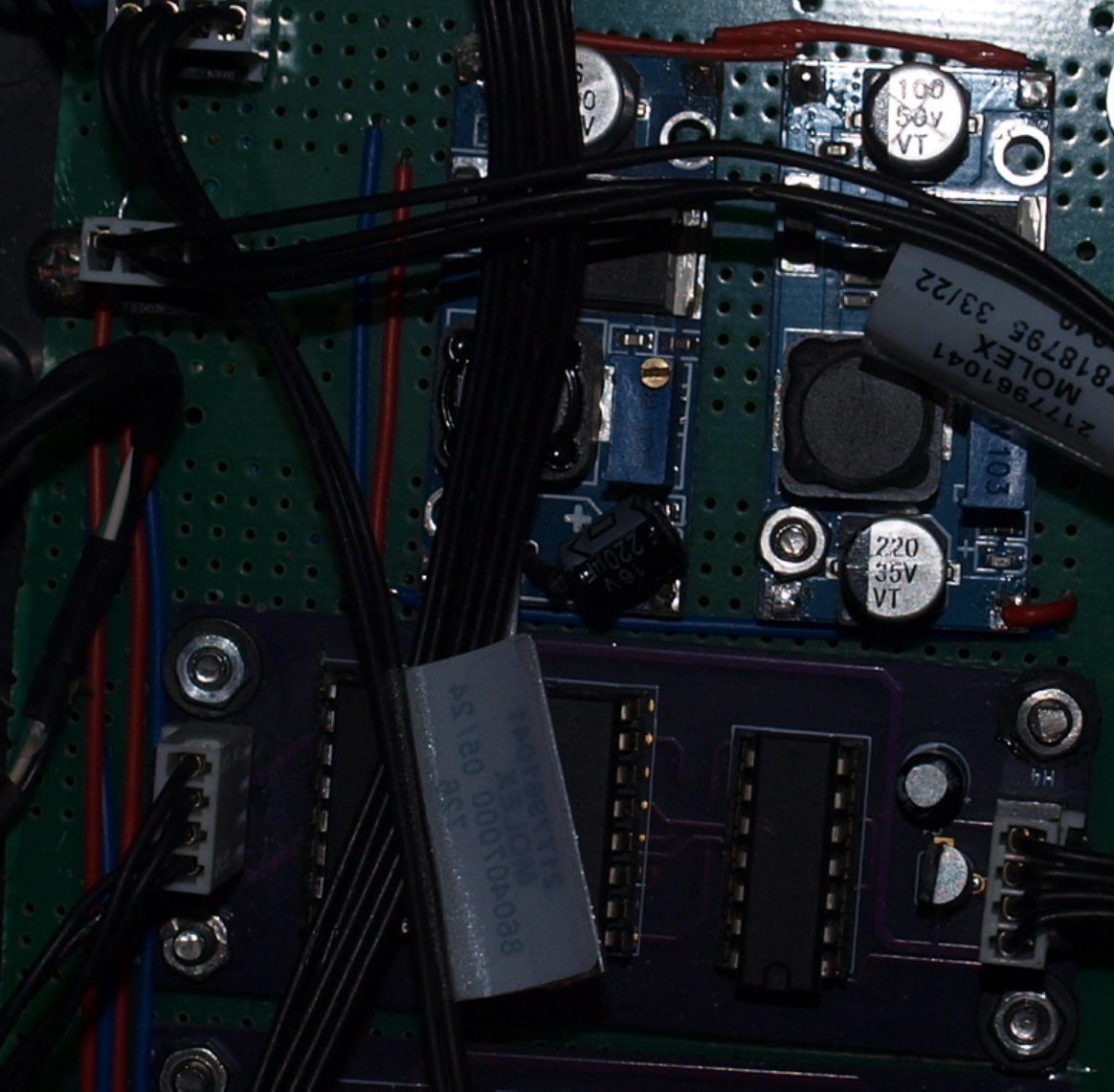

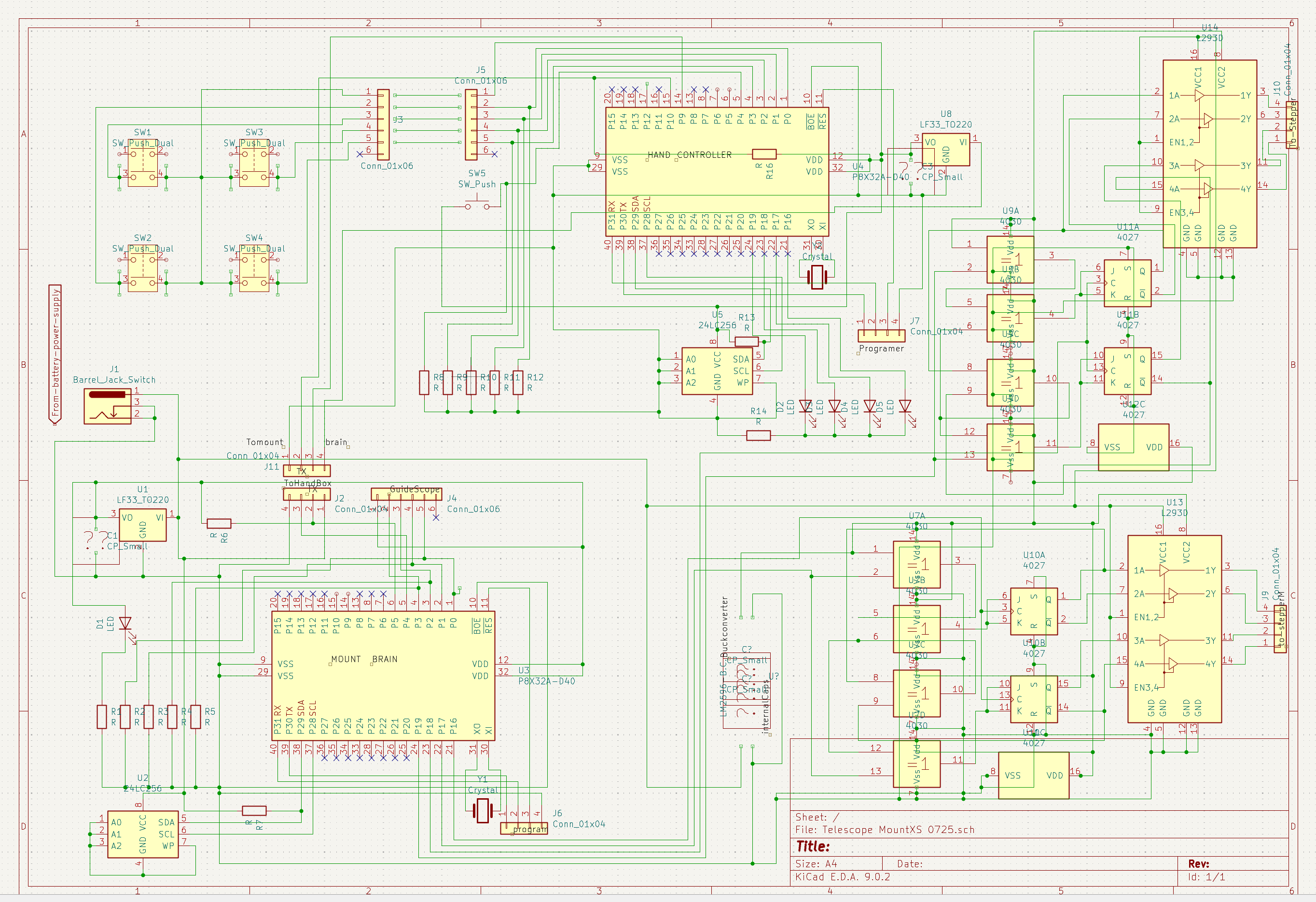

  • Christof Eb.Christof Eb. Posts: 1,472
    edited 2025-07-25 07:49
    Hm, what is this supposed to be?
    Your photo shows two buck converters and also it probably shows a 78L05 (or some other TO92 device) on each of the driver modules?

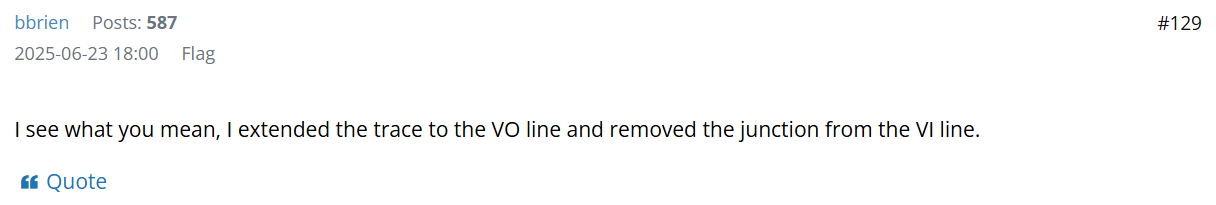

    The eeprom is supplied still or again via high voltage. We had discussed this on 20250623 a month now. #127 https://forums.parallax.com/discussion/173757/dual-stepper-motors#latest
    Going in circles. What a waste of time.
    It is necessary to give the schematic file name version numbers!
    Please do not send any more schematic until it completely fulfils:
    A0) Add all condensers nearby all chips and regulators and a protection diode against voltage reversal to the setup.
    A1) Draw a schematic, that truly and completely reflects your setup including power supplies.

    YOU HAVE TO CHECK YOUR HARDWARE!!!! The only way to kill the P1 is either over-voltage (measure it!!!!) at any pin or current too high at a single pin or the sum of current too high. So please check all connections and PIN numbers. Which pin is an output and which is an input? The serial output must be connected to an input.
    According to your schematics you have had the eeprom connected to ???12V???
    DO NOT INSERT NEW CHIPS UNTIL YOU HAVE CHECKED EVERYTHING VERY CAREFULLY AND HAVE DRAWN FULLY TRUE SCHEMATICS.

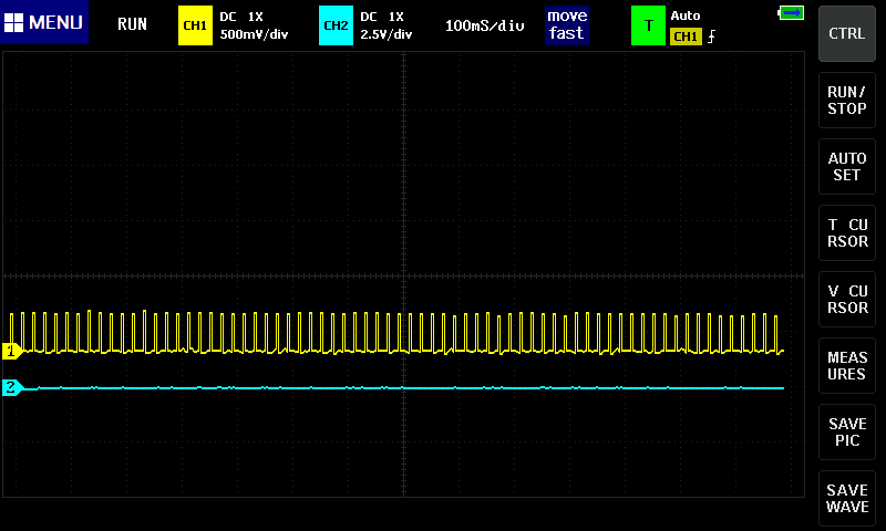

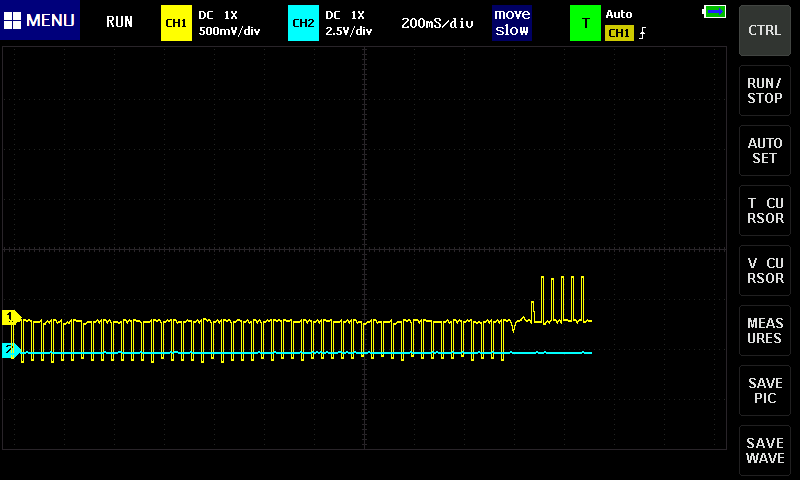

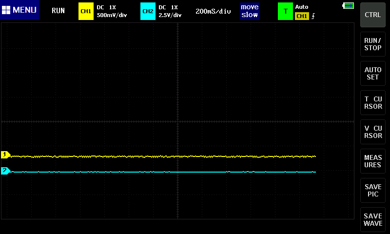

  • Perhaps I should tell something to explain, why I think power supply is so very important.
    I once had a project with an esp32 module, which kept crashing. And I didn't understand and could not find my bug.
    Then I discovered with an oscilloscope that the 3V3 power rail was oscillating up to 9V! I was very astonished, that the esp32 survived.
  • According to the file that I just sent, the 3.3v power rail has no oscillations at all , clean and filtered
    bmp
    781K
    5.bmp 781.3K
  • My second topic on serial , in the case of the hand box the tx pin is pulled up to 3.3v and the rx pin is pulled to ground level. but what about the mount system, should they also be pulled to their prospective levels.?
    Your schematic tells a different story?
    What resistors do you use?
    Often pull-up or pull down is done only on the receiver side.
  • JonnyMacJonnyMac Posts: 9,545
    If you're using True mode serial, this is a bad idea. In True mode, the idle state of TX and RX is high.
  • 10K ohm resistors.
