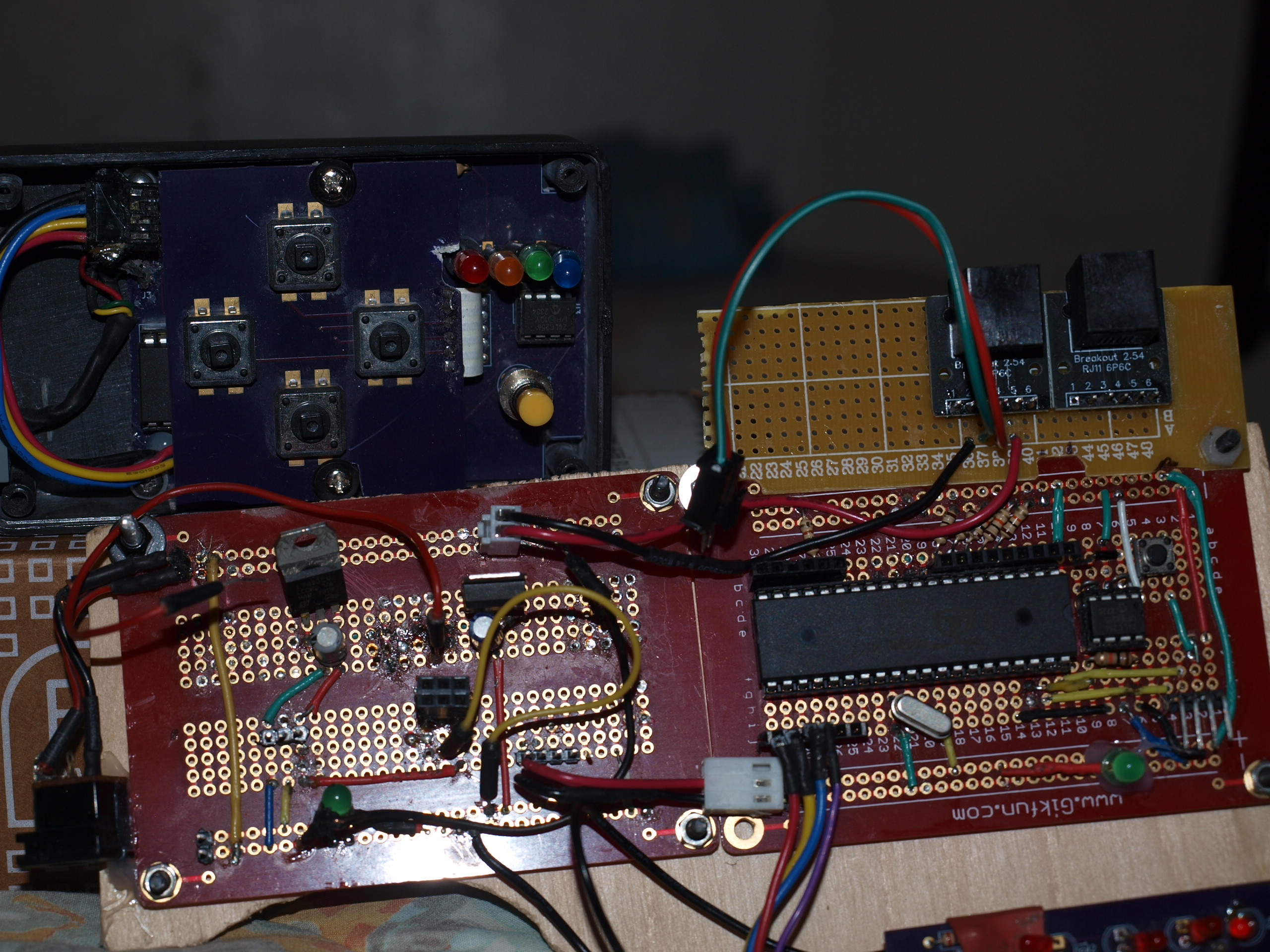

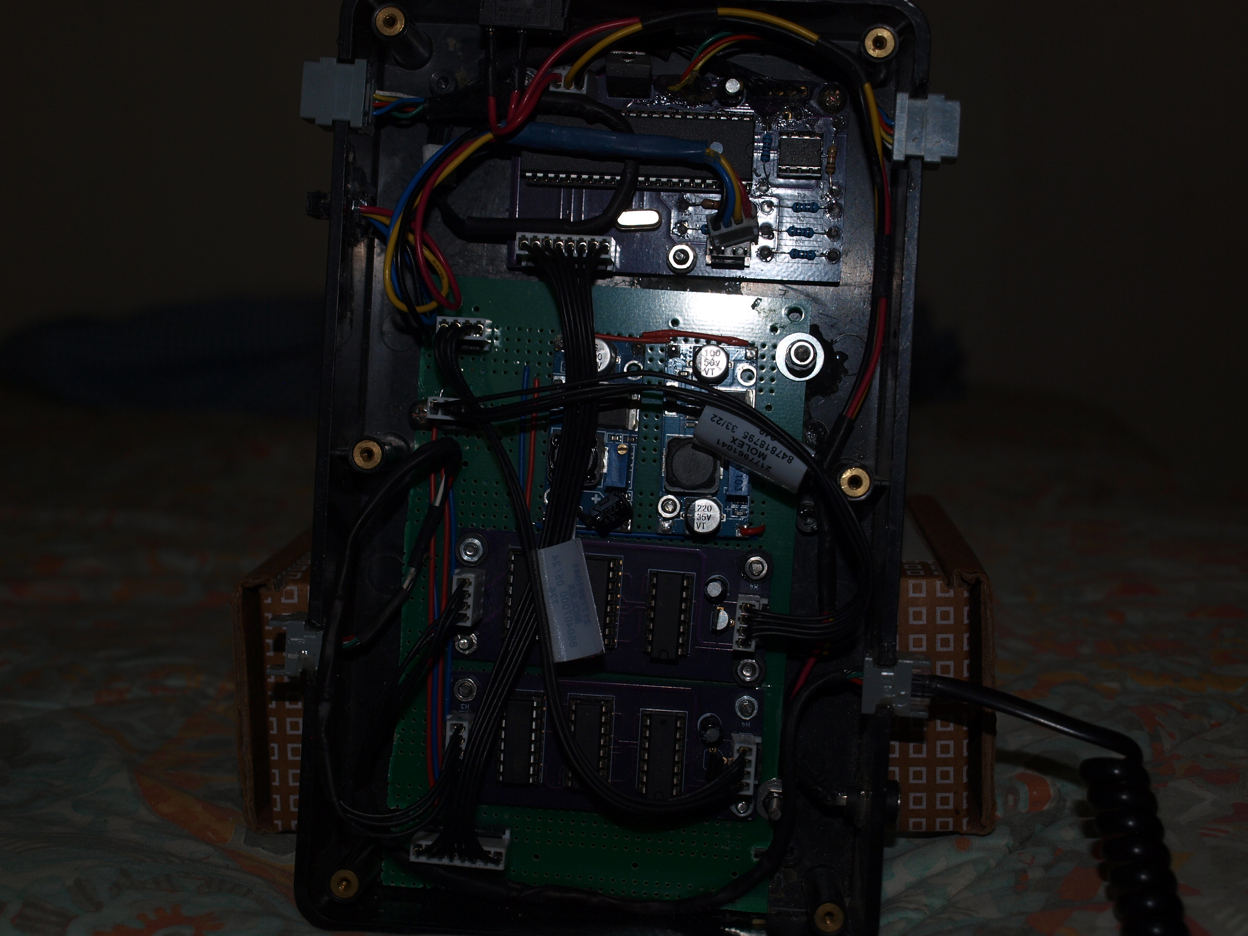

  • these are the first photos and programs. The photos are of my primary power supply, it can deliver 6,9,12volts at up to 3 amps. my steppers only draw about 200ma at full drive and will not move if no power is delivered. the gearbox will not allow any back movement even if you try to move the scope by hand.am searching for shorted terminals on the guider switches ,will continue later.
    1152 x 864 - 213K
    1152 x 864 - 186K
  • Against better knowledge I did have a look into Mount BS19B. It convinces me that any work is in vain before the checklist is done properly. You absolutely need a schematic, which is trustworthy and complete. And you will then need to have terminal program connected to the mount. But to really test the mount device you first need a proven hand box sender. So the order of steps in the checklist makes a lot of sense!
    But I can assure you, that this program indeed has non-zero speed on both motors, as you could have found out yourself. (If this project was mine, I would connect two potentiometers for these two basic AUTO-RATES, perhaps we you can add this AFTER it works.)
    Do not do any changements to these both programs, or we will loose my proving of #121!!!
    "got the GEAR simulator working also for the sender and tested with NORTH and SOUTH buttons, which both send the correct code. So these two files here in this post do compile and should work together regarding protocol."
    What on earth are you doing?
    T_Mount BS20.spin is totally reformatted against the proven T_Mount B19.spin and does not compile any more. :#:(:s:'(

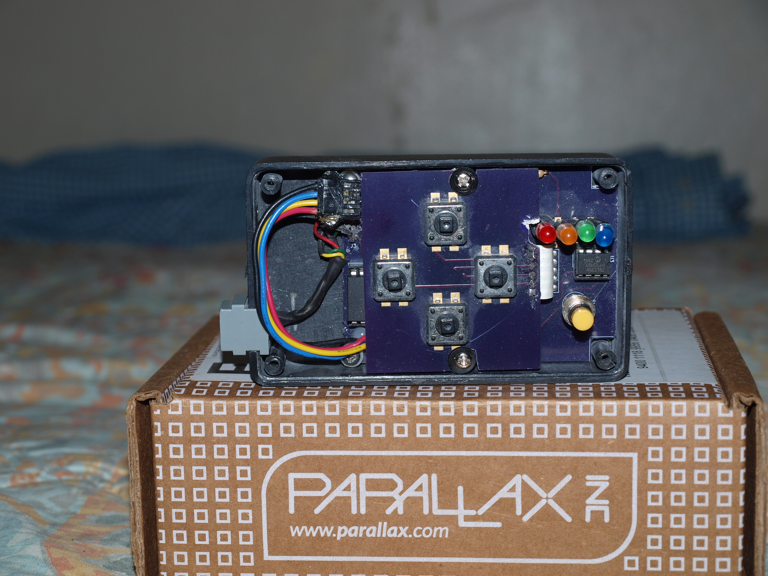

  • l
    Loaded handboxDH9A1A into hand controller and this is what I get.

  • Christof Eb.Christof Eb. Posts: 1,514
    edited 2025-07-25 07:49
    Hm, what is this supposed to be?
    Your photo shows two buck converters and also it probably shows a 78L05 (or some other TO92 device) on each of the driver modules?
    The eeprom is supplied still or again via high voltage. We had discussed this on 20250623 a month now. #127 https://forums.parallax.com/discussion/173757/dual-stepper-motors#latest
    Going in circles. What a waste of time.

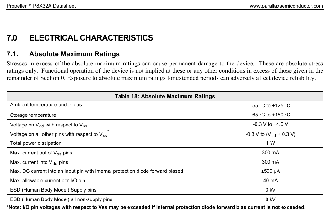

    I am at a total loss, how we could help you. You certainly did NOT follow my step by step list.
    I have never killed a P1, they are quite robust.
    See here: https://www.parallax.com/package/p8x32a-propeller-datasheet/
    YOU HAVE TO CHECK YOUR HARDWARE!!!! The only way to kill the P1 is either over-voltage (measure it!!!!) at any pin or current too high at a single pin or the sum of current too high. So please check all connections and PIN numbers. Which pin is an output and which is an input? The serial output must be connected to an input.
    According to your schematics you have had the eeprom connected to ???12V???
    DO NOT INSERT NEW CHIPS UNTIL YOU HAVE CHECKED EVERYTHING VERY CAREFULLY AND HAVE DRAWN FULLY TRUE SCHEMATICS.

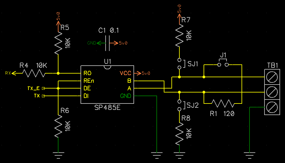

  • That is what stymies me the most is the circuit diagrams between the LX50, the STAR Finder 10, and the Orion EQ2 are virtually the same except with the output section , in the LX50 the outputs from the processor go to the L298 board with inverters on a2 and a4 inputs and b2 and b4 inputs with the enables tied to the respective pulse lines for motors 1 and 2. In the 10 inch Star Finder which has one stepper and 1 DC geared clock motor( 5v at 150ma). there is 1/2 L293 driving the DC clock motor and a MC3479 stepper driver(RamseySMD1) running the stepper. these two units work perfectly and are housed in Thailand on my Property.

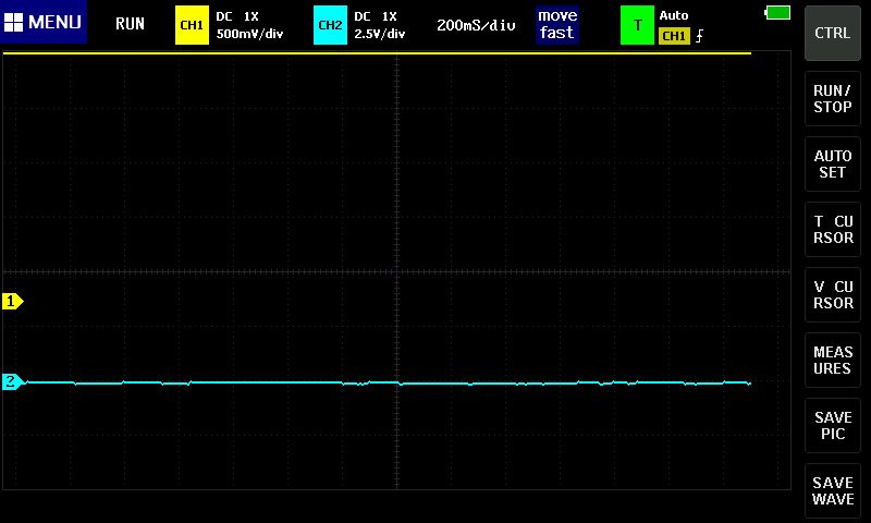

  • Perhaps I should tell something to explain, why I think power supply is so very important.
    I once had a project with an esp32 module, which kept crashing. And I didn't understand and could not find my bug.
    Then I discovered with an oscilloscope that the 3V3 power rail was oscillating up to 9V! I was very astonished, that the esp32 survived.
  • According to the file that I just sent, the 3.3v power rail has no oscillations at all , clean and filtered

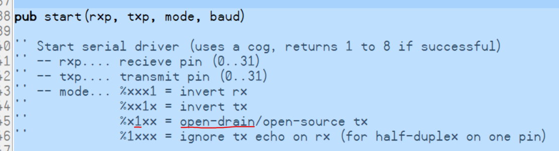

  • My second topic on serial , in the case of the hand box the tx pin is pulled up to 3.3v and the rx pin is pulled to ground level. but what about the mount system, should they also be pulled to their prospective levels.?
    Your schematic tells a different story?
    What resistors do you use?
    Often pull-up or pull down is done only on the receiver side.
  • the rx pin is pulled to ground level
    If you're using True mode serial, this is a bad idea. In True mode, the idle state of TX and RX is high.
  • 10K ohm resistors.
