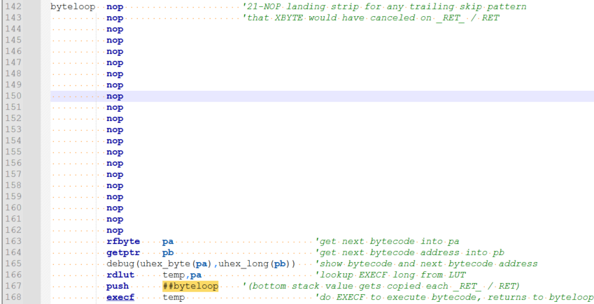

    beautiful example of all the XBYTE bits, which I must admit I'm still a bit stymied by on my own implementation for Scheme (Lisp). my bytecodes execute then run right off the end, or not,... or something. as I was trimming it all down to the most essential bits to ask on this forum, I learned a bunch more. but, then I haven't asked here yet as I've also learned there is a batch more I need to learn about Scheme... which I've been doing on the desktop for the moment. Getting closer, though!

    At the moment trace and untrace is not supported with the fast XBYTE machine.
    As wcall and exit are done in the XBYTE machine, it would be necessary to insert low level tracing there, which would slow down everything very much.
    At the beginning of my efforts I have had some tracing for the XBYTE mechanism as Chip has documented. There are still some traces of this in the XBYTE assembler code. When activated, they actually bypass the hardware XBYTE mechanism and they do need the DEBUG mechanism at the serial line.
    This part is not actually used.
    It would be possible to redefine ":" that it compiles some "dotrace" into the beginning of every compound word. I have that in my homegrown Forth for ESP32 but actually don't use it much. It is difficult to use trace and not be swamped by data.....
